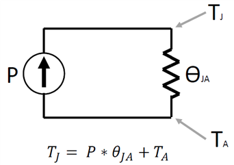

14 Watts is a lot of dissipation for a regulator. But that’s ok, we’ll just open the LT1529CT-5 datasheet and look for the maximum power dissipation spec … wait a minute … they don’t give one! Why not? Because we should be more concerned with the internal junction temperature of the regulator since it depends on the ambient temperature we operate the device at. The amount of power that can be dissipated will vary with the ambient temperature, but the maximum junction temperature cannot change. This is where the regulator design begins to differ from choosing the correct wattage resistor. We’ll need to create a thermal circuit to analyze our thermal requirements.
Here is a basic thermal circuit. We can analyze it the same as an electrical circuit where power is current, temperature is voltage, and thermal resistance is electrical resistance.
Fig 1: Basic Thermal Circuit
TJ is the junction temperature,
TA is the ambient temperature,
P is the power being dissipated by the regulator,
and ƟJA is the junction to ambient thermal resistance.
Let’s do a quick calculation to determine the temperature my regulator would reach by operating it in an ambient temperature of 45 degrees Celsius (I’m in California)
That’s just a tad hot, considering the maximum junction temperature for the device is 125°C (sarcasm). Note, the thermal resistance value comes from the device datasheet. So we have a few options:

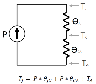

That's not a typo! Two different thermal resistances depending upon how you mount the heat sink. Look at the heat sink picture and imagine it is laying flat like in the picture. Remember, "heat rises", so the heat being transferred to the air around the heat sink goes directly from the heat sink into the air. If the heat sink is mounted vertically any heat leaving the heat sink must rise upward through the fins, reducing the effectiveness of the heat sink. So let's modify our thermal circuit for a horizontally mounted heat sink.
Fig 3: Thermal Circuit with Heat Sink
TC is the case temperature,
ƟCA is the case to ambient thermal resistance,
and ƟJC is the junction to case thermal resistance.
Note the difference, before we had a single thermal resistance: the junction to ambient. The junction to ambient was composed of two parts although it was hidden from us. They were: The junction to case and the case to ambient thermal resistances, just like in the circuit above. We have no control over the junction to case thermal resistance. It is part of the regulator design. However, we can change the case to ambient thermal resistance by adding a heat sink to the device. So, let's calculate the new junction temperature:
Note, ƟCA comes from the regulator datasheet, usually in a thermal considerations section. We've managed to reduce the junction temperature from over 700°C to 175°C, but that is still too hot for this regulator. In fact, to do a complete thermal analysis the insulator and thermal compound thermal resistances should also be included. This arises because you will need a thin insulator between the regulator and the heat sink. I could drop the ambient requirements to -10°C, that would meet the 125°C junction temperature maximum, but I don't think that's a wise decision.
It's around this point that it becomes a good idea to sit back and think about what this analysis means. If I constantly run this regulator it will overheat and shutoff. Fortunately this regulator has a thermal shutoff, but not all of them do. I'm not going to be running this regulator continuously. In fact, it will likely only run for a minute or two before shutting off. I ran a test where I drove the regulator for about 3 minutes with the heat sink attached and it did not reach thermal shutdown, which means I will be testing this regulator in the watering system. I should point out that when I tried to test this regulator without the heat sink it entered thermal shutdown immediately. It's kind of nice when calculations work out eh?
