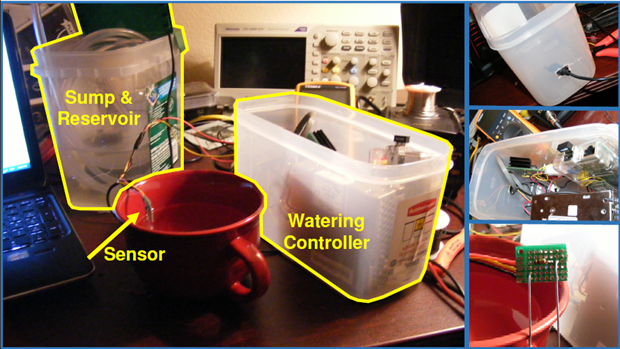

If you've been following along, you know that I originally wanted to use a two threshold system to activate and run my watering system. After completing my initial design, the RPiSoC boards became available to the Forget Me Not Challengers. The RPiSoc system has an analog to digital converter, something which the RPi lacks. At that point I decided to create a soil sensor that could read the soil moisture level directly and offload the rest of the complexity to software. That is, all thresholds and any other implementation would be completely in software. I spent some of my time designing a soil sensor based on a constant current source, but I lack the parts to build the sensor at this moment. So, in order to move forward I have decided to revert to the two threshold system from my original design. That soil sensor (Funduino) that I ordered from DX.com has still not showed up. It's been almost three months now. I've been in contact with them; the experience was terrible. Therefore, I used a simple resistive divider I mentioned in this post. The non-linear response won't matter for the two threshold system.
The System
Having said all that, I have a watering system that works. I just need to tweak the threshold values over the next few days. Figure 1 shows a photo collage of the Watering System.
Figure 1: [Left] Complete watering system in action (laboratory action) Sump & Reservoir, Sensor, and Watering Controller are shown. [Upper Right] Photo showing the preparation of the watering controller enclosure (Rubbermaid dish - not all of us have 3D printers image). [Middle Right] Watering Controller photo showing the internal circuitry. [Bottom Right] Soil Sensor made from a resistive divider.
The Sump & Reservoir are simply a container for water and a sump pump. The sump pump delivers water through the tubing when activated. The Water Controller consists of a custom board, Raspberry Pi B, and a TDK LAMBDA  LS5012 AC to DC power supply. OpenHAB is running on the Raspberry Pi with the EnOcean Pi installed.

I've tested this system in my "lab" using a cup of water (100% moisture) and in open air (close to 0% moisture). I'll be installing the unit on my deck in the next few days. Should be interesting to see how it behaves.
The last thing I wanted to mention was a quirk I noticed when I reboot my Raspberry Pi. The pump turns on, because gpio 4 floats. Adding a pulldown fixed the problem.
