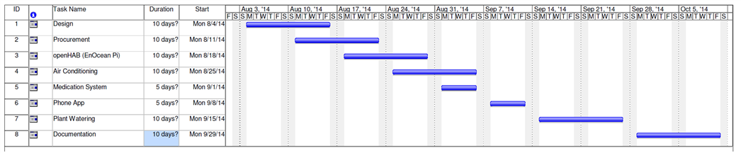

    I began this project by revealing my project to the other challengers and anyone willing to read my blogposts. I wanted an open project so that everyone could benefit from what I was learning. I'm grateful to the other challengers who revealed many parts of their own projects as well, because I was a direct beneficiary. After this I decided to, as with all engineering projects, construct a Gantt Chart or timeline for my project (reproduced in Figure 1).
    Figure 1: PAM project timeline.
    In hindsight, my plan was susceptible to procurement delays. I planned for a procurement time of approximately 2 weeks, but it was more like a month. Also, I ended up splitting my procurement into two steps. Why, dare you ask? I moved to California from Eastern Canada in June 2013, and I had no means to work on projects at home. I used a good portion of the $500 budget to make a home lab. The second procurement was more of a "oh, I forgot that, better order one" order. Unfortunately I placed it too late for it to be of use in this design challenge. C'est la vie, oui?

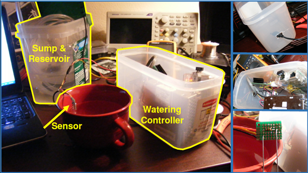

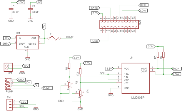

    The plant watering portion required parts, so I designed the entire system and during that process my initial parts arrived. For the pump controller I did a detailed analysis of heat transfer from a linear regulator. I intended for that post to be a tutorial for beginners trying to understand thermal considerations of regulator design. Figure 2 shows the schematic for the plant watering system and Figure 3 shows the constructed system. Note, there is an added 10k pull-down on the PUMP signal. This ensures the pump is not active during reboots of the Raspberry Pi.
    Figure 2: Plant watering schematic.
    Figure 3: Constructed, functioning plant watering system.
    The constructed system uses a soil sensor that was created using a simple resistive divider, but I spent an entire blogpost showing a step-by-step linearization of the typical soil sensor used by hobbyists. I used a resistive divider because I didn't have the parts to create the sensor yet. The resistive divider is non-linear, and the typical hobbyist sensor has a very poor dynamic range (less than 1). I designed a sensor with a dynamic range equal to the ratio of the resistance of dry soil to wet soil. This was 4 in my case. The system is currently installed on my patio, and until I manage to find the appropriate watering thresholds it is over-watering my basil.

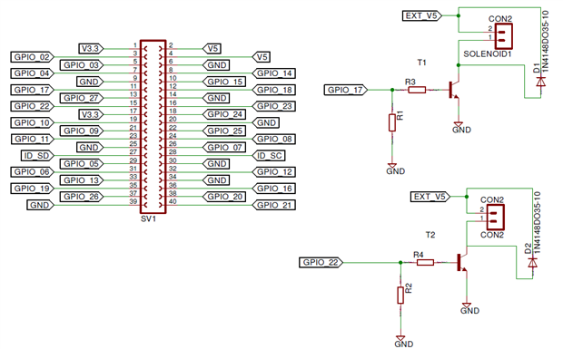

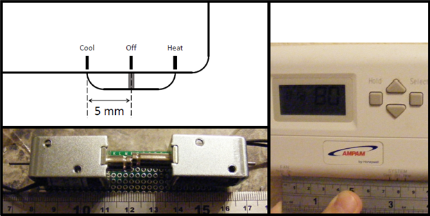

    Finally, I designed my air conditioning switcher, but can not construct it until my parts arrive. Figure 4 shows the schematic for the solenoid drivers. I use a double solenoid system to move the switch on my air conditioning interface. Note, I live in an apartment and cannot modify the unit. Magnetic contact switches on all the windows and patio door can be viewed from the OpenHAB interface. This allows the user, at a glance, to know whether or not they can turn the air conditioner on.
    Figure 4: Solenoid drivers for air conditioning switch.
    Figure 5 shows the board I made to hold the solenoids. The travel of the two plungers can be modified by sliding one solenoid through two slots cut on the back of the board. I tested the solenoid switcher using a power supply and it works, but I need to interface it to a Raspberry Pi and use the GPIO to control the solenoid drivers.
    Figure 5: Solenoid based AC switcher.
