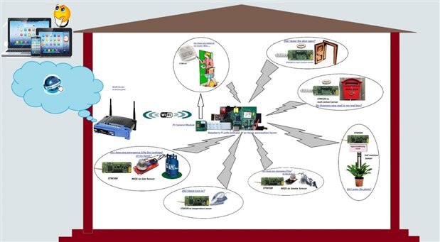

Using RaspberryPi B+ and EnOceanPi & Sensors Kit as main components and Tektronix TBS1202B EDU DSO as main hardware debugging TMI, I will develop IoT Based Home Automation solution for answer following questions when you are away from your home...
1. Do I have any visitor at my home? Who...?
2. Do I have new mail in my mail box?
3. Do I have any emergency at my Home? Like, is there fire or gas Leakage at my home?
4. Did I leave the door unlocked?
5. Did I water the plants?
6. Did I leave the iron on?
7,6,9....Surprise Coming Soon....!!!!
Here, Raspberry-Pi B+ will be work as Home automation Server and it is directly connected to EnOcean-Pi transceiver module to communicate with different EnOcean wireless sensors nodes used in this application.
OpenHAB and Eclipse SmartHome software will be used for server design and configuration tool.
Also Iwill use my 3D printer to design cool enclosures for different parts of this entire home automation system.
USB Wi-Fi dongle with Raspberry Pi B+ will be used for connect this home automation server to internet via WLAN router as access point so all sensor node data will be available to any Smart Phone/PC/tablets with web interface as shown in diagram below.
Overview of each Sensor node and the way it answers home automation related questions selected for this application is as follows...........

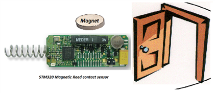

Yeh, you will like to know, do you have any new mail in your mail box? when you are away from your home. The solution is STM320 Magnetic contact sensor in your mail box. STM230 will be used for detect opening of Mail box letter inlet using its magnetic reed contact sensor, so whenever there is new mail in your mail box STM320 sends message packet to Raspberry Pi via Enocean-Pi transceiver module and you will get this message on your Smart Phone/PC/tablets via internet. Here, all aspects of mechanical mounting of STM320 and neodym magnet at mail box needs to be considered for reliability. No extra hardware or external power will be used at this sensor node, it will be powered by energy harvesting only.

You always worry about this question when you are away from your home. The solution is again STM320 magnetic reed contact sensor at your main door lock assembly. STM230 will be used for detect position of door lock assembly using magnetic reed contact sensor, so lock position. STM320 sends lock position (Is it Open or close? ) to Raspberry Pi via Enocean-Pi transceiver module and you will get this message on your Smart Phone/PC/tablets via internet. Here, all aspects of mechanical mounting of STM320 and neodym magnet at main door lock needs to be considered care fully for reliability. No extra hardware or external power will be used at this sensor node, it will be powered by energy harvesting only.
