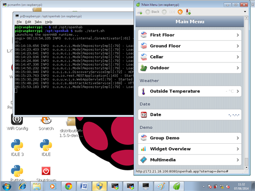

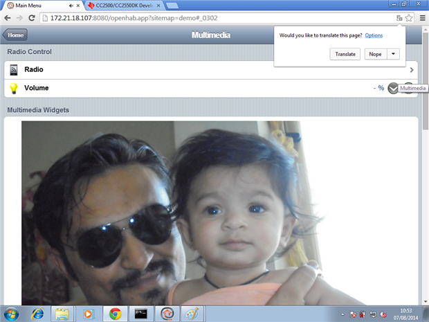

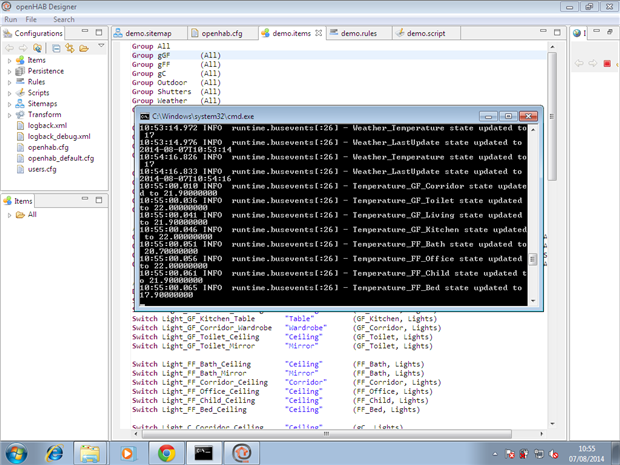

  • Downloaded OpenHAB runtime, OpenHAB addons, Open HAB Designer for windows, Open HAB Designer for linux and OpenHAB Demo from openHAB - empowering the smart home
  • Setup OpenHAB server on my Windows7 laptop. It is very easy to setup and getting run out of the box with OpenHAB demo..Easy to make some modifications too... image
  • Then I moved to my RaspberryPI-A to setup OpenHAB server ...but No success.. I have setup my SD Card again with latest Raspbian Wheezy 2014-06-20 which comes with java.. it boot ups but no screen even with TV or SSH from my Laptop. Tried many time but no success..
  • I have received RaspberryPi-B+ as a prize from element14 in Extra raspberry sauce: The great Raspberry Pi B+ giveaway thanks to stujo7.Now I have started again to setup OpenHAB Server on my RaspberryPi-B+ suddenly I realize that I can't able to configure static-IP bcoz RCA cable to connection with TV is now required all different with 4-pole 3.5mm jack.image
  • I have Installed DHCP Server for windows on my Laptop to assign Static-IP and start working with RaspberryPi-B+ from http://www.dhcpserver.de/dhcpsrv.htm image
  • Finally I am able to assign Static-IP to my RaspberryPi-B+ and started setting up OpenHAB server on RaspberryPi-B+. Thanks to fvan for his blog post ForgetMeNot - Week 1: EnOceanPi and Sensors image
  • But I am end up with error saying...ERROR o.o.m.c.i.f.FolderObserver[:105] - An unexpected exception has occurred image
  • After struggling for whole day and night I have accidentally enabled camera module from raspi-config and after reboot OpenHAB starts working perfectly image.
