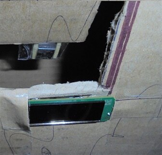

My mailbox prototype is only for demonstration, I will be buying real mailbox and will use enocean reed contact sensor with that mail box..Also I am planning to put another enocean reed contact sensor at back of mailbox where mail collection door is located.
So for every new mail I will be getting notification with count of new mail in my mailbox and when mail collect door opens these count automatically reset to zero.

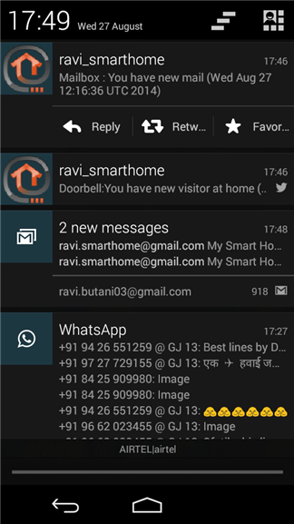

As you can see in Android screen shot of email and twitter notification, twitter notification is very fast compare to email notifications, almost there is two minute difference between email and twitter notification.
