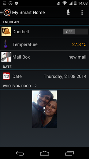

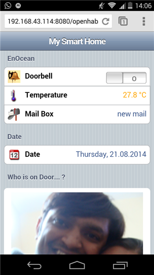

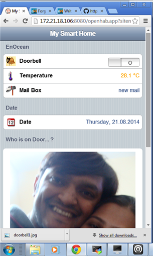

My working OpenHAB URL on desktop....
working openHAB url and OpenHAB android application on my cell phone

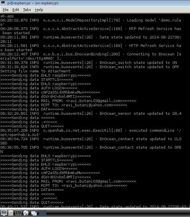

working script with email notification

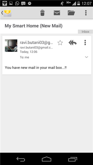

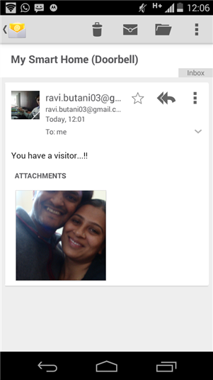

notifications received on my email id

* This rule sends email to home owner when doorbell switch pressed with photo as attachment
* here execute command line is just for demo it actually takes photo from PI Camera and save this image in specified folder
* So far I am waiting for PI camera so its not implemented
rule "send mail doorbell"
  when
  Item EnOcean_switch received update ON
  then
  sendMail("ravi_butani@yahoo.com", "My Smart Home (Doorbell)" , "You have a visitor...!!","http://localhost:8080/images/ondoor.png")
  executeCommandLine("/opt/openhab/a.out")
end
* This rule sends email to home owner when new mail dropped in mail box
rule "send mail update Mailbox "
  when
  Item EnOcean_contact received update CLOSED
  then
  sendMail("ravi_butani@yahoo.com", "My Smart Home (New Mail)" , "You have new mail in your mail box...!!")

now I am able to see events on my openHAB url in Home network as well as remote network and email notifications too on my email address..
here is android application https://play.google.com/store/apps/details?id=at.bherbst.net&hl=en I am using for Portforwarding for setup remote URL As I have not wi-fi router available at Home to setup remote URL...
