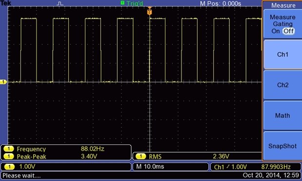

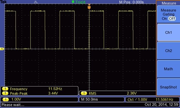

The website tells us that..." The rain gauge is a self-emptying bucket-type rain gauge which activates a momentary button closure for each 0.011" of rain that are collected. The anemometer (wind speed meter) encodes the wind speed by simply closing a switch which each rotation. A wind speed of 1.492 MPH produces a switch closure once per second"
Hence the emulator should produce variable frequency and the MET system should measure it and report it. I used the MSP340F5529 Launchpad to read an analog value and produce the required frequencies. Scope captures are given below.
These are from the same output and I feed these as weather station outputs to the CC3200. Next the CC3200 part. Temperature data can be captured from the CC3200's OnBoard temperature sensor.

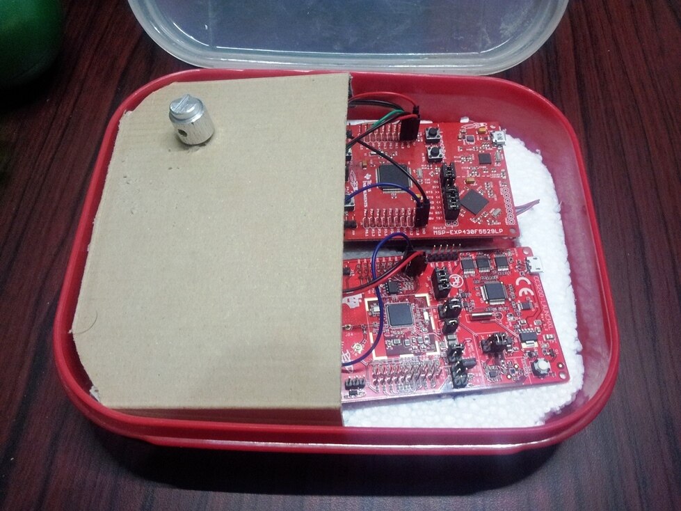

I am using MQTT pretty extensively in this project. eclipse PAHO project provides code for embedded clients and Benjamine Cabe has a great tutorial on getting started. I wrote the necessary tasks for reading the temperature and calculating the speed. Using Timer A0 I was able to measure the frequency of the input and it works better than expected. The CC3200 has a lot of Great sample projects that help out a lot. shabaz sir has written a great tutorial CC3200 "Internet-on-a-Chip" Getting Started Guide – Part 1
My objective was to simply read the data and post it to the MQTT broker. The final system looks like this.
The portable version for Demo makes it easy to move around. The power is from a Booster pack which both share. I am using existing code from my previous project to read the battery status. However I am not sending that right now. My Idea was to use a solar panel but that will have to come at later stages. My current solar solution is based on the Li-Po Rider Pro and I am looking for a local person to make the PCBs necessary.

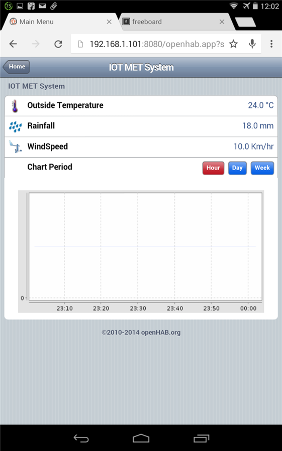

The met system screen on openhab looks like

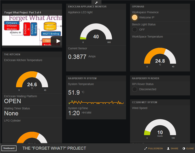

In order for the data to be made available online i used freeboard which allows the data to be publically displayed. The working is simple and uses dweets to upload data and freeboard puts it on display for the world to see. I managed to put together the following:
you can visit the live feed (when we have power)at https://freeboard.io/board/qeRlqA
