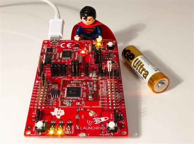

The CC3200 has been a recent revolution; it is advertised as the first “internet-on-a-chip” solution with combined microcontroller and 802.11 (Wi-Fi) connectivity to easily connect to services on the Internet, all in a single integrated circuit.
It is available on the CC3200 LaunchPad board  CC3200 LaunchPad board  shown in the photo below, and is great for developing IoT solutions that need high levels of connectivity and compute performance yet need to run on tiny amounts of power.

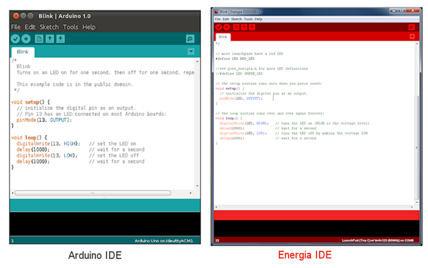

In terms of programming, there is an environment called Energia which allows Arduino enthusiasts to have a near-identical experience compared to their Arduino programming environment. There is also a more conventional integrated development environment (IDE) called Code Composer Studio (CCS) available for free, and commercial third party IDEs such as IAR Embedded Workbench are available too. This getting-started guide will use CCS.

The CC3200 LaunchPad is feature-packed. It is about the size of a Raspberry Pi and contains two 20-pin headers that provide general purpose I/O, ADC channels, I2C, SPI, PWM and other functions. The board contains a built-in USB-to-JTAG interface intended for debugging and for FLASH memory programming; no additional programming hardware is needed and the interface can be optionally connected up to CC3200 devices on custom boards too.
There is a built-in 802.11 antenna, some general purpose switches and LEDs and a nice ‘sensor area’ which contains an accelerometer and ‘thermopile’ sensor which can measure temperature remotely by pointing it at an object.
The whole board can be powered from the USB port, or from a couple of AA batteries! Of course, the experimenters may attempt solar power too; this should be feasible given that there are some great low-power modes.

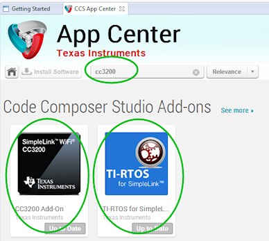

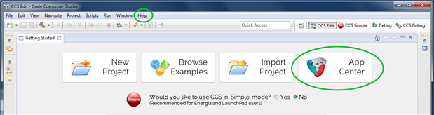

If you already have CCS installed (it is used for other TI microcontrollers too) then click on Help->Getting Started and then select App Center.
Type cc3200 in the search box and install the two results (CC3200 Add-On and TI-RTOS for SimpleLink).
If you don’t already have CCS installed, it can be obtained from here.
6.1 CCS Install Notes
The guide to follow is the CC3200 Getting Started Guide (PDF). I installed it in a folder I called C:\ti (TI software is usually well-behaved and will all then install into the same top folder). At the Processor Support screen, select SimpleLink Wireless MCUs (and any others you may want). Once it has installed, when you run it for the first time it will ask for a Workspace folder, which will become the top-level folder into which projects can be created. You could select something like C:\work\ccs_workspace as an example. At the Getting Started screen, click on App Center, type CC3200 and select CC3200 Add-On and TI-RTOS for SimpleLink and click the Install Software button.

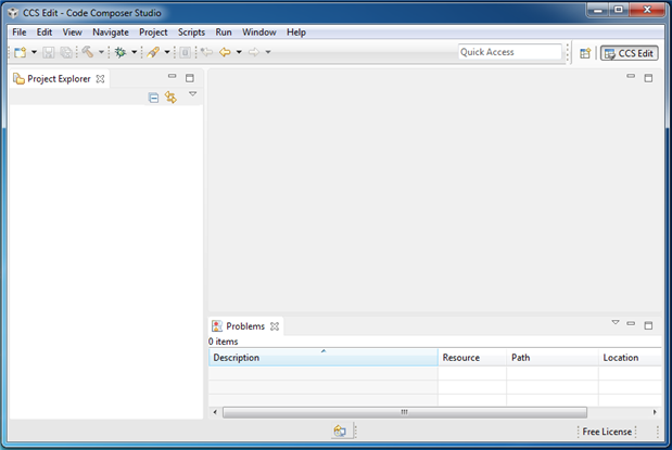

If you’ve not used CCS before, the hammer icon will be used to compile software, the bug icon will be used to transfer the code to the LaunchPad and run it, and the indication on the right which says CCS Edit (see screenshot below) will show when the view is switched a view more suitable for code entry to a view more suitable for debugging (you won’t ordinarily need to click here). A view is just a set of panes or sub-windows, so for code entry you can expect the view to show the source code folder pane, a text editor and a compile output pane; the debugger view will show variable and disassembly window panes. So, if things on the screen re-arrange themselves automatically when you click on the bug icon, it is a sign that the view has been switched.
You can close the CCS App Center and Getting Started windows by closing the tabs.
Once you do that, you’ll see the CCS Edit view is nicely divided up into a folder section, the code entry section and a problems/status type of area below:

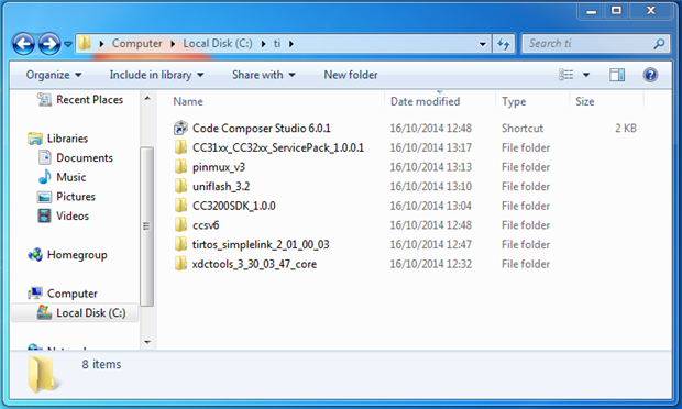

6.4 Review

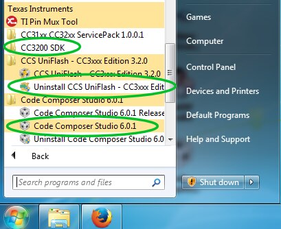

At the end of all the software installation steps, the top-level C:\ti folder will look like this:
The Windows Start menu will have a Texas Instruments folder with lots of stuff. The items that will be used regularly are marked below. Also, the CC3200 SDK folder contains lots of useful documents that are worth referring to.

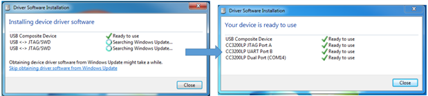

UniFlash as described above is also used to transfer service pack updates to the CC3200. To do this, click on New Target Configuration in UniFlash, then click OK. You should see a view as shown below.
The COM port number (30) shown in the screenshot above will need changing. Plug in the LaunchPad into the PC, and drivers will be installed. Then type ‘Device Manager’ after clicking on the Windows Start button, and check what COM port number the LaunchPad was allocated:
Once you know this, change the ‘30’ to the correct COM port number. Move the jumper to the UniFlash position. Then click on Service Pack Update and navigate to C:\ti\CC31xx_CC32xx_ServicePack_1.0.0.1 and select the servicepack_1.0.0.1.0.bin file (numbering may vary). During the update, if UniFlash prompts to ‘please restart the device’ at any time, click the RESET button on the LaunchPad. After the service pack update is complete, move the jumper back to the ‘normal’ position.

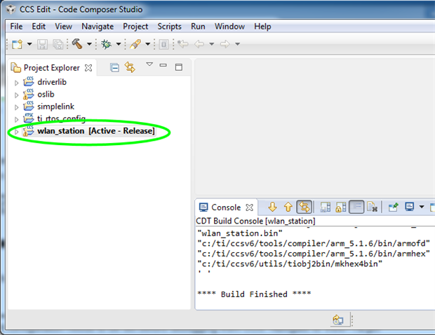

The first step is to run an existing demo program (afterwards it can be modified into the desired program). The process to build a demo program is described in the Getting Started guide in section 3.1.3 and is well documented. At step 10, a file needs to be modified with your wireless network settings. Open with your favourite text editor and modify it as required.
Step 12 builds the demo project called wlan_station. Over time, as more projects are created, they will appear in the Project Explorer pane. To select any project, just click on it until it says Active, as shown below. It is good to just visually confirm like this, so that you’re on the correct intended project, before building a project.

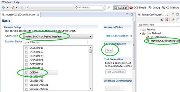

Step 15 concerns creating a ‘target configuration’. If it fails (it did for me when I used an older CCS install, worked fine on a newer instal), the issue can be resolved by right-clicking and selecting New Target Configuration in CCS, giving it a name, and then double-clicking on it and configuring it as shown here; note that you will be able to save it, but ‘Test Configuration’ will remain grayed out; this is fine.

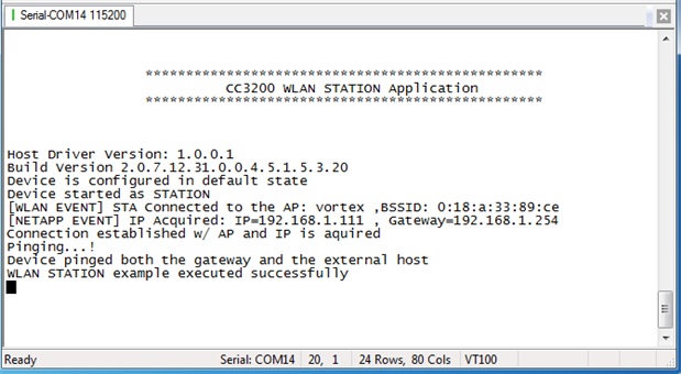

10. Running the Demo Program

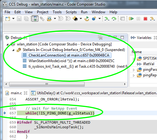

The demo programs send text information to the PC using a virtual serial port over the USB connection. Software such as PuTTY is required, select the COM port as before and set the baud rate to 115200 and then select connect in PuTTY.

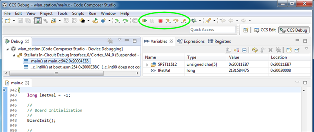

On the LaunchPad, ensure the jumper is in the UniFlash/Debugger position (this is not strictly needed on an off-the-shelf LaunchPad, but will be needed if you have flashed your own programs as will be seen later), and press RESET. Now, double-check that the wlan_station project is still selected in the Project Explorer, and then click the ‘bug’ icon. The view will now change to the debugger mode as shown below. The important controls are highlighted:
From this debug view, it is possible to start the program by clicking the green Run/Resume icon, and it is possible to stop the debug session (and revert back to the normal Edit view) by clicking the red Terminate icon (it doesn’t necessarily terminate the program as such, but it will put you back into the usual code editing view).
There are code stepping options and a pause button to temporarily suspend the program execution. Whenever these buttons are used, the Debug pane shows the stack trace from bottom-up; the example here shows a suspended program which is currently in a while() loop, and the stack trace shows that the function WlanStationMode called a function CheckLanConnection. There are extensive debug facilities but they are beyond the scope of this post. Application-level debugging is possible using print statements in the source code.
Time to run the program! When the green Run/Resume icon is clicked, the program will execute, and the terminal software (e.g. PuTTY) will display the following output:

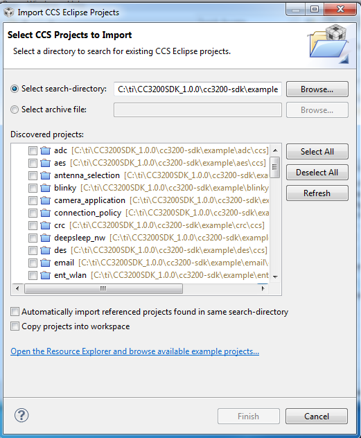

11. Working with Other Example Applications
There is a wealth of example applications in the CC3200 SDK example folder. They can be added to the workspace if desired by selecting Project->Import CCS Projects and selecting the C:\ti\CC3200SDK_1.0.0\cc3200-sdk\example folder and then choosing one of the projects (however often it is not necessary to add a project to a workspace; just viewing the code can be sufficient to get some ideas).

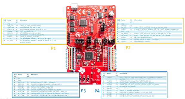

12. Using General Purpose I/O
There are four 10-way single-in-line (or two DIL 20-way depending on how you see it) header pin and socket type connectors on the LaunchPad. Most of the pins on the CC3200 are overloaded, meaning that a choice often needs to be made for what function is desired for each pin. The connectors are labelled P1-P4.
Useful references are the CC3200 LaunchPad circuit diagram (which will show which pins are connected to LEDs, switches etc) and the LaunchPad Hardware Guide (PDF).

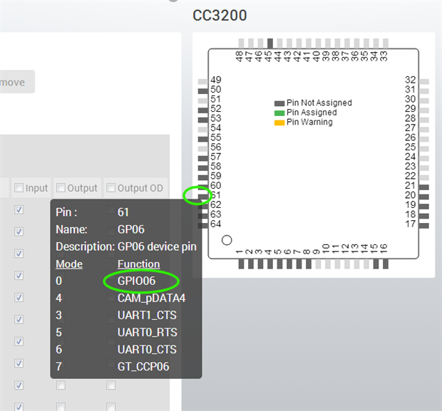

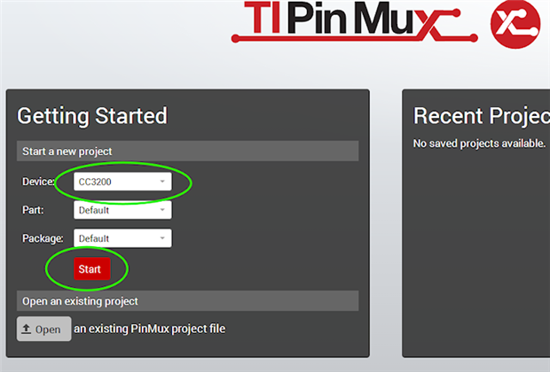

As an example, if it is desired to control the physical fifth pin on connector P1 as an output (e.g. to connect up an external LED), it can be looked up in the Hardware guide. As shown below, that fifth pin is a GPIO-capable pin, and the actual real pin number on the CC3200 integrated circuit it is wired to is pin 61.
The real pin number can be mapped to a logical internal GPIO number using the PinMux tool installed earlier. Start it up and select the CC3200 as shown below.

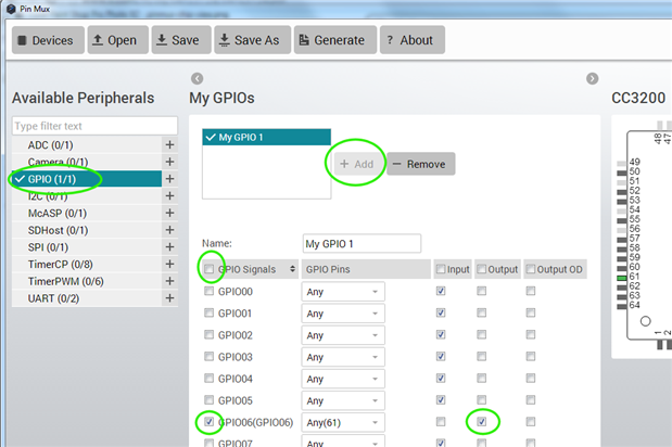

Hover over pin 61 in the chip view, and it will display the details about that pin; it can be seen that pin61 is internally wireable to GPIO06.
Next, select GPIO on the left under ‘Available Peripherals’, click Add and then deselect all the GPIO signals and then select just GPIO06, and click in the ‘Output’ column. All this is shown in the screenshot below:
Once you are done this, click Generate and select a temporary folder. In that folder, four files will be created. You can cut and paste that code into your project. Here is the bit of code that is needed; it is a function called PinMuxConfig:

To make life a bit easier, the image below can be referred to, to check what each pin is capable of. Any pin marked with an asterisk is not connected by default but can be by using zero-ohm resistor links.
The information is also pasted here to make it easier to read:

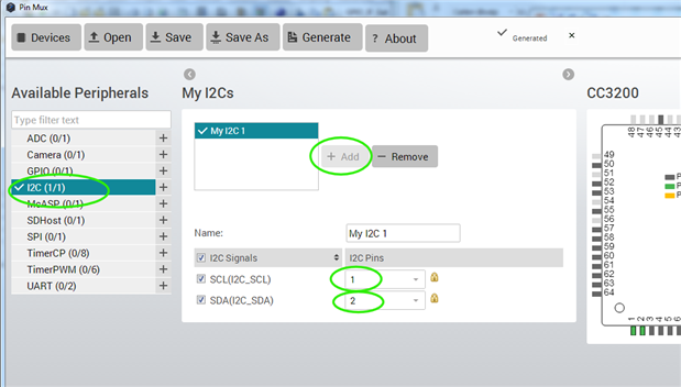

The example above can control an output pin. To read a pin, use the PinMux program to get the input configuration code, and then the status of the pin can be read using the GPIO_IF_Get function, e.g. GPIO_IF_Get(SWITCH_GPIO, my_switch_port, my_switch_pin). A non-zero value means that the pin is high.
13. Using I2C
Using I2C again means visiting the PinMux oracle. In this case, select I2C as the desired peripheral on the left, add it, and then select the physical chip pins; from the LaunchPad connector diagram it was clear that connector P1 pins 9 and 10 (for SCL and SDA) were usable, and these are wired to the physical chip pins 1 and 2 respectively. Click on ‘Generate’.
The generated code looks like this:
void PinMuxConfig(void)
    // Enable Peripheral Clocks
    MAP_PRCMPeripheralClkEnable(PRCM_I2CA0, PRCM_RUN_MODE_CLK);
    // Configure PIN_01 for I2C0 I2C_SCL
    MAP_PinTypeI2C(PIN_01, PIN_MODE_1);
    // Configure PIN_02 for I2C0 I2C_SDA
    MAP_PinTypeI2C(PIN_02, PIN_MODE_1);

The schematic, tables and the PinMux utility are essential for making the most of the built-in peripherals in the CC3200.

    shabaz over 9 years ago in reply to unithmb
    Hi Sunith,
    I've not tried it, but it should be possible. Basically, use the PinMux tool as described above, although now you can use the cloud version of PinMux which wasn't available when the article was written (but it is identical pretty much).
    Add your UART1 and UART0, select your desired pins and then download the pinmux config file as described in the article. If you happen to use the pins for GPIO01 and GPIO02 then you'll need to move jumpers J6 and J7 to the 'BP' (BoosterPack)
    position so that the pins go out to the DIL headers instead of to the on-board USB-Serial FTDI chip. You then won't be able to have the USB serial interface of course.
    Once you have tried it and got success, please do report on the config you used and pins you connected to, so that others can make use of the information too.
