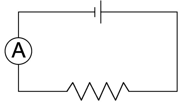

For this experiment, I am using two methods of measuring the current.
1. The Multimeter method-  You can measure current using an Ammeter by connecting it in Series in the circuit. This means just cut the wire and add the meter in the circuit. The diagram below is the simplest representation for the same. In using a multimeter, we can set it to measure current. Be careful while making the connections and the settings. In my setup I selected the 10Amp range as seen in the video below.

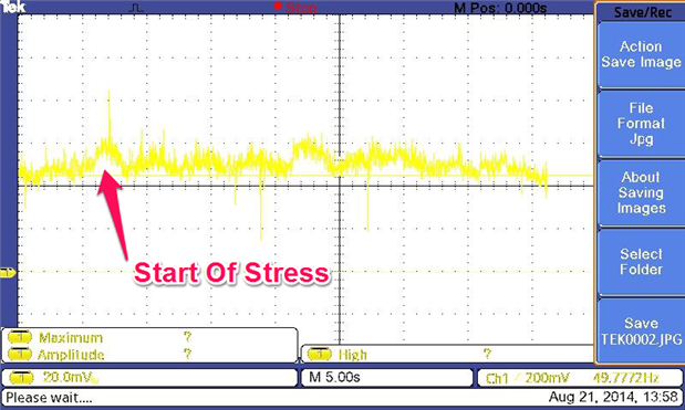

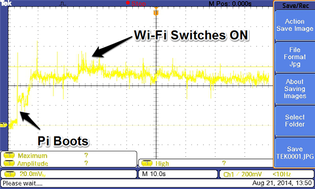

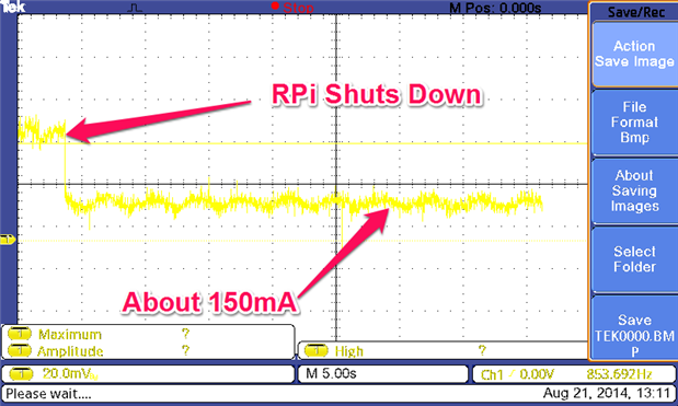

2. Using an Oscilloscope: Instead of using an Ammeter, we can connect a small resistance called a current sense resistor. Ohms law says that the voltage drop across a resistor is proportional to the current flowing through it. Here I added 10 1Ohm resistors in parallel so as to get a 0.1Ohm resistance in series. Now I could have use 10Ohms instead which translates to 1Ohm but that would mean that for a 1Amp current, I have 1 volt drop. From 5V if I drop 1V across the resistor then the Raspberry Pi will not work right at (5V-1V) 4V. Here for a current of 1Amp, we should get a drop of 0.1V or 100mV. I then connect an oscilloscope probes across the resistance and set it to 5 Seconds per division.

As the Pi Boots up the oscilloscope plot is as follows:
When I run the stress command as
stress --cpu 8 --io 4 --vm 2 --hdd 4 --timeout 30s --verbose --vm-bytes 128M
When shutdown the screen is:
Conclusion
The Raspberry Pi consumes around 150mA when shutdown and 380mA when operating. The wifi modules takes around 60mA and the Enocean Pi around 30-40mA.
