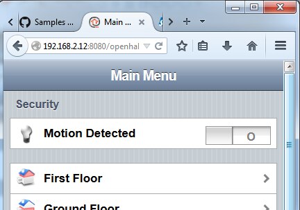

First I added a new "motionDetected" item in openHAB:
Switch  motionDetectState       "Motion Detected"
and added that switch to my sitemap.
Then I modified my motion.conf as follows:
on_event_start curl --max-time 2 --connect-timeout 2 --header "Content-Type: text/plain" --request PUT --data "ON" http://localhost:8080/rest/items/motionDetectState/state
on_event_end curl --max-time 2 --connect-timeout 2 --header "Content-Type: text/plain" --request PUT --data "OFF" http://localhost:8080/rest/items/motionDetectState/state
Essentially this gets motion to tell openHAB to set the motionDetectState when motion is detected, and then clear it when motion is no longer detected.
Restart motion:
sudo /etc/init.d/motion restart

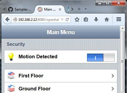

And run openHAB. Now when motion is detected, my switch is set to ON:
and I can see in my logfile:
23:32:25.595 INFO  runtime.busevents[:26] - motionDetectState state updated to ON
After a minute of no activity (the default gap setting is 60 seconds), I see the following:
23:33:28.528 INFO  runtime.busevents[:26] - motionDetectState state updated to OFF
and the switch returns to the off state:
