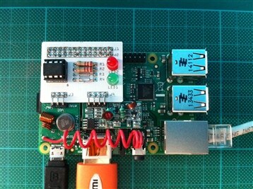

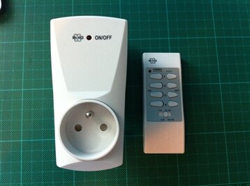

I have some Elro CoCo (Click On, Click Off) remote controlled power sockets that work on 433MHz.
I've previously made a small board for my Pi in order to control a 433MHz transmitter via an ATtiny85 over I2C.
To control this, I wrote a small Python script which will send commands to the ATtiny, which in turn will send out the correct codes to control the power sockets.

Because my little board uses I2C to communicate from Pi to ATtiny, I2C needs to be enabled before I can use it.
There is a great tutorial over at Adafruit on how to set up I2C on the Raspberry Pi: https://learn.adafruit.com/adafruits-raspberry-pi-lesson-4-gpio-setup/configuring-i2c
I followed the instructions to enable I2C on my Pi and verified my board was detected properly:
pi@webserver ~ $ sudo i2cdetect -y 1
     0  1  2  3  4  5  6  7  8  9  a  b  c  d  e  f
00:          -- -- -- -- -- -- -- -- -- -- -- -- --
10: -- -- -- -- -- -- -- -- -- -- -- -- -- -- -- --
20: -- -- -- -- -- -- 26 -- -- -- -- -- -- -- -- --
30: -- -- -- -- -- -- -- -- -- -- -- UU -- -- -- --
40: -- -- -- -- -- -- -- -- -- -- -- -- -- -- -- --
50: -- -- -- -- -- -- -- -- -- -- -- -- -- -- -- --
60: -- -- -- -- -- -- -- -- -- -- -- -- -- -- -- --
70: -- -- -- -- -- -- -- --
After that, I quickly tested if everything was working as expected, by sending commands to set a socket off and on.
pi@webserver ~ $ sudo ./rf433.py 67 2 0
pi@webserver ~ $ sudo ./rf433.py 67 2 1

Items
I've created four switches, each using the exec binding. The only difference, is the ID of the switch being passed to the Python script.
A Python call is specified to turn the socket ON and a second call is specified to turn it OFF.
//Exec Bindings
Switch Elro_socket_C1 "Exec" (exec) {exec=">[ON:/bin/sh@@-c@@/home/pi/rf433.py 67 1 1] >[OFF:/bin/sh@@-c@@/home/pi/rf433.py 67 1 0]"}
Switch Elro_socket_C2 "Exec" (exec) {exec=">[ON:/bin/sh@@-c@@/home/pi/rf433.py 67 2 1] >[OFF:/bin/sh@@-c@@/home/pi/rf433.py 67 2 0]"}
Switch Elro_socket_C3 "Exec" (exec) {exec=">[ON:/bin/sh@@-c@@/home/pi/rf433.py 67 3 1] >[OFF:/bin/sh@@-c@@/home/pi/rf433.py 67 3 0]"}
Switch Elro_socket_C4 "Exec" (exec) {exec=">[ON:/bin/sh@@-c@@/home/pi/rf433.py 67 4 1] >[OFF:/bin/sh@@-c@@/home/pi/rf433.py 67 4 0]"}
