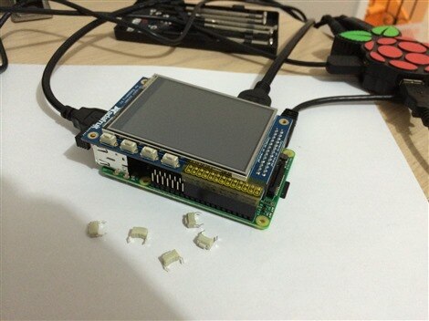

This week a play with the PiTFT from Adafruit https://www.adafruit.com/products/1601, also available on newark Product LinkProduct Link
I want use the PiTFT with Pi for made a control panel to install in my kitchen and easily open/close my curtain, view and change heating temperature and control my home ventilation.
Setup
This is the procedure a use to setup my device https://github.com/pascalmartin/ForgetMeNot/tree/master/bundles/pitft

Configure tactile switch as power button From Adafruit
gpio pin from left to right : 23, 22, 21, 18 (I'm not use 23 because is on top of usb connector and the metal short the switch, i need a case)
Summary:
  • Add rpi_power_switch to /etc/modules
sudo sed -i '$ a\rpi_power_switch' /etc/modules
  • Append options rpi_power_switch gpio_pin=18 mode=0 to /etc/modprobe.d/adafruit.conf
sudo sed -i '$ a\options rpi_power_switch gpio_pin=18 mode=0'  /etc/modprobe.d/adafruit.conf
  • To make it active immediately run sudo modprobe rpi_power_switch or reboot
    mcb1 over 12 years ago
    Nice.
    I'm still waiting on two I kickstarted, and he seems to have gone to ground unfortunately.
    I always dislike shields and other items that rely solely on a connector for physical attachment.
    You could stick a bit of mylar onto the USB using double sided tape.
