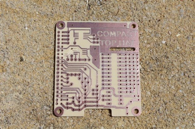

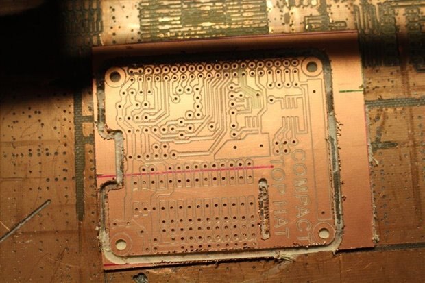

Old habits die hard so as per usual I've laid the board manually without the assistance of any schematic capturing.
And then milled and drilled a PCB.
Weeded and cleaned it up.
You may notice a bit of over engraving on a couple of tracks. This is a due to PCB substrate warpage but since it is just a prototype it can be easily repaired.

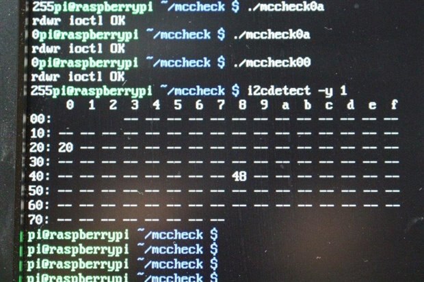

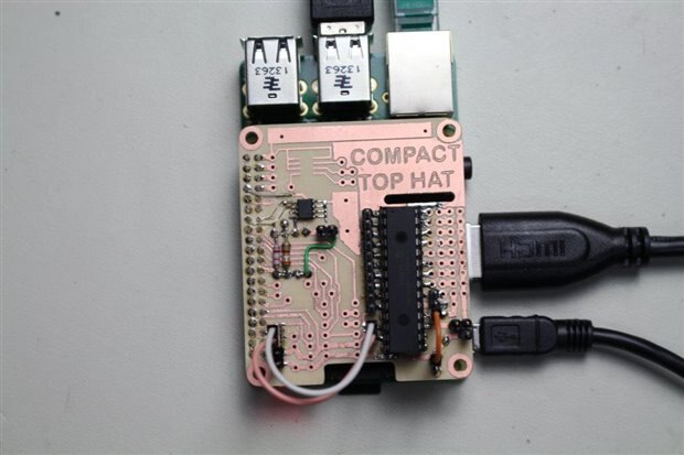

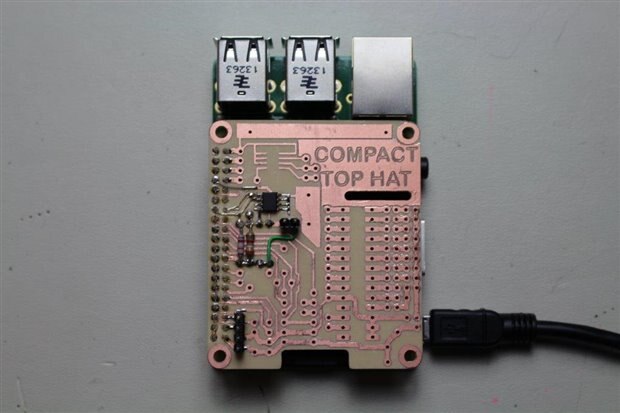

The first section assembled and tested was the HAT's ID EEPROM section.

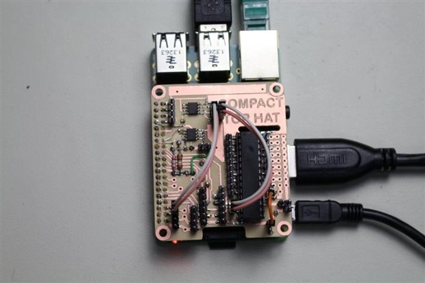

Once this was up and working correctly.The next part was the MCP23017 I/O Expander
And then the DS1721 Thermometer was added (pictured in the first photo of this article).
All of the devices were accessible from the Raspberry Pi.
And finally exported GPIO, RS232 and SPI ports were tested and confirmed working.
Although not pictured LEDs and a DSO was connected up to verify correct operation.
Test programs were written in C on the Raspberry Pi. It included test programs to blink LEDs on the GPIO and MCP23017 IO ports.
Then a PSoC4 was connected up to the via the I2C, RS232 and SPI ports and was verified to work correctly.
