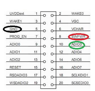

Do any one have HSM100 humidity sensor schematic...? I need it for understand how my other analog sensor will talk with STM330 temperature sensor. I have tried to find it on enocean website but no luck... I have tried to get rough idea about hsm100 schematic using pics...but all pics available on internet is with bottom side..but no image from top..
Note: I do not require HSM100 for my project but I just need Schematic of HSM100 to build my custom analog sensor...
What I know from STM330 user manual is..
SWPWR is VCC and only available when module not in deep sleep
GND is ground for HSM100
ADIO3 is Analog input from HSM100
Other pins ---I have no idea
may bebryan.edelman@enocean.com can you please help me in this matter...?

    0 hlipka over 12 years ago
    Actually the pins you marked are the ones needed. SWPWR gets active some 30 microseconds or so before the measurement starts, and then the analog pin will be read. But I think OpenHAB will not be able to use that, because it doesn't know the EnOcean configuration needed for that.
    The STM330 user manual describes the measurement process in more detail, I think.

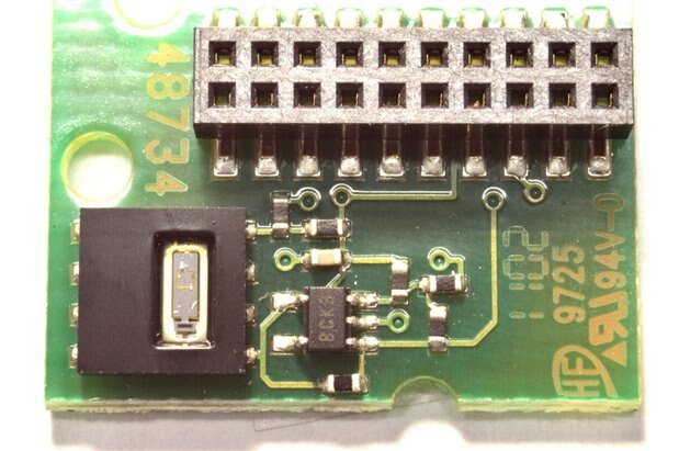

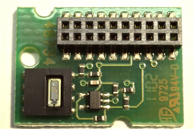

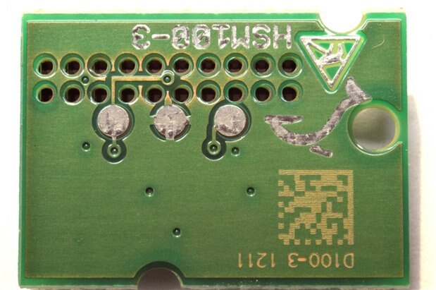

    Ravi
    (2nd try since it decided I wasn't allowed to post here)
    Here are some pictures (click for full size).
    I can't attach the larger version so 2MB is all you get ... sorry.

    Too bad one still cannot see what the moisture sensor is on it image

    It kinda looks like one of these, but the pinout is definitely different.
    http://www.sensirion.com/en/products/humidity-temperature/humidity-sensor-sht2x/

    Double checked and there are no markings on it...

    My conclusion is hsm100 output is not analog .... Its pwm and stm330 measuring pulse width to take humidity measurement on adio3 .... So adio3 is configured as input for timer interrupt....
    All my thoughts regarding analog sensor interfacing with stm330 is wrong...I need to think again with different considerations...

    Can you help me by providing me a part number of humidity sensor chip on hsm100 ?
