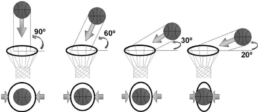

  • A higher arc creates a steeper angle of entry into the basket, which effectively makes the hoop “larger.” This gives the ball more room to go in, even if the shot isn’t perfectly centered.

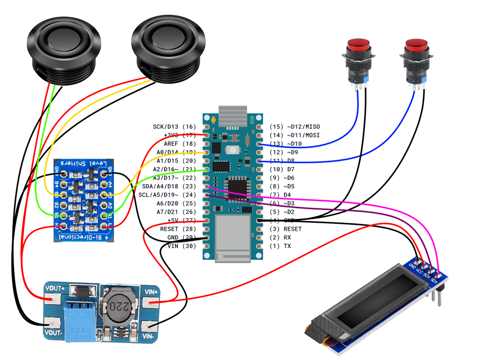

To build the SwishMaster device, you need the following hardware components
The connections among the components are shown in the following picture
In the following table, the Arduino pins actually used are listed
Number Name Function
4 GND Ground for display and push buttons
11 D8 Push button 1
13 D10 Push button 2
17 +3V3 Power supply for the low-voltage side of the level shifter
19 D14 Trigger/echo USSM 1
21 D16 Trigger/echo USSM 2
23 SDA I2C data (display)
24 SCL I2C clock (display)
27 +5V Power supply for display and step-up converter
29 GND Ground for step-up converter and level shifter

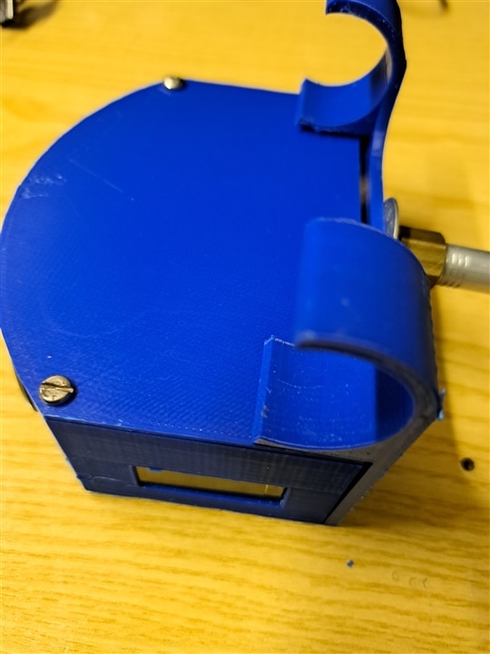

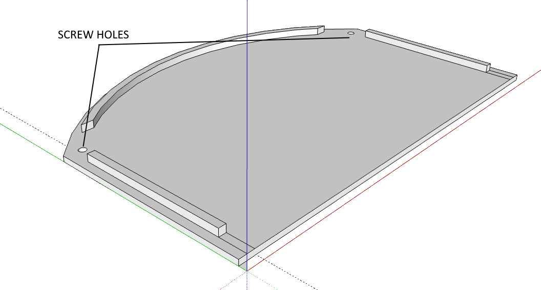

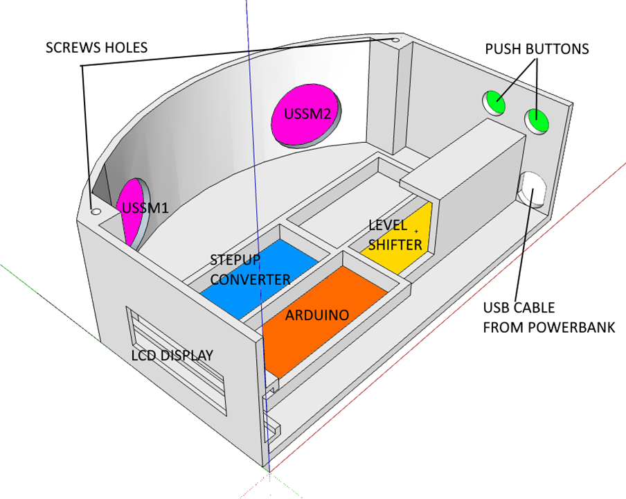

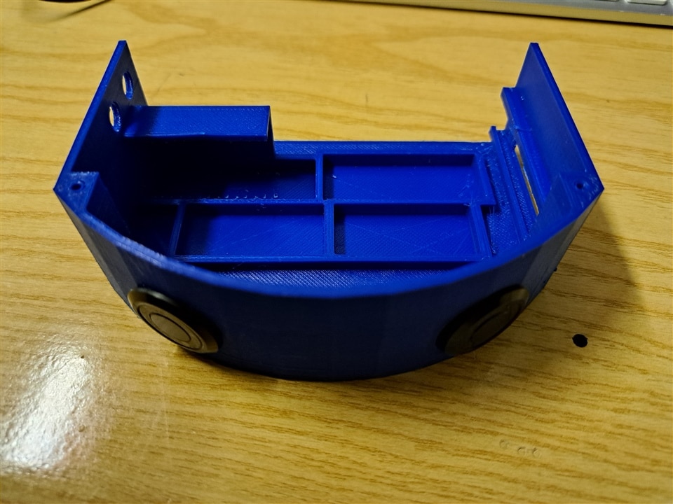

The case
The case has been 3D-printed. The STL and Sketchup files are available on the github repository.
There are three main parts to print
  • the case, which hosts all the electronic components
  • the cover, which is mounted over the case and is held in place by two screws

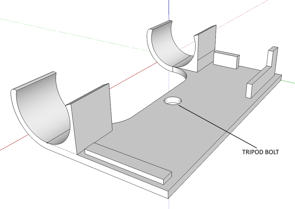

  • the base, which has brackets to hold the cylindrical-shaped powerbank

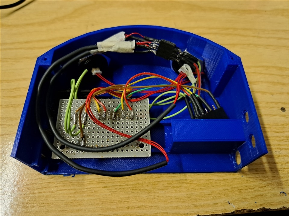

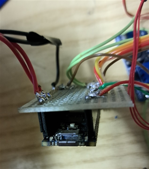

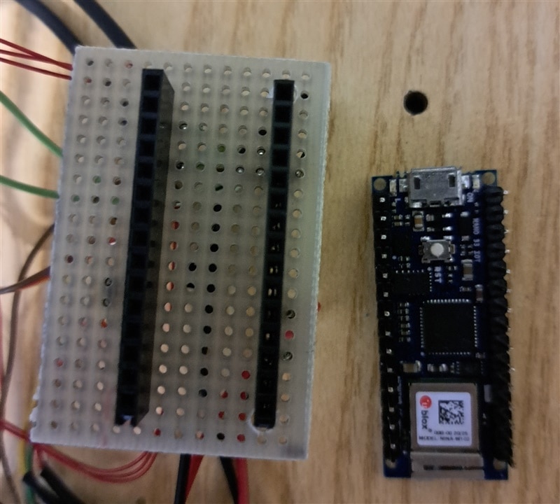

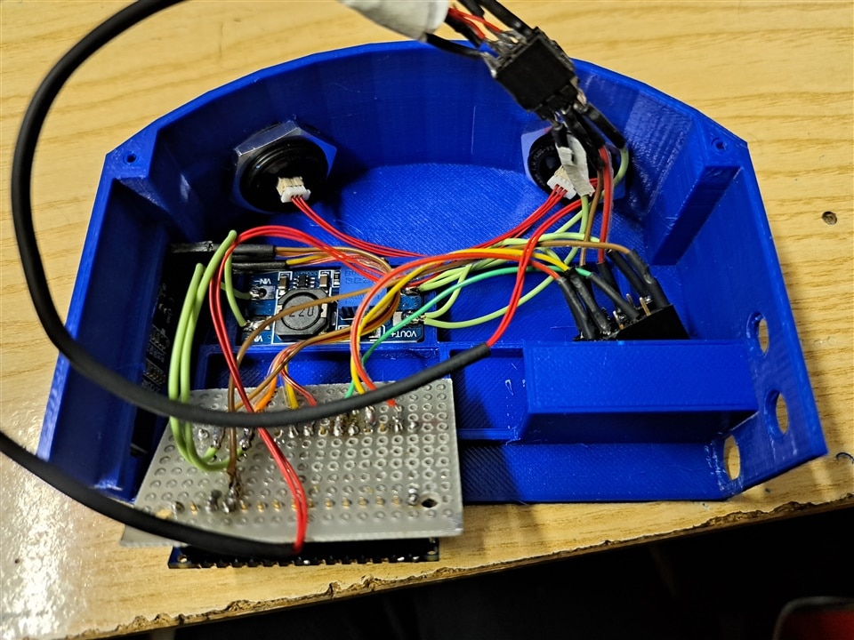

Wire all the electronic boards as shown in the above diagram. I found extremely useful to create a piggy-back board for the Arduino. This board, which is made out of a breadboard, simplifies the soldering process for pins where many wires needs to be connected (for example, ground and power supply)

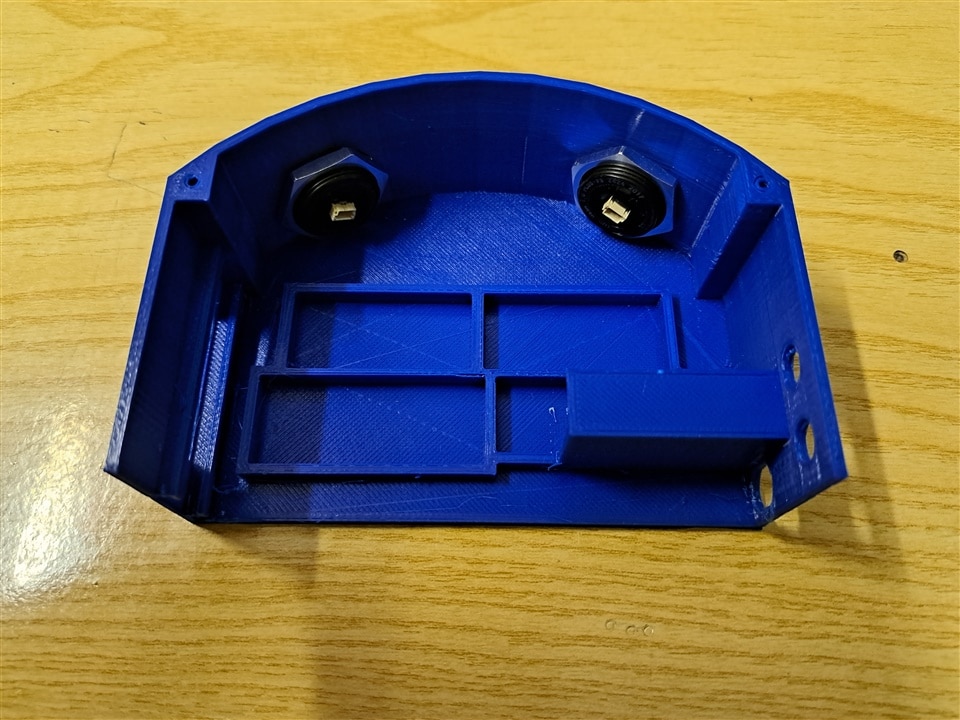

Mount the two USSMs in the two holes on the curved surface of the main case. Use the bolts and gaskets included in the evaluation kit
image  image

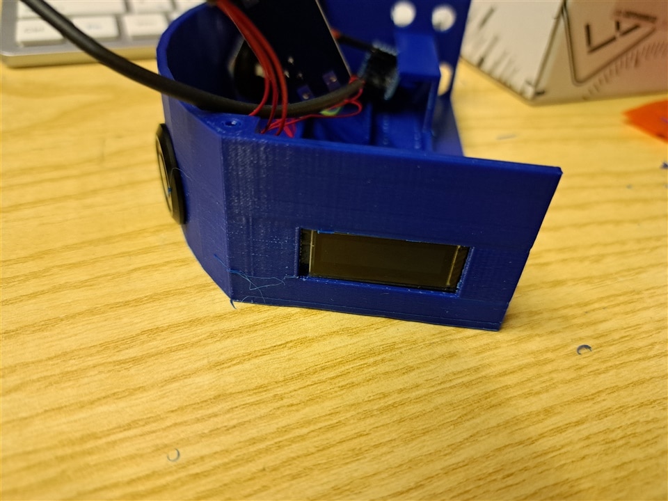

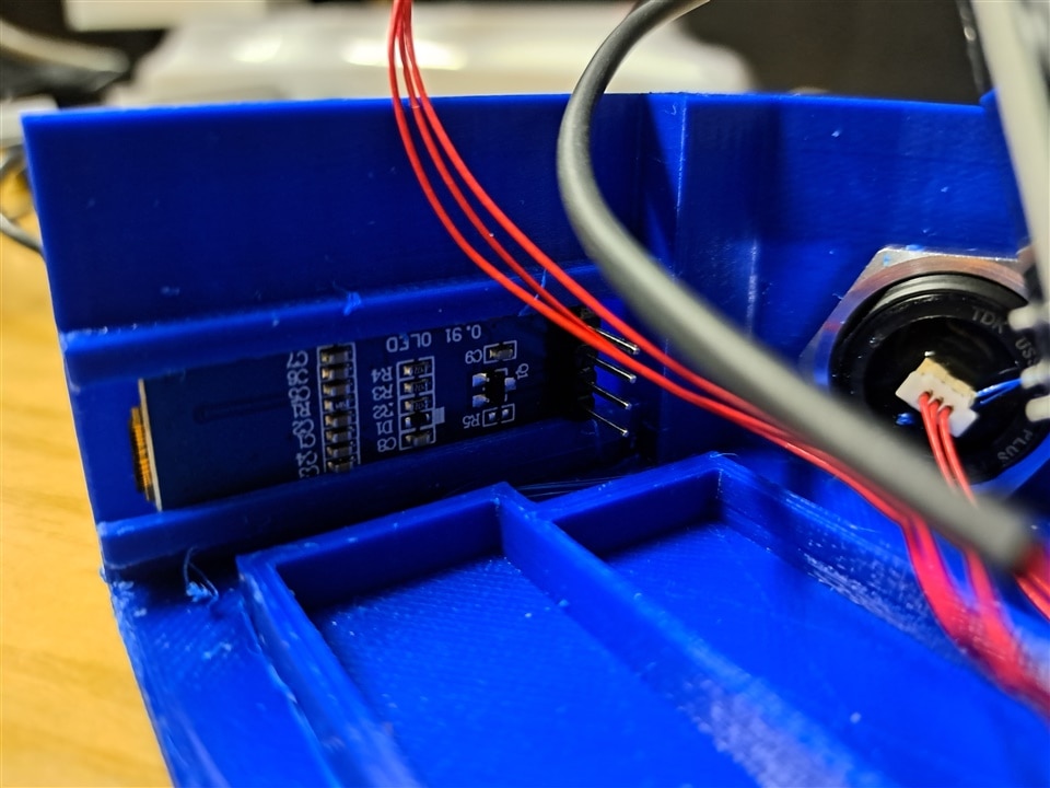

Slide the OLED screen into place. The two guides will help to hold the screen itself in place

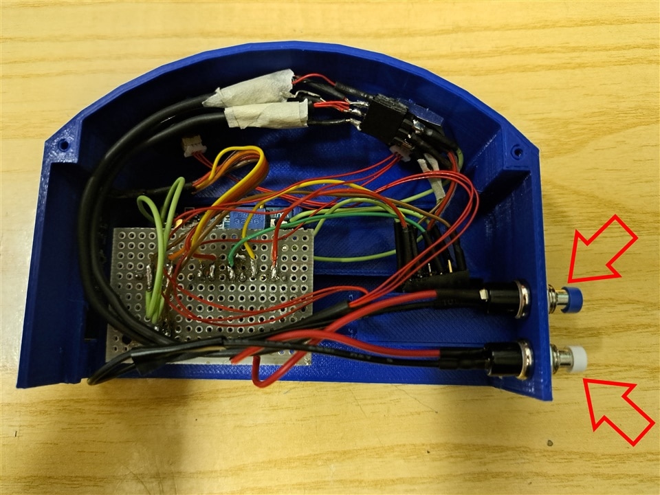

Each electronic board can now be placed in its own slot. A piece of double-side tape helps to keep everything safely in place
image  image
Also the two push buttons can be slid into the designated holes

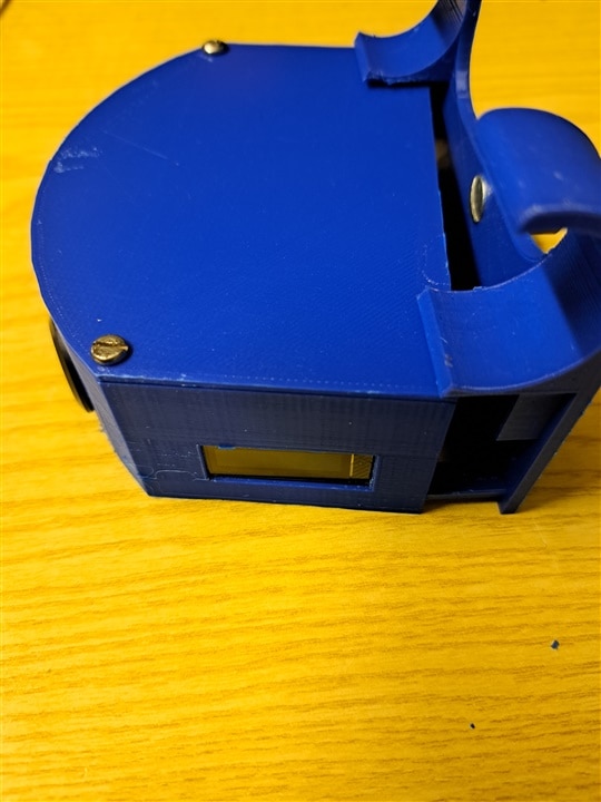

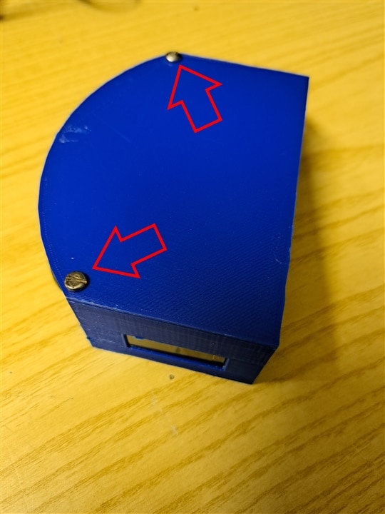

The assembly is completed. Place the cover on the top of the main case and use two screws to keep it firmly in place

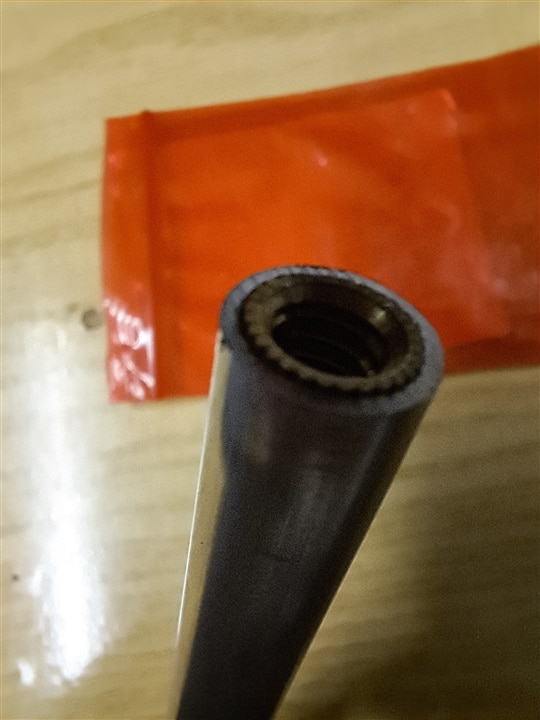

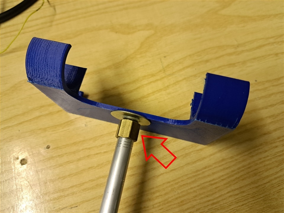

Finally, complete the bottom part. First of all, add a bolt to mount the SwishMaster device on tripod. Tripods have a 1/4 inch (or 20 UNC) screw, so you can gently press a bolt of the corresponding size into the bottom part of the case. In my case, the tripod was not high enough (SwishMaster should stand at 2 meters from the ground, so that it can easily detect the ball at an height of up to 4 meters), so I used an hollow aluminum bar. On one side of the bar, I press-fit the bolt, on the other side I screwed a bolt, as shown in the following pictures.
image  image
The bottom part should fit perfectly in the space between the case walls but, in case it is loose, some tape is enough to hold it in place.
image  image

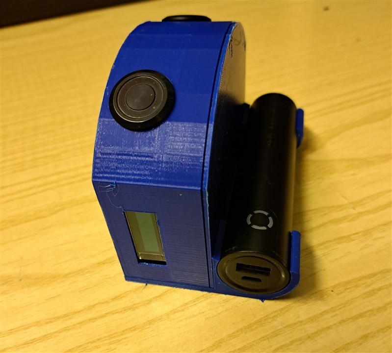

Finally, add the powerbank and connect the USB cable to the powerbank itself and to the Arduino board

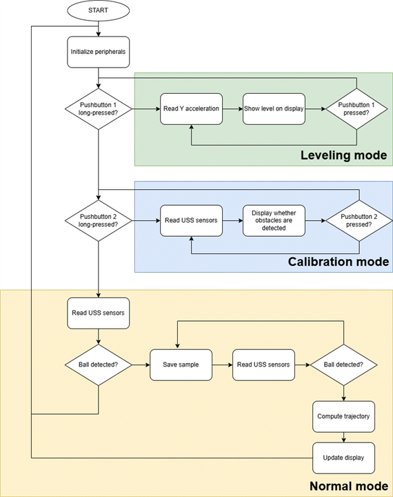

The swishmaster.ino file is the main file, that handles the application state machine, according to the following flow chart
The project includes also a number of classes that implement specific functions. Classes are

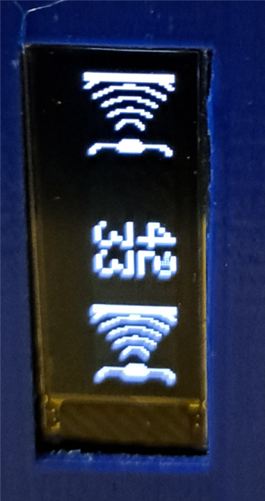

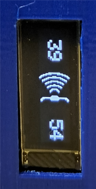

  • The device automatically enters "Calibration mode"
    • image
  • Position the SwishMaster so that the display two "Success" image icons. This means that no obstacles are in the range of the sensors, and ball can be reliably detected
  • Push the bottom button to enter "Working mode"

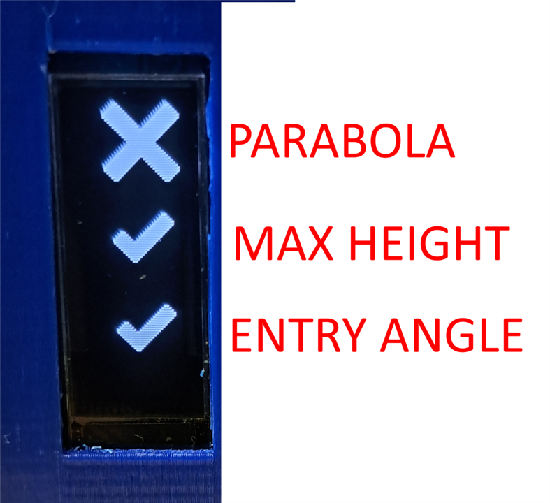

  • Throw your free throw and check the rating. Three icons are shown, each of which can be either "Success" image or "Fail" image. From top to bottom, we have
    • Parabola: the parabola is considered correct if the calculated "a" parameter of the parabola is above 0.015
    • Maximum height: height is considered correct if the maximum height is above 3.3 meters
    • Angle of entry: angle is considered correct if it ranges from 40 to 65 degrees

Here the three success/fail icons have the same meaning as on the display of the Swishmaster device. From left to right, we have
  • Parabola
  • Maximum height
  • Angle ot entry
Below the icons, the calculated values of each parameter are shown

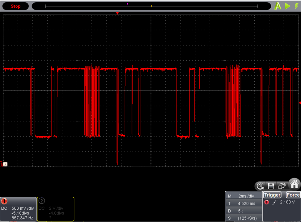

First, I tried to increase the number of points used in the interporlation function. The problem is that there is a physical limit to the number of samples I can take. The limit is related to
  • the maximum acquisition rate of the USSM: according to my experiments, a pause of at least 10 ms is required between two readings in order to get reliable and accurate measurements. Without the pause, the measurements show a significant increase in the variance
  • the time-of-flight of the ball. It takes about 800 ms for the ball to reach the backboard, and the SwishMaster does not cover the whole path from player's hand to backboard. Assuming that the SwishMaster can "see" the ball for just 500 ms, the maximum number of positions that can be read is less than 10

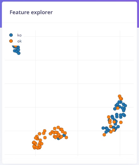

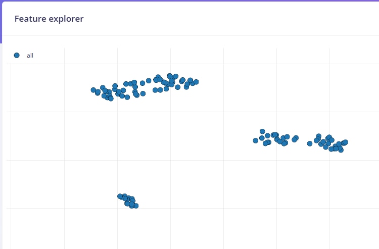

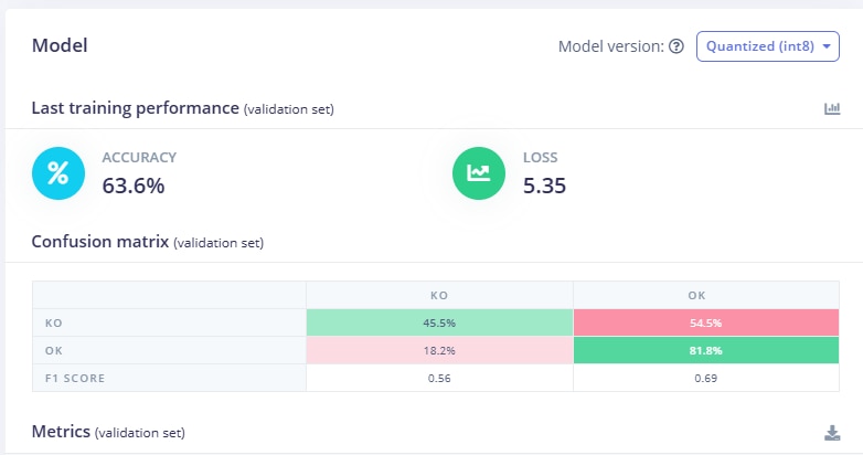

As a second attempt, I tried to train a neural network on Edge Impulse. The idea was to feed the neural network with the ball positions and get whether the trajectory arc is good or not as an output. This work is still in progress, but looks like the decision regions have clean boundaries. I shot about 100 free throws, half with a good arc and half almost flat. The detected positions for each shot have been saved in a CSV ifle and uploaded to Edge Impulse.
If I use the output of my current trajectory analysis algorithm to label the samples, the output is quite poor...
image       image
But if I let Edge Impulse extract features from dataset, we can identify two well separated decision regions
For this reason, I am confident an approach based on the EdgeImpulse platform and a neural network could possibly achieve a better accuracy compared to the approach based on a quadratic equation.
