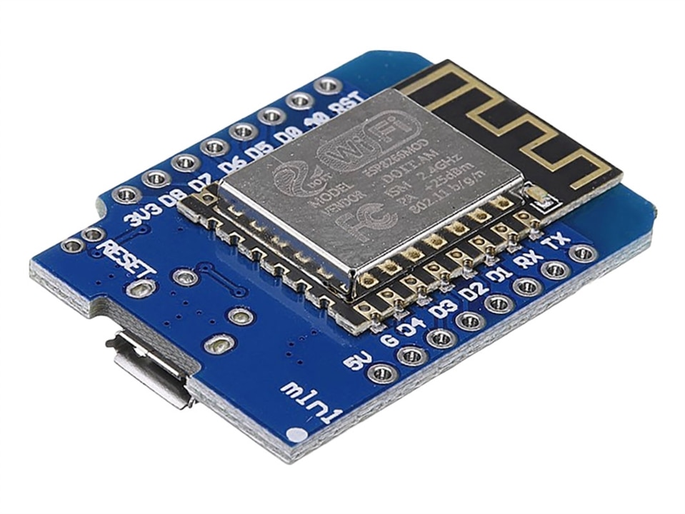

2. ESP8266 Wemos D1 Mini

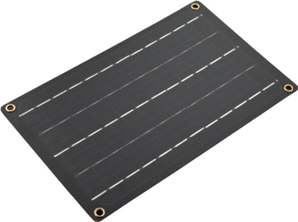

6. DFRobot Monocrystalline Solar Panel (5V, 1A)

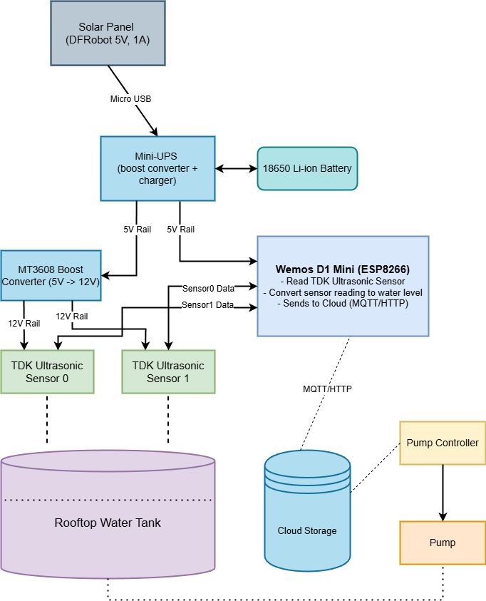

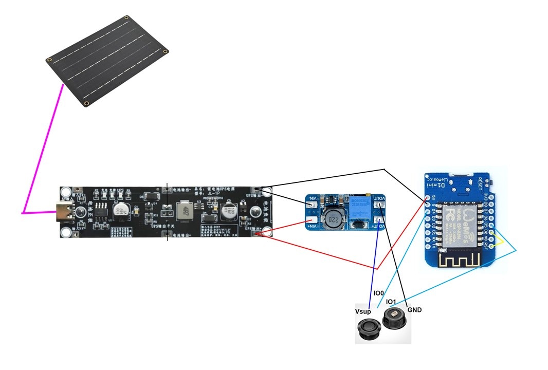

The hardware system for EchoFill is built around an ESP8266-based Wemos D1 Mini powered by a single 18650 Li-ion battery for continuous operation in rooftop environments. A mini-UPS charging module is utilized to not only raise this from the 3.7 V of the battery to a stable 5 V for the Wemos board, but simultaneously charge the battery from a regulated 5 V solar panel (DFRobot 5 V, 1 A). Two TDK ultrasonic sensors are used to measure the water level of the tank, requiring each 12 V supplied with an MT3608 boost converter stepping up the output 5 V of the UPS module to 12 V. The Wemos D1 Mini reads the ultrasonic sensors for water level, calculates the water level in the tank, and publishes data to the cloud. A separate pump-controller unit gets this cloud data and automatically controls the water pump. All electronics (except the solar panel) are contained inside a small 3D-printed enclosure designed for outdoor mounting on the rooftop.
The following image shows the block diagram of the system.
Hardware Connection Diagram

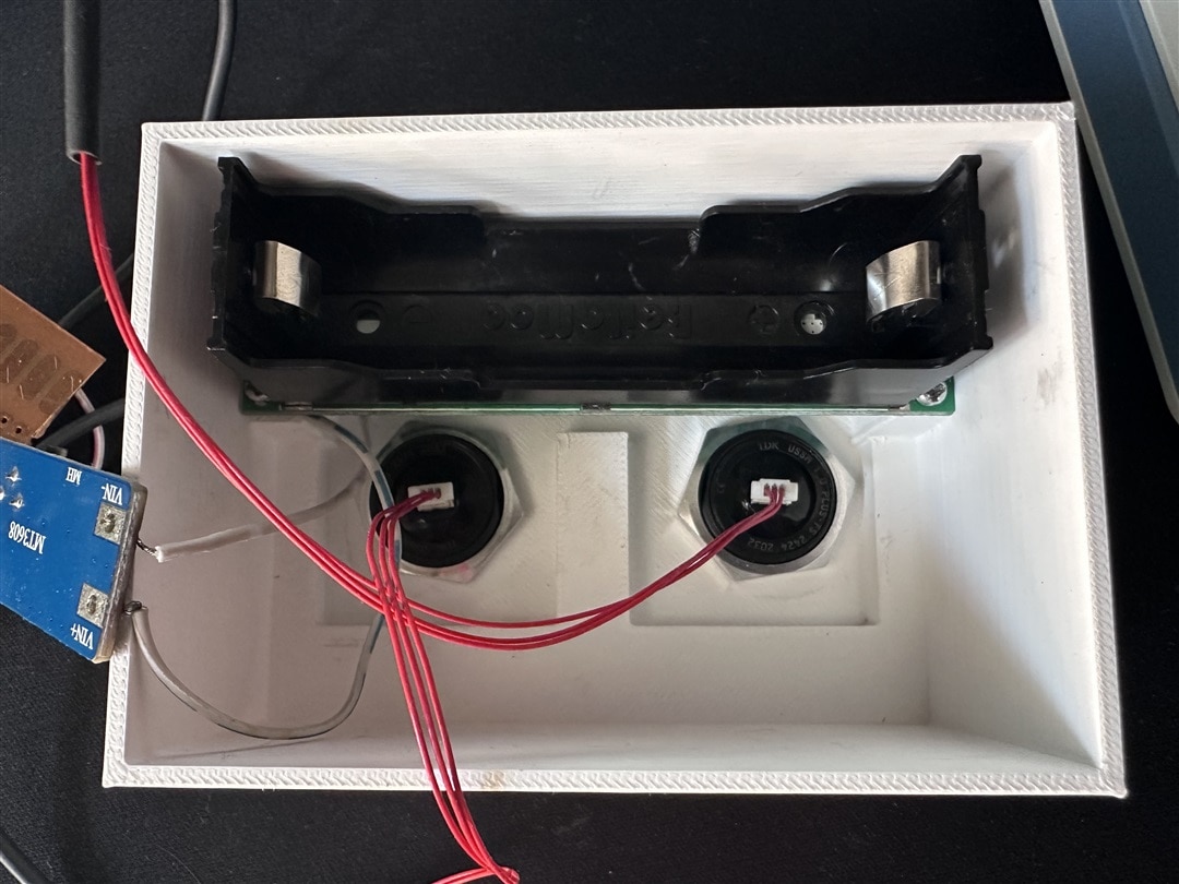

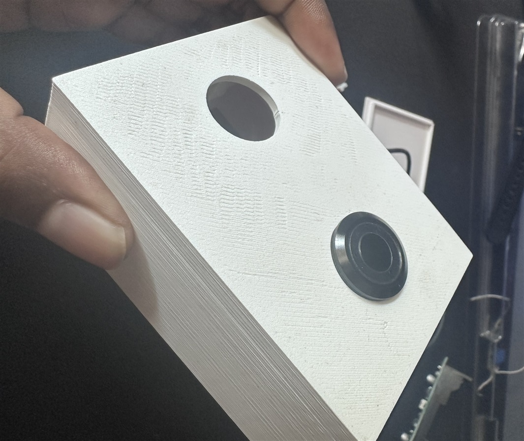

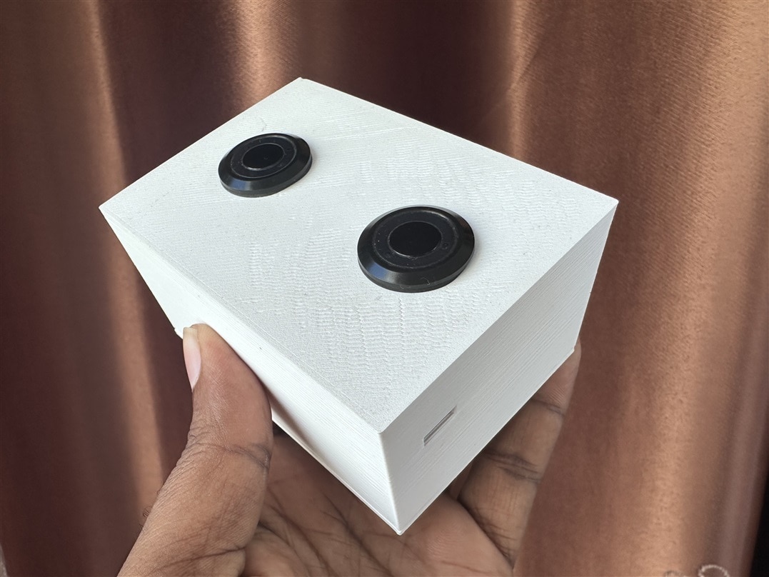

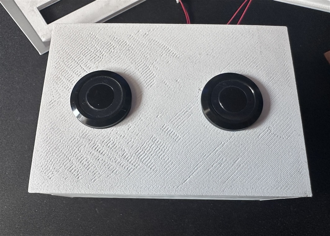

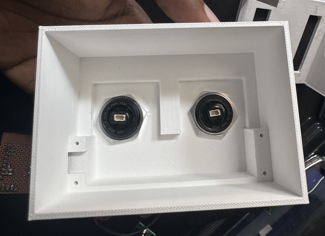

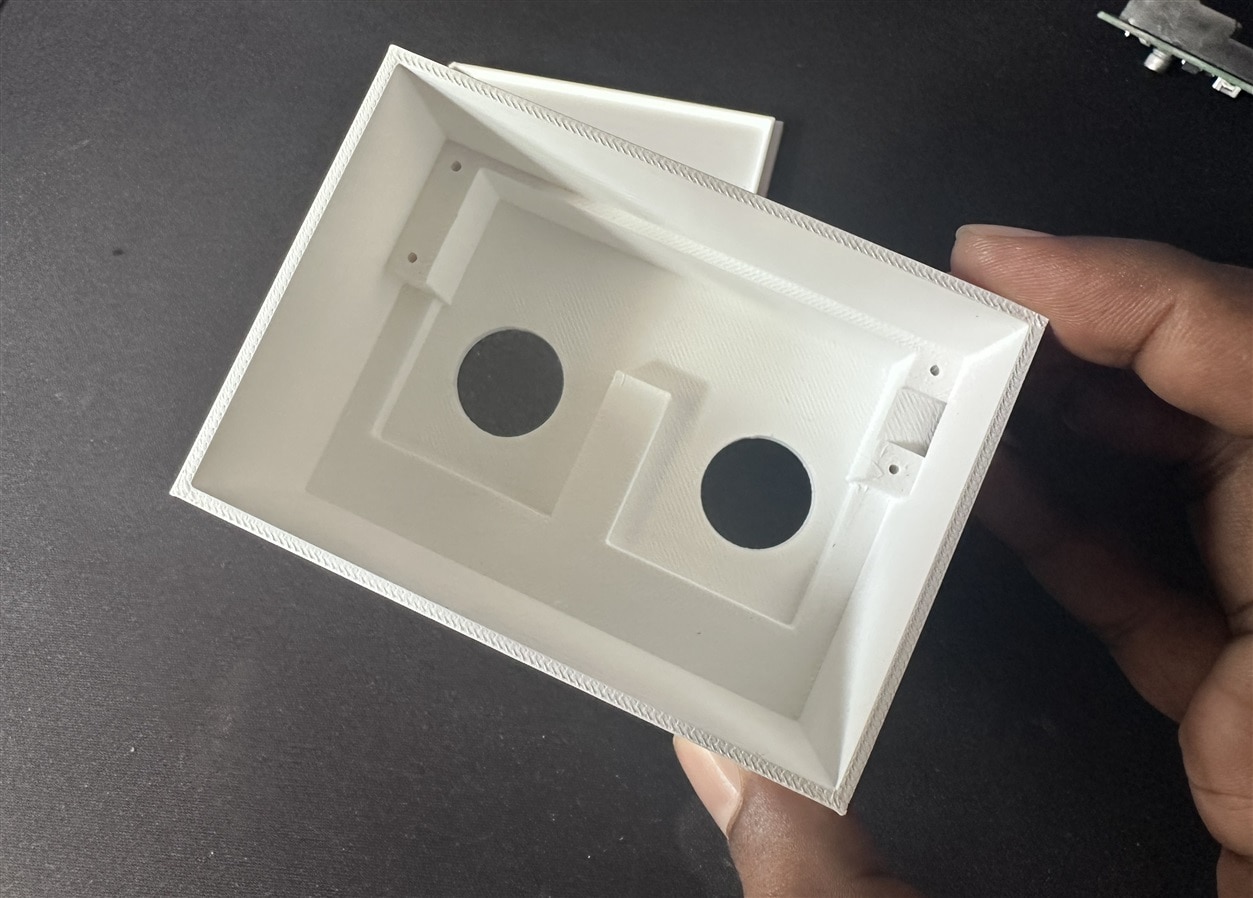

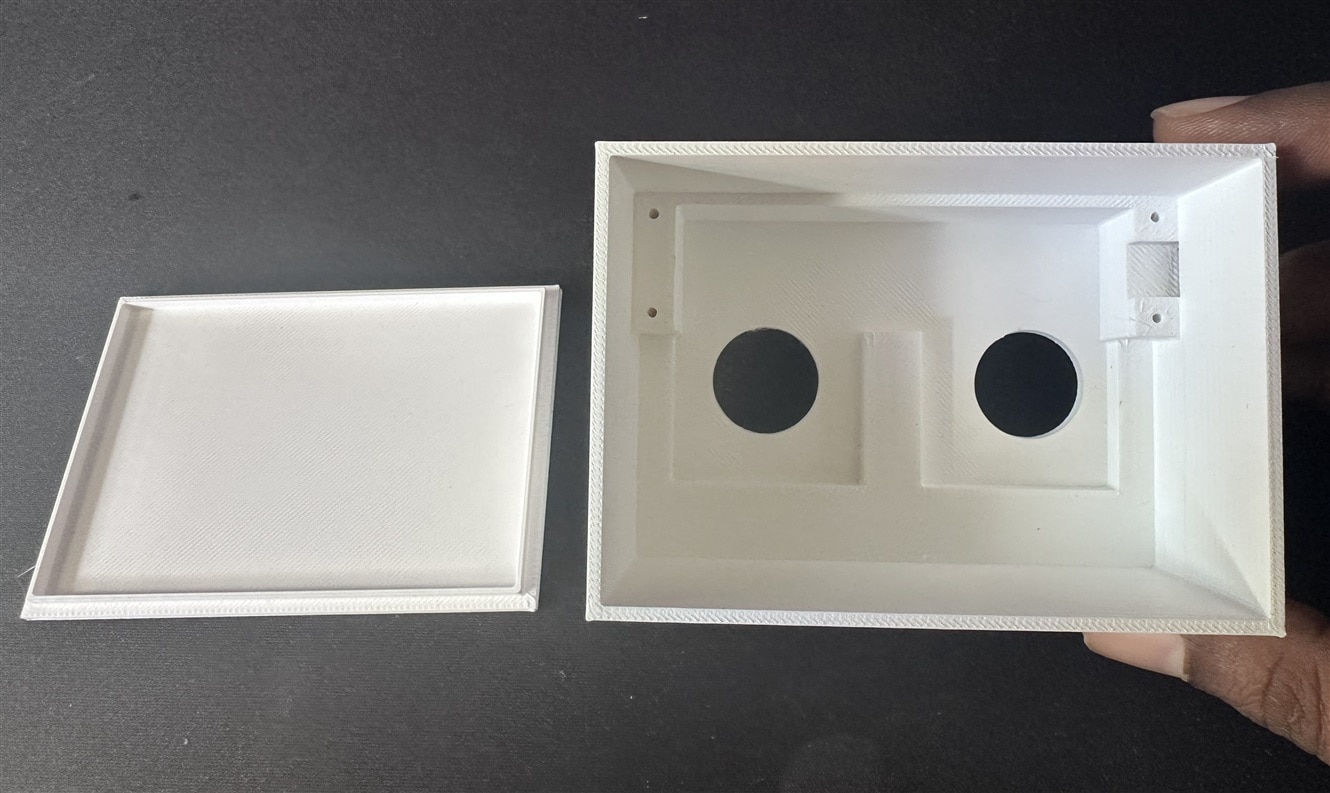

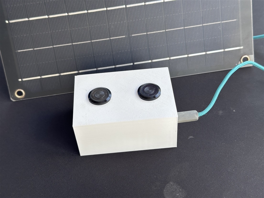

To protect the hardware components, a 3D-printed enclosure was designed, as shown in the following images.
Hardware Connection & Assembly

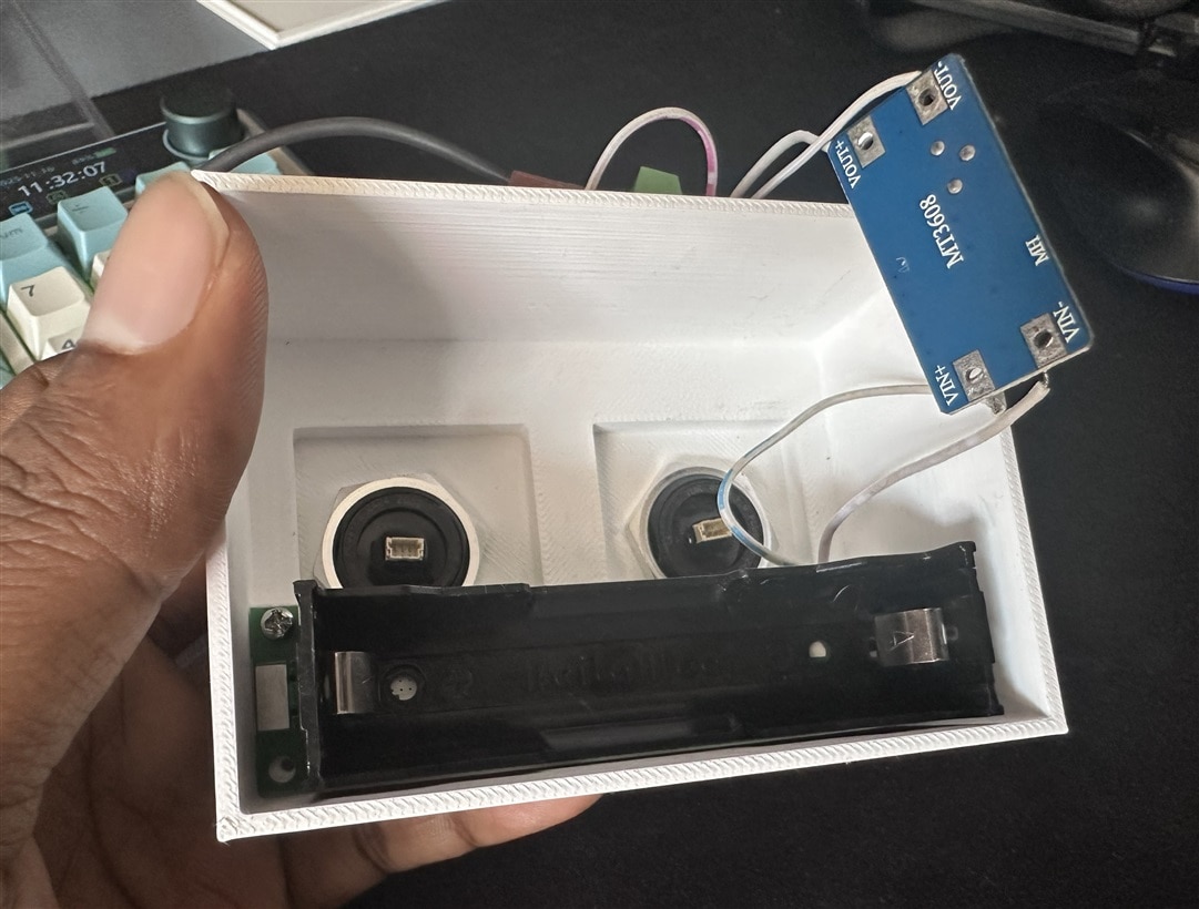

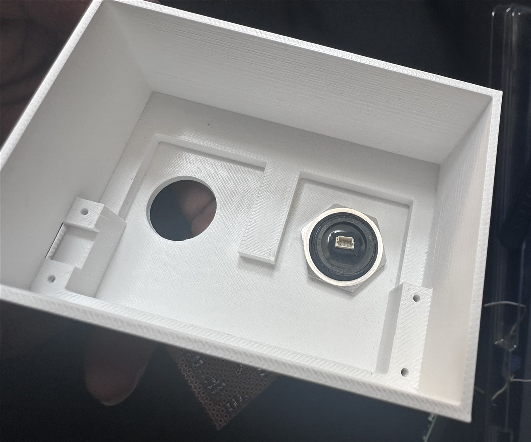

After printing the 3D case, I first add the sensor units in the case using the washers and gaskets that came with the sensors.

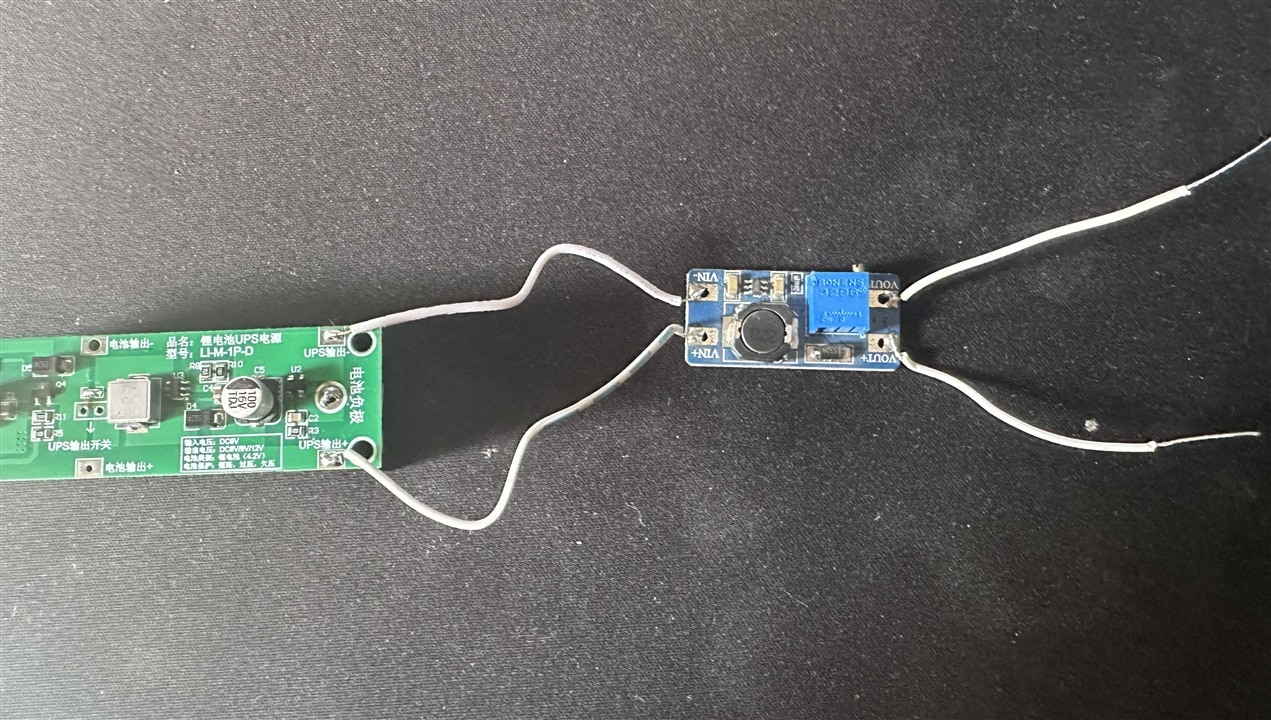

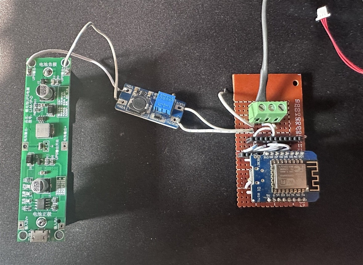

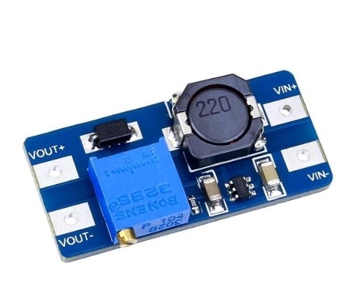

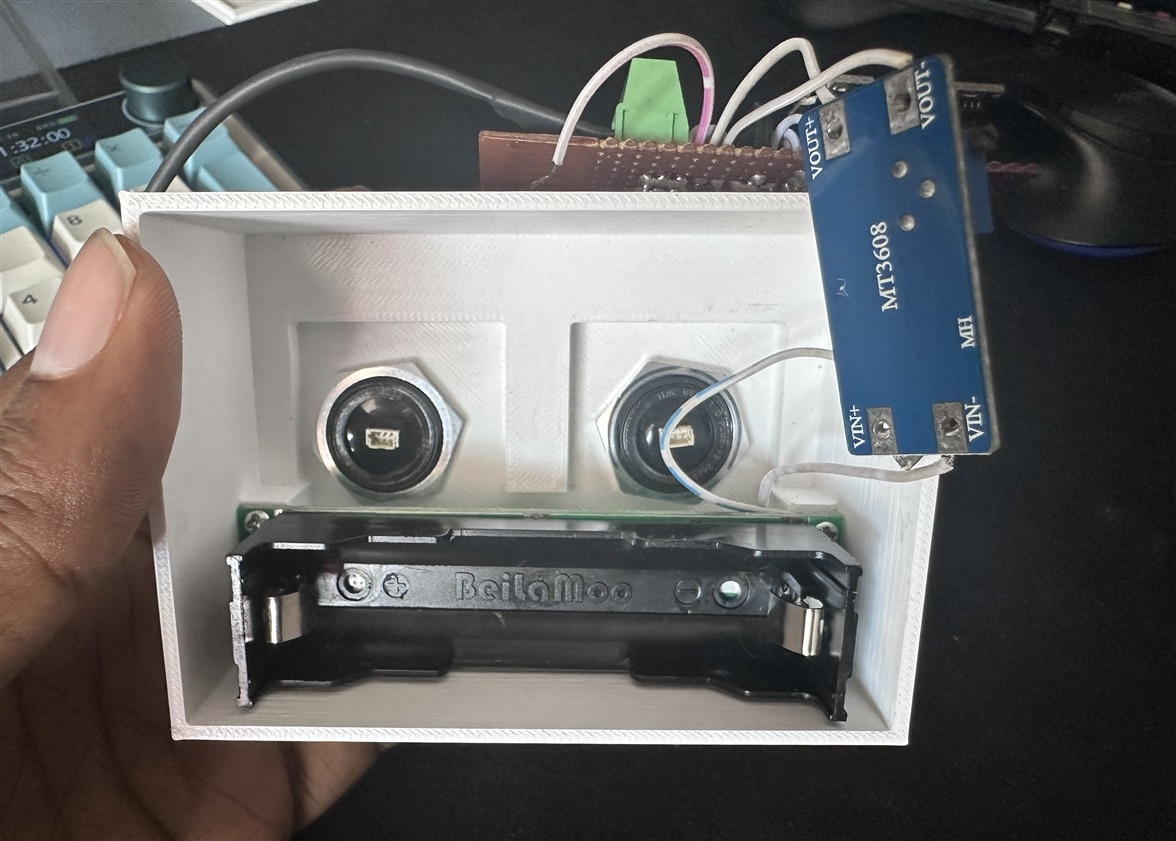

Then, I soldered the MT3608 boost converter module with the UPS module as shown in the following image:
Then I connected the boost converter output to the power supply pin of the sensors.

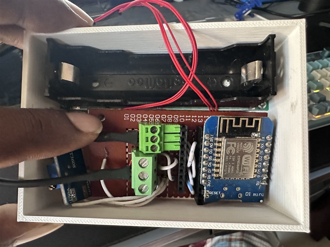

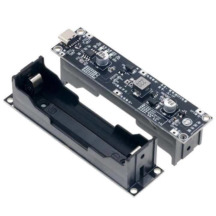

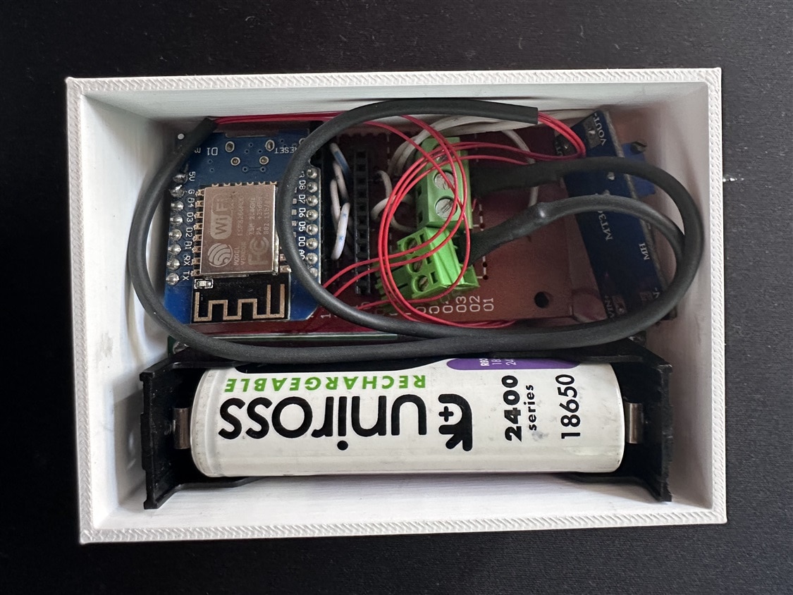

After connecting the sensors, I attached the pre-prepared UPS module (Forum Post #5) inside the case using M3 screws.
Then I plugged the sensor connection cables into the attached sensor.
I placed the ESP8266 board and the boost converter module inside the case.

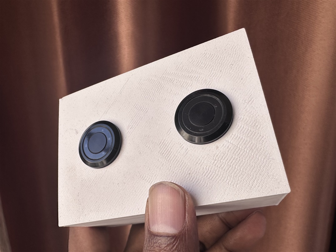

The final unit, after placing the top cover, looks as follows.

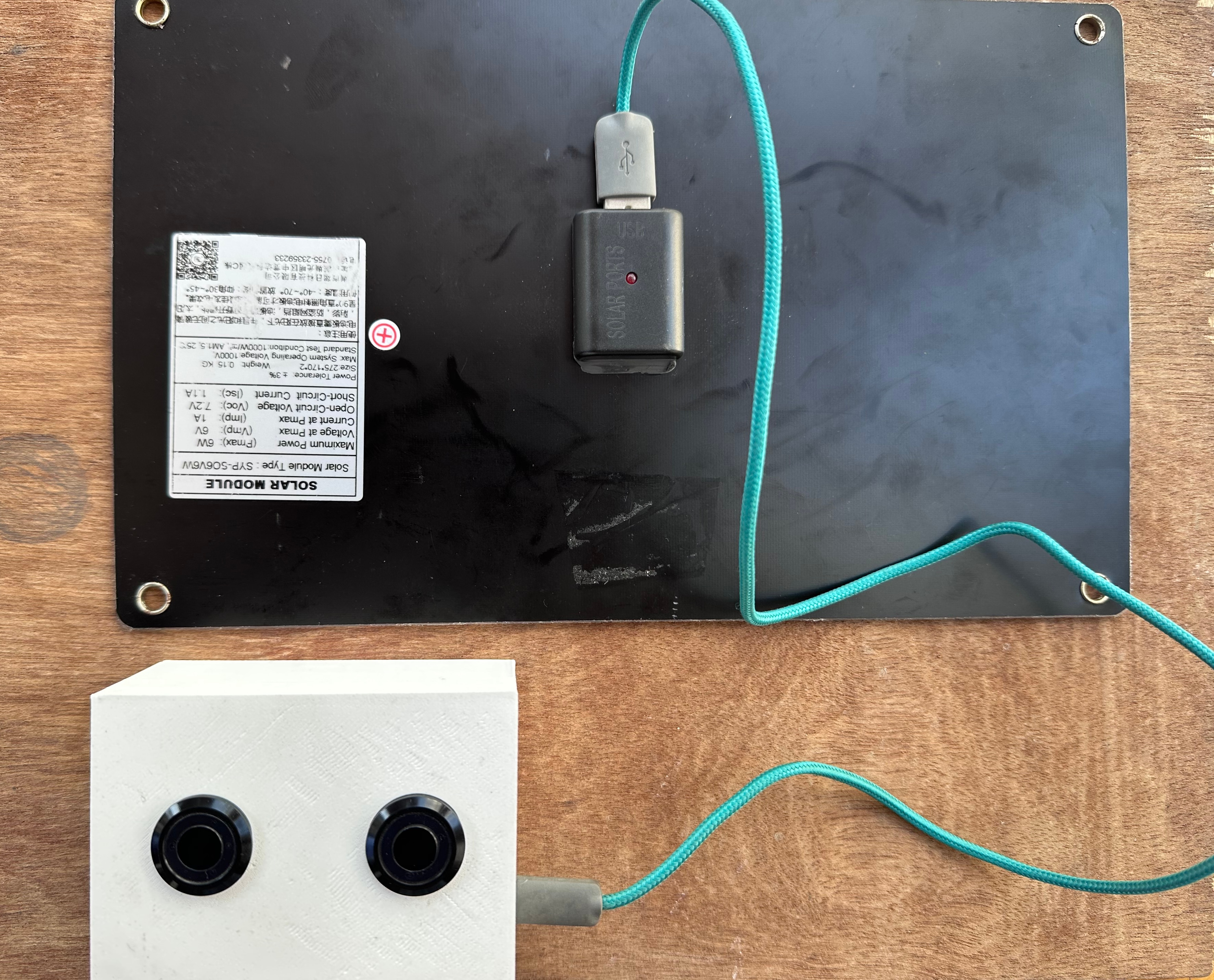

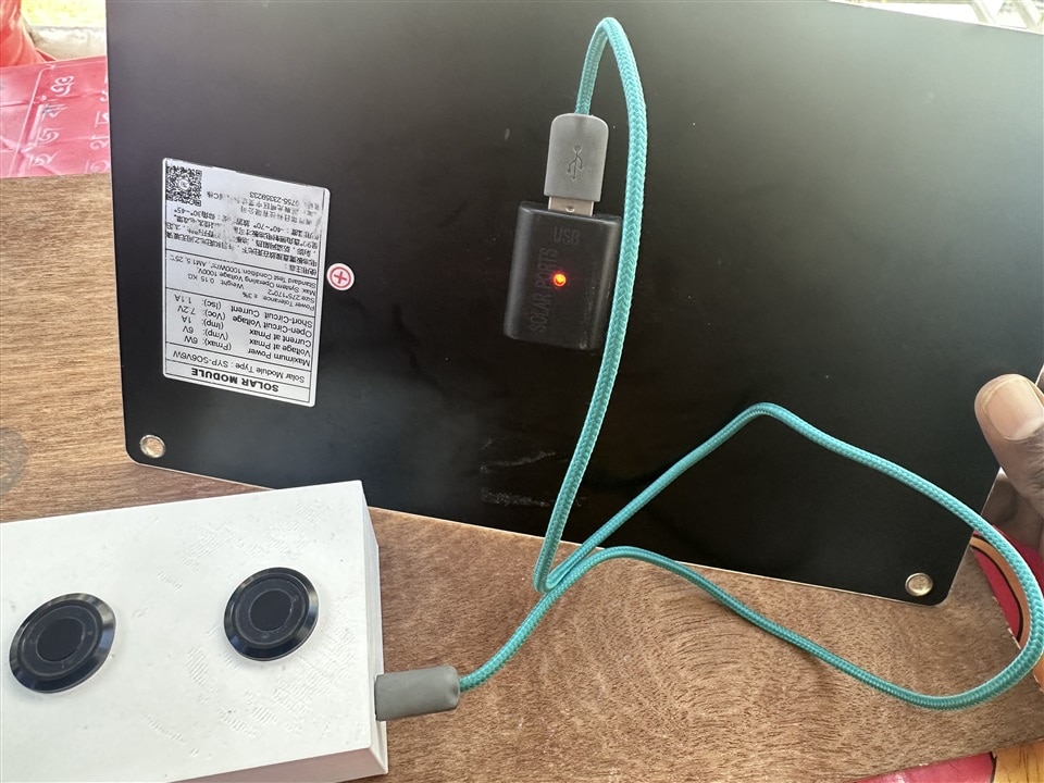

Attaching The Solar Panel
After making the sensor unit ready, the next step is to connect it to the power source (solar panel) and check that everything is working perfectly. I attached the panel with the sensor unit using a micro USB cable as shown in the image below.
The LED lights up when I face the solar panel toward the sun.
The final assembly of my project is as follows:

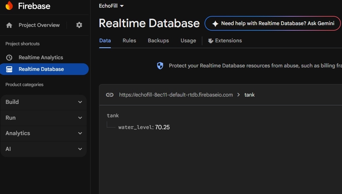

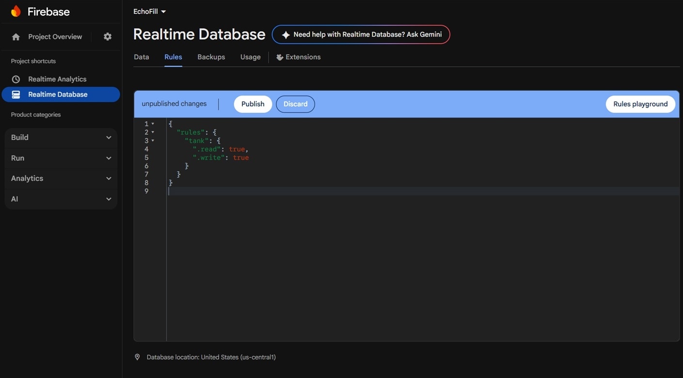

Firebase Configuration
I created a new project named "EchoFill" from https://console.firebase.google.com/ and created a real-time database from the Build tab.
After a successful connection data will be uploaded to the Firebase every minute.
