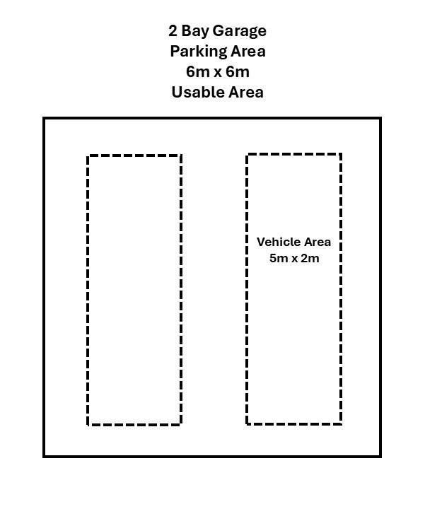

The diagram below shows the usable parking area in the garage and the relative size of my vehicles.  I have added shelving and storage areas that have limited the area to this size which fits smaller SUVs and passenger cars – so no trucks or large SUVs in the future for me.

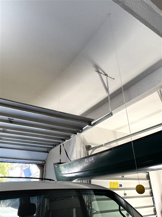

The ball and string method is cheap and fairly dependable, though it occasionally gets stuck.   Another consideration is that the ball location need to be adjusted to correspond with the height and position of the vehicle windshield.

The challenge kit includes a TDK USSM Demo board and 2 USSM1.0 PLUS-FS ultrasonic pulse echo sensors.  The sensors that have a detection range of 18 cm to 5 m when used in solo (independent) mode and can-do close range (4 cm) detection when two or more sensors are used pitch-and-catch mode.  My garage has a usable depth of 6 m and my maximum vehicle length is 5 m, so my parking distance is about 60 cm ( I prefer more clearance in the front of the vehicle).   I will be using the sensors in solo mode to provide independent parking positions for two vehicles.

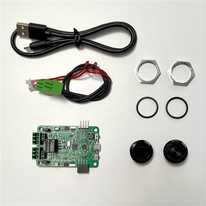

I received the TDK Demo Kit earlier this week.  It includes the components shown below:
  • TDK Demo Board
  • USB-A to micro-B cable
  • Two Ultrasonic Sensor Modules
  • Two sensor cables
  • Two gaskets and nuts
Next step - sensor characterization.
