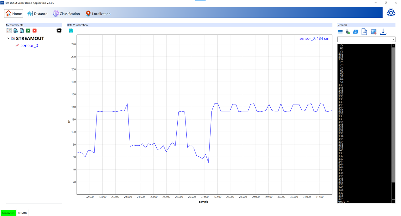

This configurability is a blessing and a curse.  This is certainly not a point and shoot sensor.  I was somewhat surprised when I set up the Demo Kit on my desk, pointed it at a large cardboard panel about 160cm away and got very noisy readings using the Streamout measurement although the average value was correct.  I moved the panel back to 175cm and got similar results.  Here are a couple of short videos of the Streamout plots.
I then decided to try the measurements out in the hallway next to my office and the results were so bad that the average value was not monotonic as I varied the range. Here’s a plot of the sensor pointed at the door at the end of the hall at about 135cm.
I realized that the default threshold and gain settings were not correctly configured for my measurement setup and that I was detecting lots of multipath reflections.

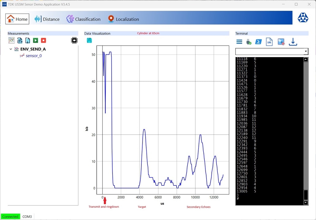

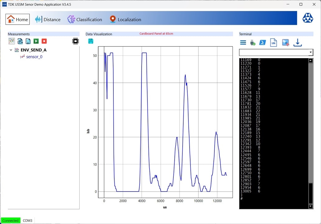

To test this out I used the Envelope measurement which provides an analog measurement of the amplitude and time of received echoes.
Here is a comparison of the Envelope measurement of a cylinder and a cardboard panel at 65cm.  In the initial 1000us or so of both plots you see the initial transmission pulse and the ringdown period (time for the piezo element to settle).  During this period the receiver is clipping.  The target reflection occurs around 4000us and in the case of the cardboard panel the echo is strong enough to drive the receiver to clip while in the case of the cylinder it only has around 40% of that amplitude.  The secondary multipath reflections are also significantly larger for the cardboard panel.  The secondary reflections are also a lot earlier in time.  This demonstrates that if the receiver gain and threshold are set for a faraway target that a near target measurement will suffer from significant multipath noise.  Or if there is no near target it could mistake a multipath echo in its field of view (FOV) as the target.  The shift in time of the secondary reflections shows the effect of the shape and size of the target surface relative to the location of other reflecting surfaces in the environment.

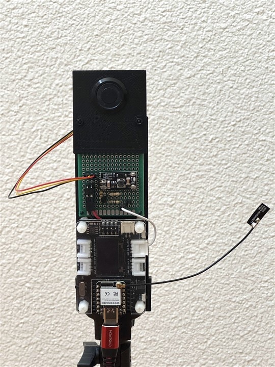

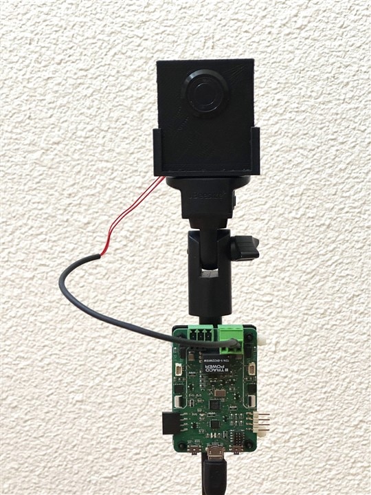

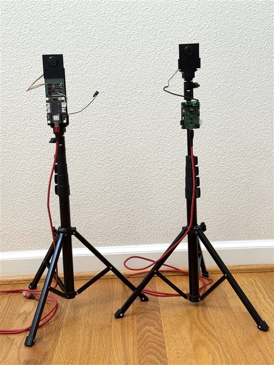

My project target is the front of a vehicle which is not solid or flat, so it is obvious that I will need to do my sensor characterization and parameter tuning in the garage with the vehicle (I’ll ignore for the moment that different cars may have different profiles).  To that end, I built two tripod mounted measurement setups.  The kit has two sensors, and I am doing single sensor measurements, so I have one sensor attached to the Demo Board so that I can leverage the capabilities of the Demo GUI software and I have the other sensor attached to the Xiao ESP32-S3 in my project configuration in order to test my application program.
