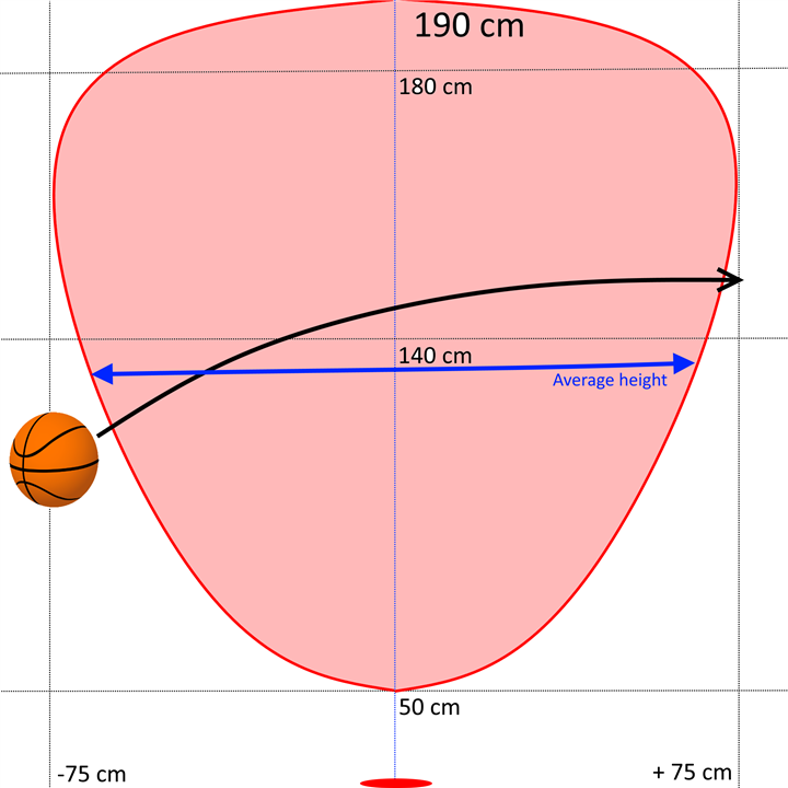

1. Estimate ball horizontal position
As the basketball travels across the area covered by the USSM, we need to correct the measured distance to take into account the horizontal offset of the actual position of the ball from the sensor vertical axis. The sensor does not provide such an information, but it’s possible to estimate the ball horizontal position under the following conditions
  • The ball speed is constant
  • The ball distances are read at a fixed rate
In this scenario, the following algorithm works with a good precision
  • Compute the average height of the ball
  • Calculate the width of the covered area at the computed height
  • The horizontal distance between samples is given by the area width divided by the number of sample

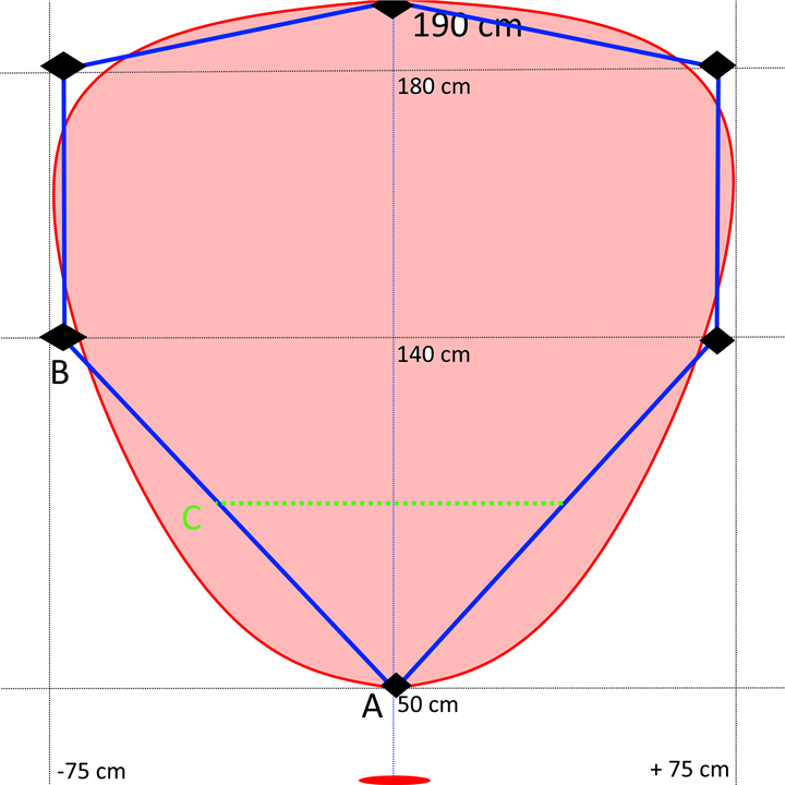

The area where the sensor can detect the basketball is approximated by a six-edges polygon, shown in the following picture
For example, the formula to compute the width of the covered area at a given height “C” is
Where “Y” is the measured distance, and X is the width of the covered area. Solving the equation, we get
2. Correct measurements for horizontal position
Given the estimation of the horizontal position and the distance returned by the USSM, we can calculate the distance along the sensor axis using the Pitagora theorem

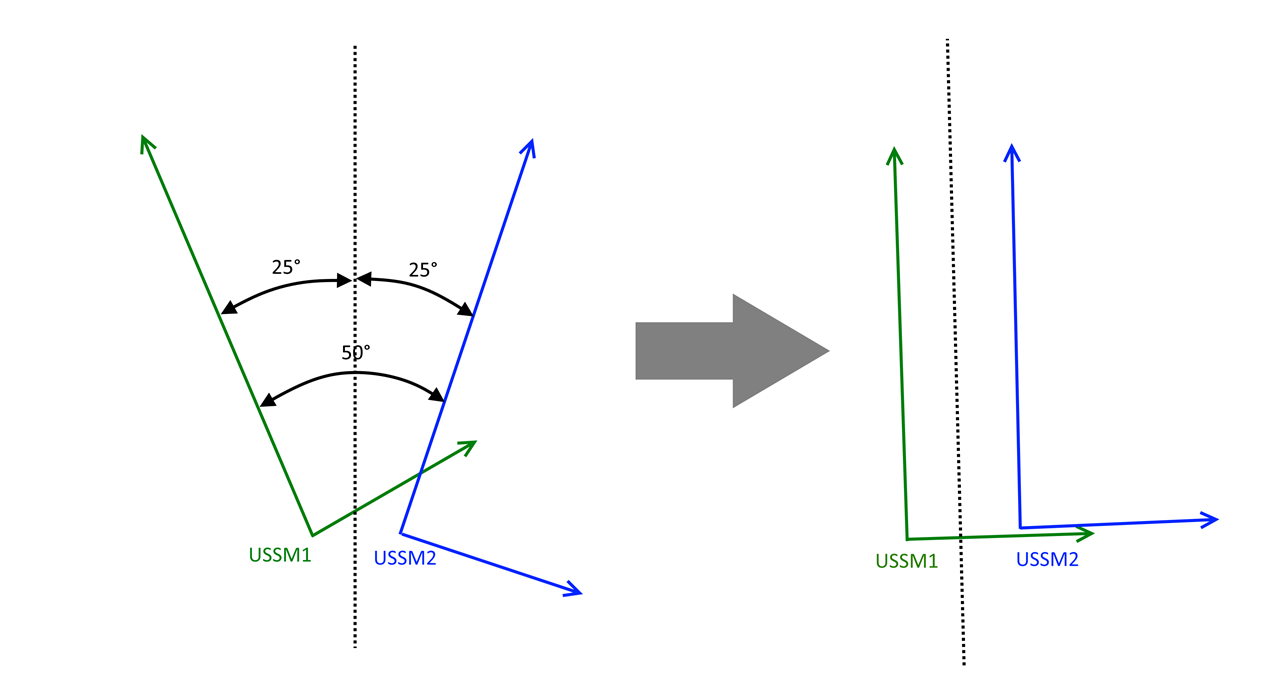

3. Aligning the axis
Samples are taken in two different reference systems, whose axis are 50 degrees apart. To align the axis, we need to rotate the axis 25 degrees clockwise and 25 degrees counterclockwise, as shown in the following picture
To rotate a point (x, y) around the origin by an angle θ (in degrees), the standard 2D rotation formulas are:
Finally, a translation is applied to make the origins overlap
