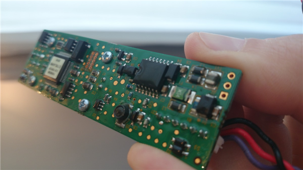

Since I want to have both internal and external sensors for comparing air quality, I decided on a middle-approach. Low cost sensor outside, quality sensor inside, which is also used for calibrating/verification purposes. I’ve spent quite some time on the farnell website, and found an interesting CO2 NDIR Infrared sensor at the reasonable price of £33:
GE MEASUREMENT & CONTROL / GE SENSING  T8031  SENSOR, CO2, 2000PPM
http://uk.farnell.com/ge-measurement-control-ge-sensing/t8031/sensor-co2-2000ppm-18v-to-30v/dp/2114170

My first thought with the T8031 was, "I will reverse engineer their circuit, and modify it, to power it after the voltage regulation with something closer to 5volts".
Great idea :-) if only everything was not covered in black varnish :-P
I should have guess that, by looking at the number of repetitions of the word "patent" in the datasheet :-)
