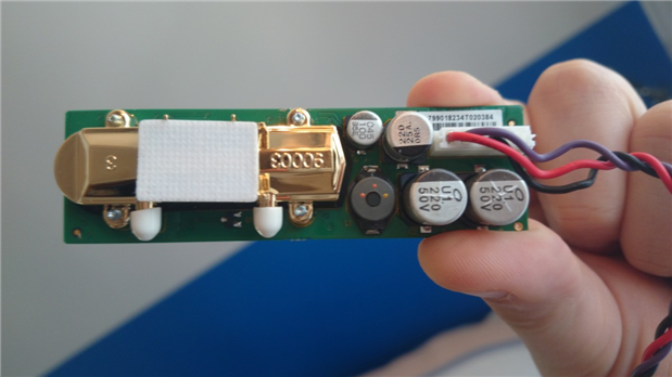

So many sensors, so little time!
Have been studying sensor datasheets all this time to make up my mind on what sensors to use. Found it very hard come up with a meaningful, doable and useful selection. I was tempted to go for a full blown list of these popular, low-cost and popular air sensors: http://playground.arduino.cc/Main/MQGasSensors
You can find them on ebay for a few $ each, and it seems easy to get the readings: http://wiring.org.co/learning/basics/airqualitymq135.html
However I had some concerns about the quality of their measurements. Datasheets are not very detailed, and I have no easy way of calibrating / confirming these readings.
I think one needs a second (quality) sensor as a reference and go through something like this: http://davidegironi.blogspot.it/2014/01/cheap-co2-meter-using-mq135-sensor-with.html#.VJcTNCAIA
Since I want to have both internal and external sensors for comparing air quality, I decided on a middle-approach. Low cost sensor outside, quality sensor inside, which is also used for calibrating/verification purposes. I’ve spent quite some time on the farnell website, and found an interesting CO2 NDIR Infrared sensor at the reasonable price of £33:
GE MEASUREMENT & CONTROL / GE SENSING  T8031  SENSOR, CO2, 2000PPM
http://uk.farnell.com/ge-measurement-control-ge-sensing/t8031/sensor-co2-2000ppm-18v-to-30v/dp/2114170
(last item, it seems its a few years old)
In terms of characteristics it looks very promising and easy to use, for newbies like myself:

I know the input voltage is not ideal for TTL/CMOS stuff but I will try to "boost" things. (Any advice is more than welcome)
Btw there are newer / improved sensors from the same family but kind of expensive for my budget as I went for the SMD rework station.
http://www.element14.com/community/docs/DOC-46395/l/telaire-6613-co2-modulepdf
http://www.element14.com/community/docs/DOC-46394/l/telaire-t6615-sensor-dual-channel-modulepdf
My first thought with the T8031 was, "I will reverse engineer their circuit, and modify it, to power it after the voltage regulation with something closer to 5volts".
Great idea :-) if only everything was not covered in black varnish :-P
I should have guess that, by looking at the number of repetitions of the word "patent" in the datasheet :-)
Anyway, lets continue with the CO2 sensing by the book. I also found someone who has the T8031 running in parallel with MG-135 and looks ugly (probably for the MG-135),  https://xively.com/feeds/1400982654
I don't know if it’s in the same location, I will do my own tests, and in the worst case I will just keep the telaire sensor only.
