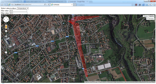

Representing data on the map
In this post I will talk about the representation of data collected by AirMobile on a map. Representing data o the map is the easiest way to understand the locations to avoid when doing outdoor activities. The solution I was thinking of is to draw a vertical line on the map at the position where the sample was taken. The height of the line is proportional to the sample value.

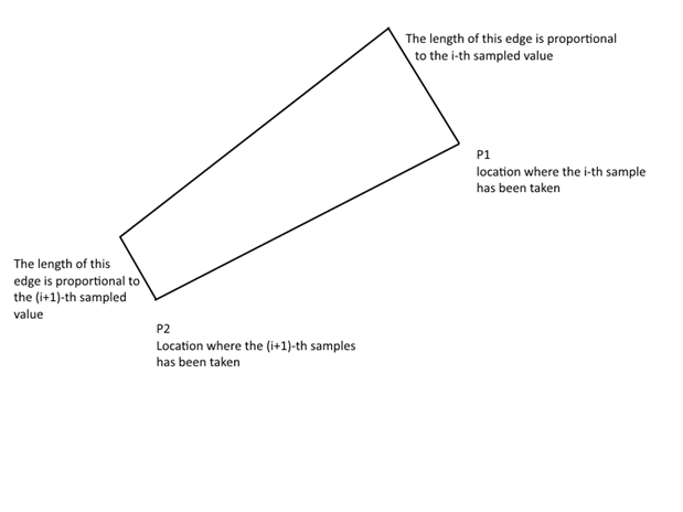

Drawing the polygon
To draw the polygon, some geometry is required. The polygon I want to draw has four vertexes: two are included in the AirVantage's response. The other two points are on the perpendicular line passing through each of these two points, as shown in picture

Screenshot
This is the first version of the AirMobile data visualization page.  To be improved, but the foundations are there...
