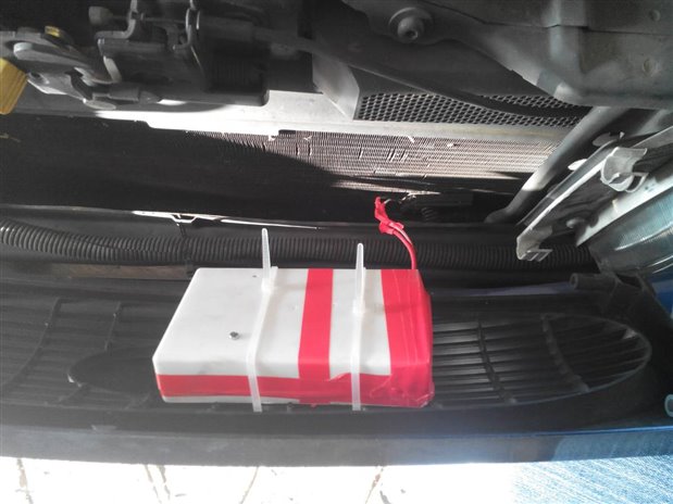

The crucial moment has come: it's time to install the board in a real car
Here is the sensor mounted in the car
The case is fixed to the bodyshell by means of plastic strips. The cell is kept in contact with the radiator using a spring bolt to an existing shell screw...
Installation does not look very professional, but I accumulated so may delays due to hardware problems I has not enough time to study a better way to install sensor on car

    Nice work. Looking good. A couple of minor aesthetic improvements would be to simply replace the tie-wraps with black ones, and perhaps use place insulating tape. But it's functionality that counts. Looking…

    A functional engineering fix is its own reward. DAB

    ambrogio The most common way to safely mount things to the radiator or condenser is to use plastic clips that pass through the cooling fins. You need a piece of rubber between to stop the surfaces rubbing…

    Very nice!  I like how you used a spring coil to hold the Peltier cell. Well done.  From the engineer's perspective, its always function over form. image
