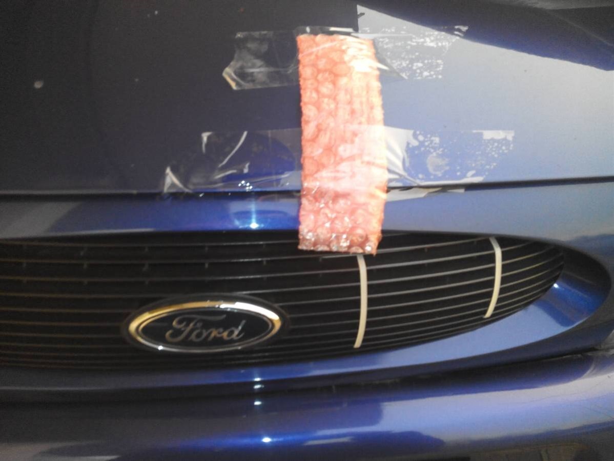

After recording this video, I closed down the bonnet with the intent to go around and collect some data. But as soon as I closed the bonnet, AirMobile sensor disconnected from the smartphone. I reopened the bonnet, and connection was back
The problem was clear, the reason less. I didn't expect the steel of the bodyshell to shield Bluetooth 2.4 GHz frequencies to that extent
In my opinion, the possible causes could be
Antenna / module position: the Bluetooth module was placed between the LaunchPad board and the AirMobile board. While the LaunchPad has a ground plane, the AirMobile hasn't. But the LaunchPad in on the "line of sight" between the Bluetooth module and the smartphone, so the ground plane could actually act as a shield
Bodyshell grounded: the steel the bodyshell is made of shields Bluetooth frequencies more than I expected because the bodyshell connected to the ground. I assumed that the simple equation "tyre = rubber = insulation" is not completely true. I found out that tyre's compound contains a certain amount f graphene (to reduce internal friction and hence fuel consumption) and graphene is a conductor...
High-frequency noise due to sparks: the last hypothesis is that high frequency noise are produced by the electrical system of the engine, in particular by the high voltages involved in generating sparks
Because I was not able to determine the root cause, I moved the Bluetooth module outside the case and placed it directly on the bonnet in a protective bag

    The bonnet earthing or lack of earthing is not the issue with your bluetooth.
    You have a very efficient shield placed inbetween both halves of the bluetooth communication path. (unit and phone)
    Because bluetooth is very low power levels (RF wise), the path loss when the bonnet is shut, causes this issue.
    With it open you were most likely getting a signal from under the rear of the bonnet to your phone, and that gap goes when it is closed.
    The use of an external antenna is probably the only option.
