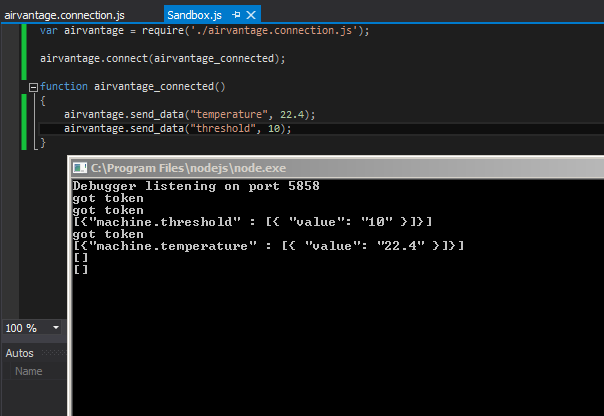

Using node.js
Add the attached airvantage.connection.js file in your workspace.  This particular implementation requires restler, so install it using the npm package manager.  This can be done by typing npm install restler in the bash window.  Once that is installed, modify the airvantage.connection.js file with your credentials.
/* set system credentials here */
var username = "username";      /* username used to log in AirVantage */
var password = "password";      /* password used to log in AirVantage */
var client_id = "use_api_client_id";
var client_secret = "use_api_client_secret";
var serialNo = "SERIAL_NO";     /* this is the SN set when creating a new Gateway */
var connPassword = "CONNECTION_PASSWORD";   /* credential set when creating new System */
/* systems uid */
var system_uid = "system_unique_id";    /* UID found in Systems Details */
var machine_name = "asset_id";          /* as defined in model.app */

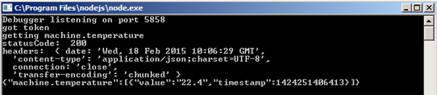

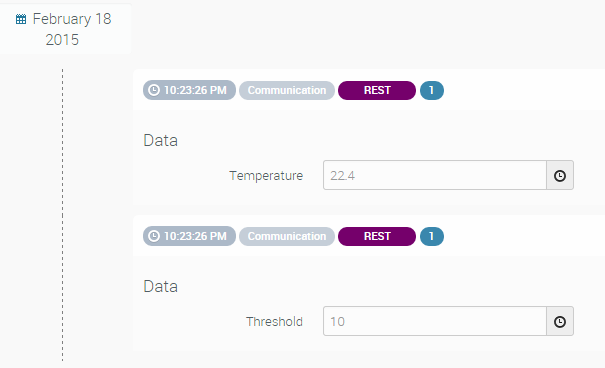

There are three main functions to use this library.  (1) connect, (2) send_data and (3) get_data.  These exported functions are self-explanatory, refer to snippet below on how to use these functions.
var airvantage = require('./airvantage.connection.js');
airvantage.connect(airvantage_connected);
function airvantage_connected()
    /* comment/uncomment lines of code to test */
    /* retrieve data from the AirVantage platform */
    airvantage.get_data("machine.temperature");
    /* upload data to the AirVantage platform */
    //airvantage.send_data("temperature", 22.4);
    //airvantage.send_data("threshold", 10);

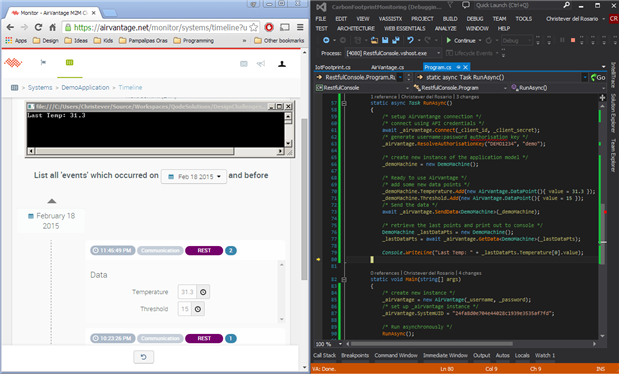

Using C# .NET
This particular implementation is a bit more advance and magical than the node.js implementation.  I created this helper library for use with the planned mobile application. Nice features of this version includes:
  • support asynchronous calls
  • built-in serialization and deserialization
  • portable (just one file) although, it requires references to RestSharp.Portable and NewtonSoft.Json  which can be installed using NuGet package manager
To use this library, add it to your C# project then refer to Program.cs file (as attached) for usage. The key to serialization/deserialization lies within the representation of the AirVantage Application model into a C# class.  Given the sample model.app below:

This has been translated into the following C# class:
[DataContract]
public class DemoMachine : SierraWireless.AirVantage.IAppModel
    [DataMember(Name = "machine.temperature")]
    public List<AirVantage.DataPoint> Temperature { get; set; }
    [DataMember(Name = "machine.threshold")]
    public List<AirVantage.DataPoint> Threshold { get; set; }
    public DemoMachine()
        Temperature = new List<AirVantage.DataPoint>();
        Threshold = new List<AirVantage.DataPoint>();
The important things in this class are, and should be observed when using this library:
  1. Class must inherit from SierraWireless.AirVantage.IAppModel interface
  2. Add [DataContract] class attribute
  3. Add [DataMember] property attribute and ensure that the Name value matches the asset id and data path as defined in the model application.
Conclusion
Sierra Wireless AirVantage data can only be retrieved using REST API.  The two implementations presented in this post are bare minimum but provides a good starting point.
