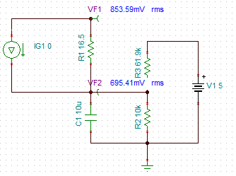

Rburden = Vburden / Isensor = 0.7V / 0.04243A = 16.49 Ω

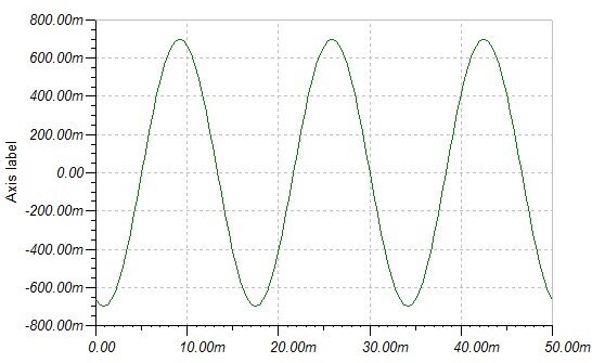

The ideal burden resistor is 16.49Ω, we will use the standard 16.5Ω value for this specific application.  We now have a basic circuit as shown in figure below.  Simulation was ran through Texas Intruments' TINA-TI Spice based program.

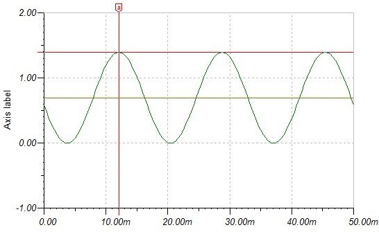

Remember that the voltage signal across the burden resistor is still AC (see right image above), and the ADC is not capable of measuring negative voltage.  So we have to add this AC voltage by 0.7V to make the voltage measurable between 0 and 1.4V.  This can be achieved by adding a clamping circuit as shown below.  The resistor values where calculated using the voltage divider equation to achieve 0.7V across R2 set at 10kΩ.

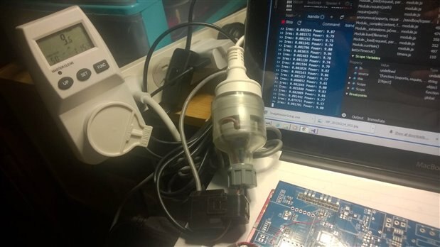

Its just now that I was able to verify this feature.  After some calibration and including the power factor (set at 50%), I got the power usage close enough to match a power meter.  There is a bit of difference but I guess that is caused by the resolution of calculation and that the meter would probably be calculating the actual power factor as well.  Anyways, I think its good enough for now. image
