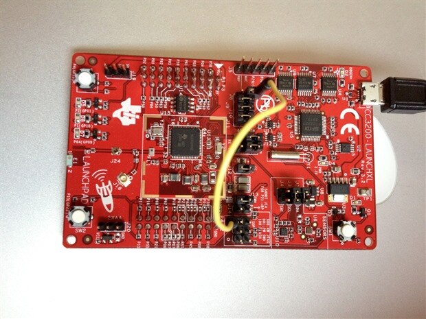

Preparation for the CC3200 to use with Energia. There are few connection setting need to be done at CC3200.
Jumper 8 need to be remove, connection at P1 also need to be remove and make a connection at jumper 8 and JTAG
Picture show connection example.

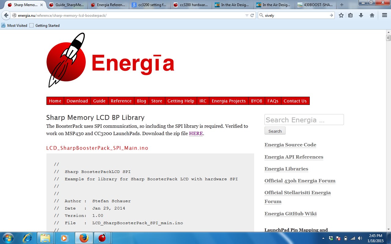

Here just show  the LCD example code to the Energia for CC3200. The given link bellow is the example code.
Link to 430 boost-sharp96 code.Sharp Memory LCD BoosterPack | Energia
Unzip the downloaded folder, place them under related hardware libraries folder.
Picture show the example for the folder location for CC3200. Don't put the code under example folder it will not work.

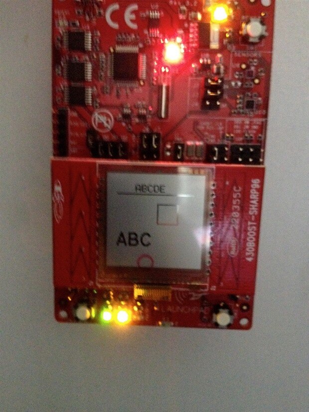

Remove the jumper wire and plug in the LCD module. Power up the board and it should work.
Picture show the example for the LCD display. Sorry for the blur picture image

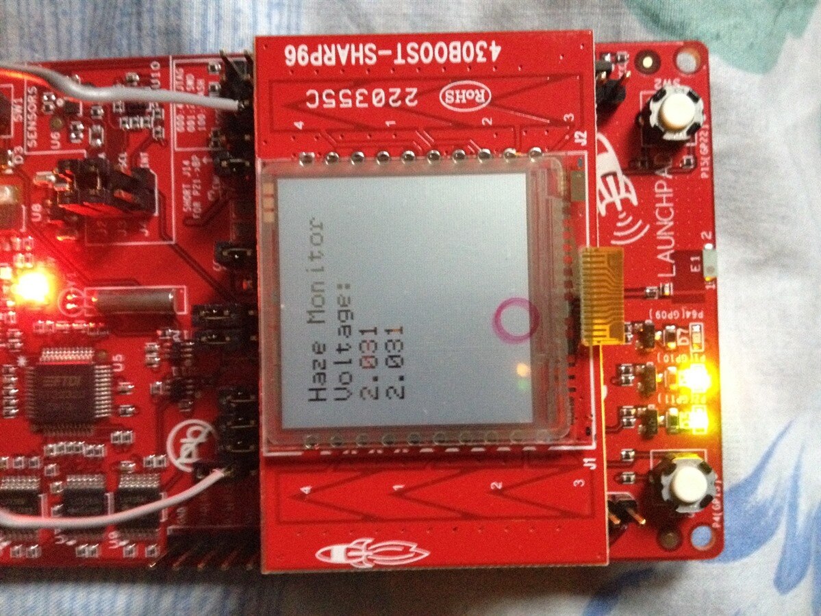

Now stuck with value to display at the LCD. It took me more then 3 days and I still unable to convert the float value to char for the LCD.
I heard Energia is similar with Arduino. Now I realize that there are very different.
Place the code here in case some one can help image.

screen show value 2.031. I have no idea at all where this number come from OMG.

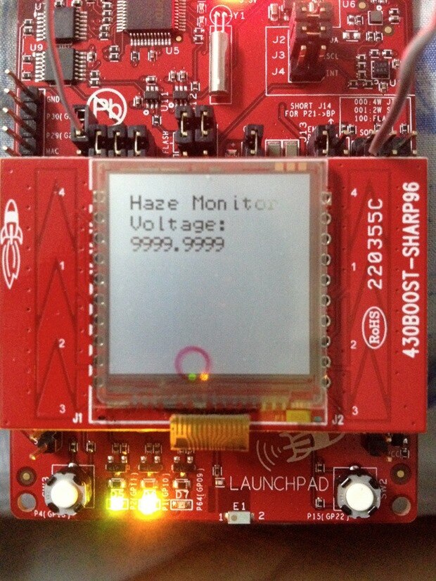

Using the basic function in program to change the float to char(number only). It working at slow speed due to using fix for loop.
This program also just run up to XXXX.XXXX and it should be more then enough for this project.
I will optimize the programing is there is time to do it. For now keep to this first because cannot fine function to convert float to char in Energia.

Picture show the output for the given float value. Play around with some value and the output is still acceptable.
