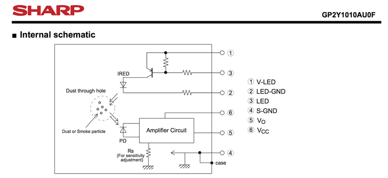

This is a simple dust sensor, it shine an LED light and measure light power or density to determine the dust or particle in the air.
Given picture below show the internal design of the sensor.

They never mention to use different supply for LED and the amplifier circuit. In my case I using same supply 5V for LED and amplifier circuit.

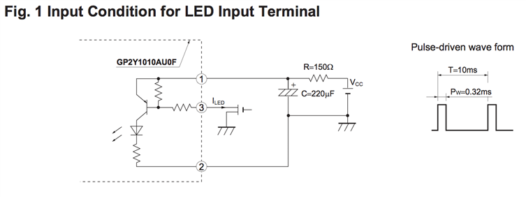

Warning: Please remember to install the 150Ω resistor before power up the LED to prevent damage to the LED.
LED is driving using pulse wave, LED is activated when the input is low. Mean LED ON when the drive pulse at 0v or lower then 2.5V.
You need a digital output or PWM output for this LED drive pulse.

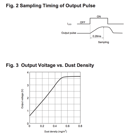

For data it look straight forward. Output of amplifier is analog signal form about 0.9v to 3.5V.
The important is the data taking need to be taken 0.28ms after the on stage for LED to get the accurate data.

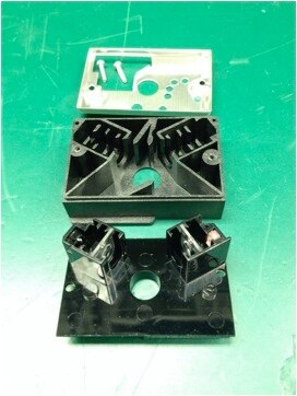

This view is after metal cover been remove.
Here you can see the transistor, amplifier and PCB where all the component been put together.
The metal cover hold by two screw that screw to the plastic housing.
Higher resolution picture:
https://www.dropbox.com/s/a8wual3fe6yeppi/IMG_3677.JPG?dl=0
The last view is LED, photo detector and lenses in black plastic housing. They been arrange nicely to detect the light reflection
Look like this sensor is not design for servicing. Everything is keep hidden inside and lenses also unable to access from outside.

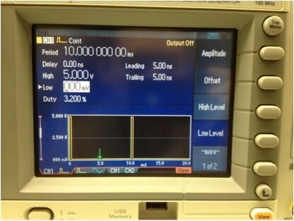

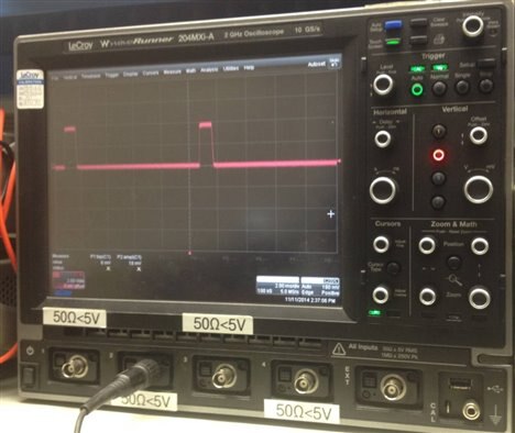

For testing I'm using function generator to drive LED and oscilloscope for output reading and measurement.
Look like a particle counter is needed to calibrate this sensor. The output is just difficult to see from oscilloscope and it come in random unless you put something in the hole image
Vibration will affected the output of this sensor, mean that this sensor is not suitable to use in a vibrating or very hash environment.
The output signal will keep jumping although the LED pulse is not given.
Lighting also will affected the output signal, this mean when there are strong light shine to sensor it will provide some reading.
This will affected data and provide an error data when in the event of data reading.
