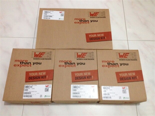

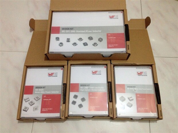

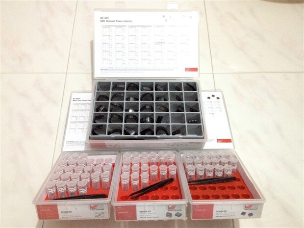

Next is must have Design Kit from Würth Elektronik. They come in nicely heavy duty box and nicely organize container.
With the plus is they also come with anti static tweezers.
I will recommended to all R&D engineer or anyone in circuit design.
Nice and solid box. No affect at all with my 2 year old daughter step on it.
Very good container with information and picture about the component inside.This help a lot when searching for component.
There also prepare a place for tweezers where perfect touch here.
Well design and labeling for all component inside.
Will make use of this when design the DC-DC in future.
Really more than you expect. Nice product recommended to all.

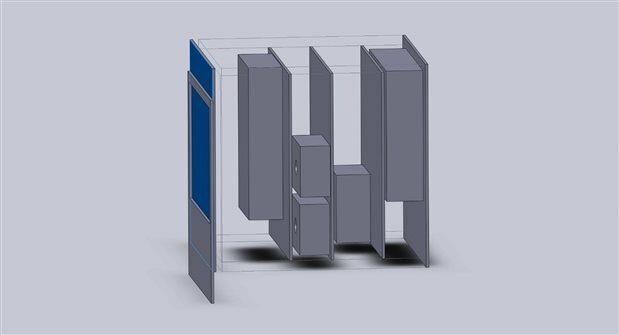

Design:
We do it with cubic image
Design version 1.0.0 with placing all the part in the drawing.
Using multistage concept with each level dedicated for certain part or component. This will make installation, modification, debugging, assembly and other work easy in future.
Plan to use PCB as the base for each stage which can work as support and able to make connection header between them if needed.
Now having some placement issue to bring internal connection out of the box. Maybe the end design in not cube anymore image.
Right now just think of using acrylic or 3D printed nylon for this housing. Please let me know if anyone have suggestion image. Now just plan for local 3D printing service.
Picture show with transference housing to show the inside part. Current dimension is 120mmx120mmx120mm due to 4.3" LCD. But may change in future.
