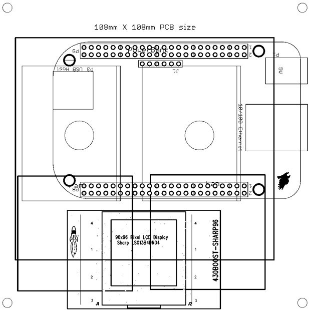

I still follow the previous idea to build device in box and PCB in multistage. In PCB design I will start from ground up. But I will not explain in detail about the workflow. Sorry all, just don't have enough time to make a detail report.
Since I not getting the Eagle V7 pro software, I will using existing software for this PCB design.
The plan is to design one PCB for all. This mean one PCB design support for BBB, CC3200 or MSP430FR5969 and other component.

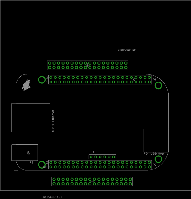

EAGLE CADsoft V7.1
The Eagle V7 is using for the BBB because you can just download the lib from Element 14. For my case I feel that it wasting my time because they have limited space for eagle 7.1 freeware. I cannot place the BBB and other component at the location needed. I don't know what is the size limit for this Eagle V7 freeware but it not support up to 120mm x 120mm PCB.
I also using Würth Elektronik library that also only support Eagle CAD version 7. In the picture show the example the BBB and connector from Würth Elektronik. For those who have interest at Würth Elektronik lib in Eagle V7, can download it at the given link. http://www.we-online.com/web/en/electronic_components/toolbox_pbs/Eagle_eiCan.php
Eagle CADsoft V5.7 (look like very outdated he..he..)
This version not support the lib given by element 14 and Würth Elektronik image. That why I'm using the eagle latest freeware.
Should just draw them in lib. This way will be faster from solving the issue. For Würth Elektronik, I saw they also provide lib in Eagle V4.
You can try this for the older version Eagle.
Picture show other component part in the PCB layout.

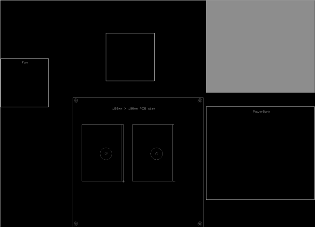

CAM editor
Using to merge multiple PCB design form different Eagle version. image
The picture just show the example merge product. This will not be the final or finish product.
I still need to do some measurement and edit some of the file.
For example the TI 430boostsharp96 have a lot small drill hole. Those hole need to be remove.
The given picture just show the example and explain the method use to solve the problem.
More example with color at higher resolution in PDF file. Please refer to the attached file for more detail. If you want to see them image.

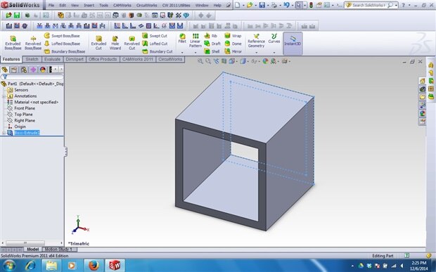

Mechanical Drawing
Mechanical part will be box that cover and hold up everything. It also will be the first expression to user about product or device. So normally it need to look nice image.
It sound easy but when you want to do it nicely and perfectly then it will be different story.
So to make the design then you need to have the part. If you can download the part online then it will make your life easy.
For this case I need to draw them out using the given dimension and measurement dimension. Don't found any information about the 3d drawing for those component.
Tips: If possible please use the latest software to design that can support 3D then you don't need to draw on both PCB and mechanical.
Box
Box design still in progress, I need to finish part drawing then can do assembly process to make sure the box design is correct. This also will help in part assembly, part can be organize nicely and correctly before the box making.
I may try the ECAD for BBB in future. If it work then I have a detail 3D for BBB he..he..
Picture show a box with 120mm x 120mm x 120mm and 10mm thickness.

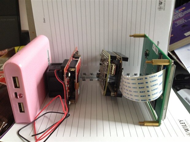

Part and Component
Picture show example of the part that going to use for this project. Will share the information in future.

    shabaz over 11 years ago +1
    Hi ES, Great post!! I love the idea of a board that can combine multiple boards like this. Also it is about time we had a BeagleBone Black to BoosterPack adapter, as you have shown with the 430BOOST-SHARP96…

  • engswee
    engswee over 11 years ago in reply to shabaz
    TQ, Shabaz. Look like we have similar idea. image
    Basically I plan to bring out all the io for this PCB design. So if you have suggestion just let me know.
    And the connection will be 0603 and 0.5 via for now. It might change in future.
