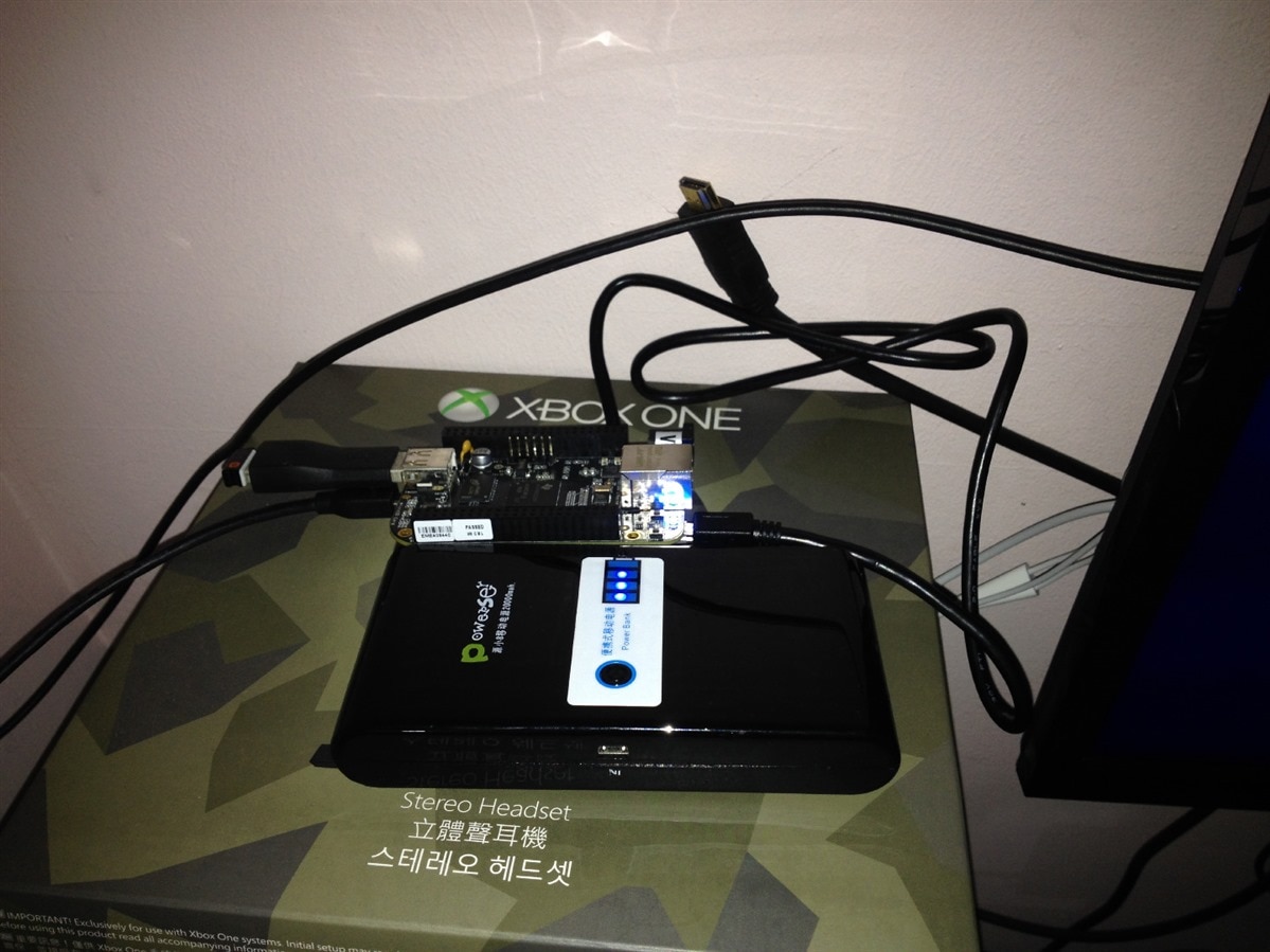

Testing the BBB out of the box. It just working like charm image
Using the cable HDMI D to HDMI A from element 14 (http://sg.element14.com/jsp/search/productdetail.jsp?sku=2127550&COM=drawer-part-list+CMPNULL)
Plug to TV, power it up and it working with no issue. It also working with the DC-DC converter supply from power bank with no issue.
Will going for WIFI connection or Ethernet connection and try for programing in future after finish with the hardware.

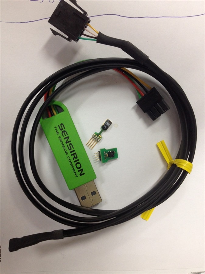

SENSIRION EK-H5 & SHT75:
To the summary for this testing Sensirion EK-H5 + SHT75
Sensirion EK-H5 and SHT75 humidity sensor and temperature sensor is a complete set for testing.
This system only work in window OS. The application call Sensirion AG/USB RS485 Sensor Viewer.
It can be download from Sensirion webpage or by the given link (http://www.sensirion.com/en/products/humidity-temperature/evaluation-kits/ek-h5/ )

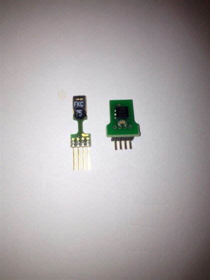

STH75 sensor and SHT2 sensor that come together with the evaluation kit.
Tips: please handle the SHT75 sensor with care because the PCB is small
This picture show the complete set of the Sensirion EK H5 and Sensor. It easy to setup.
There is no polarity for the sensor connection but it do not damage if install wrongly. So don't worry.
Software will show error when the sensor install wrongly. Just flip the sensor and problem solve.

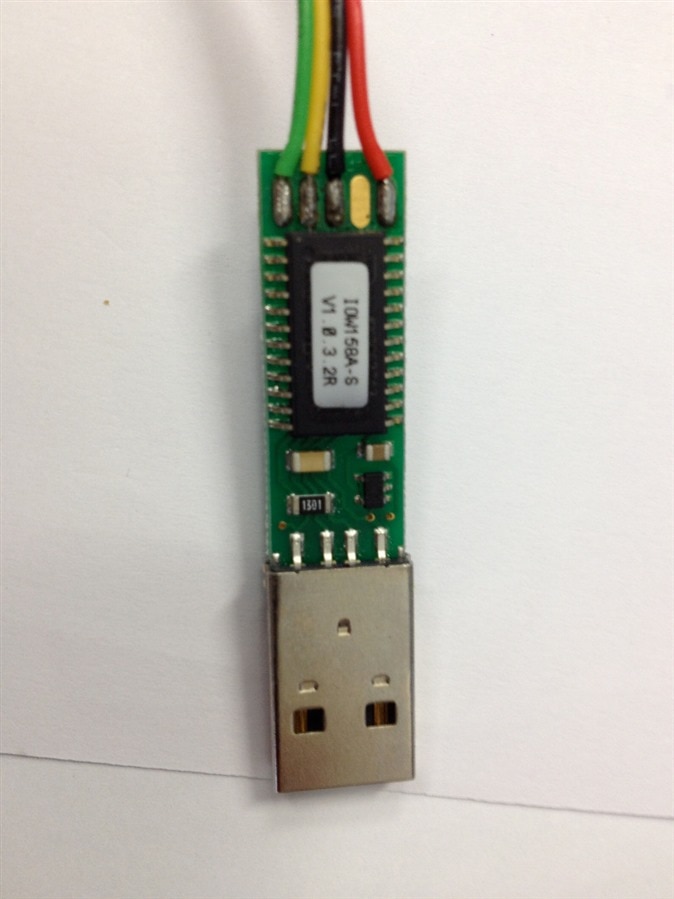

This is the inside look of the USB converter. They using Cypress MCU for this and look like EZ USB Cypress chipset to me.
Almost remove the label to see the chip model he..he.. Maybe will do it if have request image

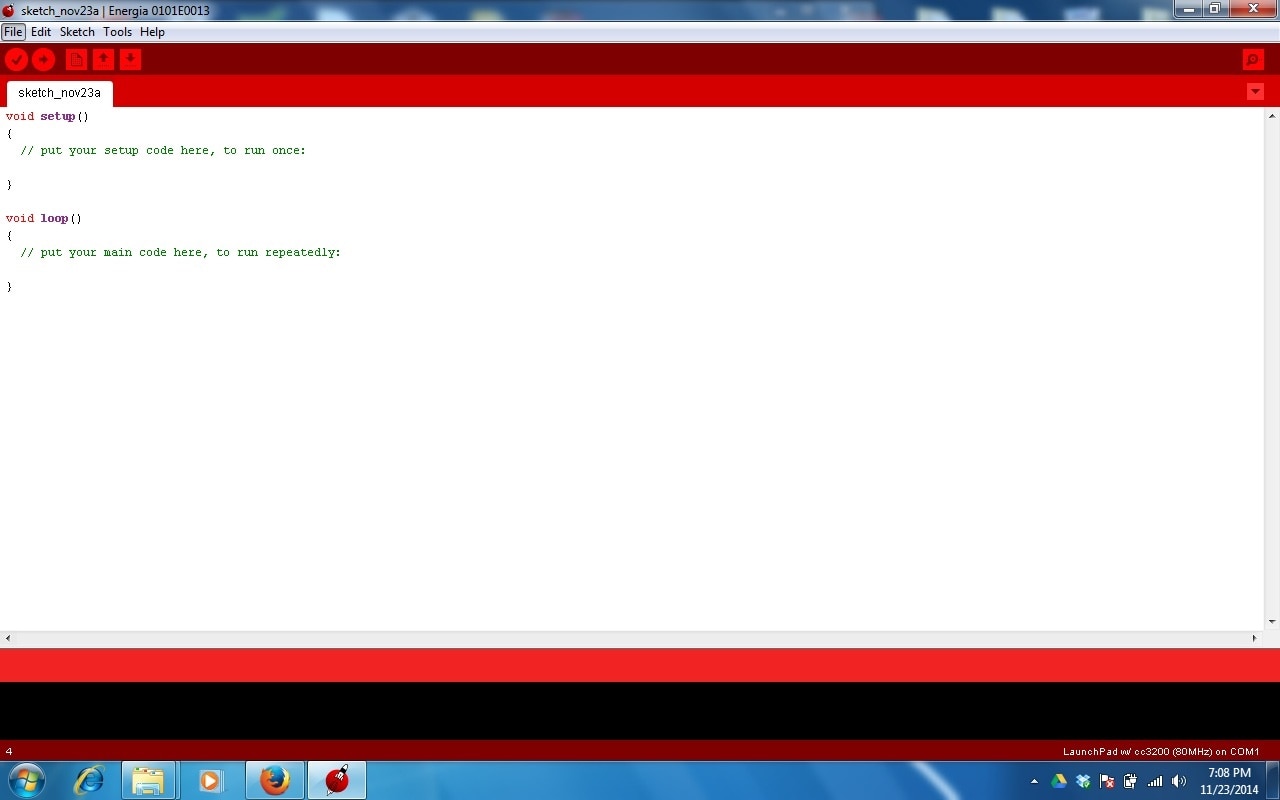

There are few option for BBB, CC3200 and MSP430FR5969. It come with IAR, Energia and CCS

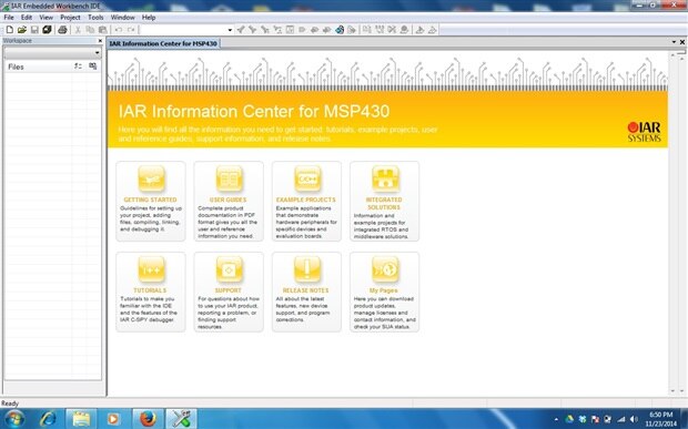

I like the IAR but this one come with size limitation image.
Energia is arduino similar platform. For those who using arduino it will be easy to get use of it.

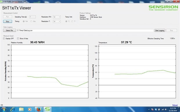

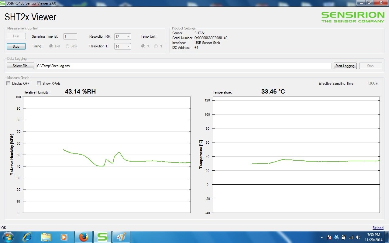

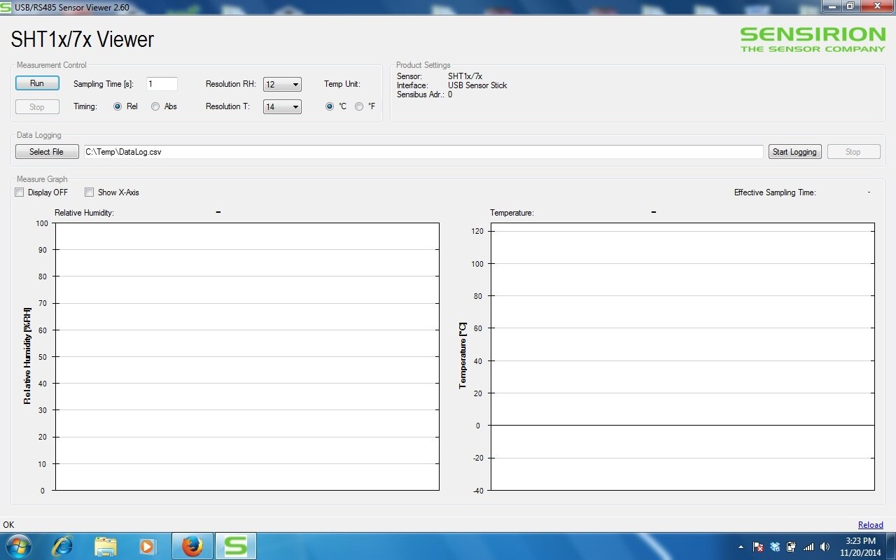

USB Sensor Viewer

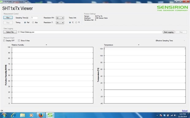

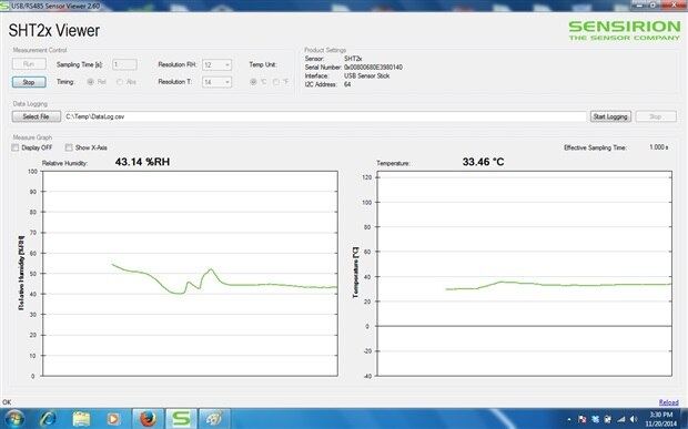

This is the software for the Sensirion sensor. I have tested with SHT2 sensor and SHT75 sensor.

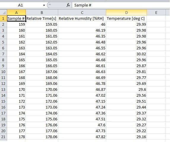

Data also can be log using this software and the format is in excel sheet .csv file.
Picture show the USB Sensor Viewer work with SHT2x sensor.

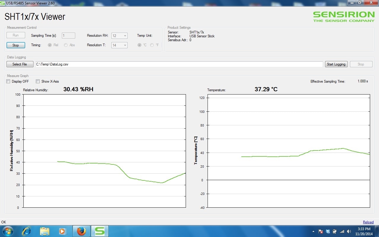

This picture show the USB Sensor Viewer hock up with SHT75 sensor.
Face some issue at the beginning due to wrong polarity sensor install but problem solve when flip the sensor and reload the program (Tips: reload is place at the bottom right)
Taking some data with SHT75 sensor. Sampling rate at 1Hz
Maybe will make a more detail in future for this.
This is the example of data logging taking form the sensor using USB sensor viewer from Sensirion.

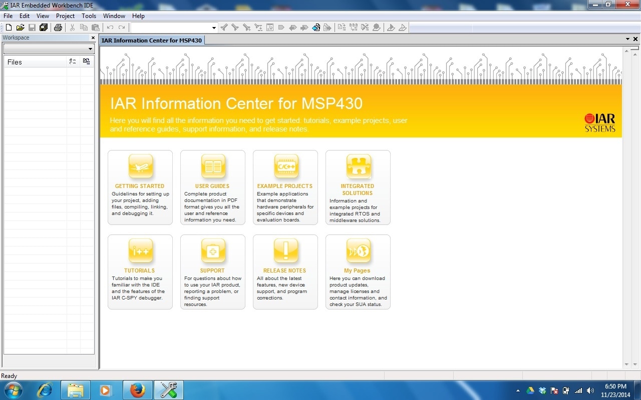

IAR
This is the IAR software for the MSP430 platfrom. This software can only use in Window OS.
Energia
Energia is arduino similar platform. This support OS platfrom and look like the only choice for MAC user.

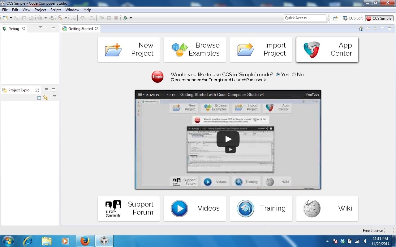

CCS
CCS (code composer studio) from TI. Come with a lot of example and it just run in Linux and window.
This software is design to support a lot of MSP430 family. It will be long story if want to do a step by step for this, I think.
Some information related with the CCS but I think it not support the MSP430 family. I need to go a bit detail to tell about this GUI Composer from TI.
