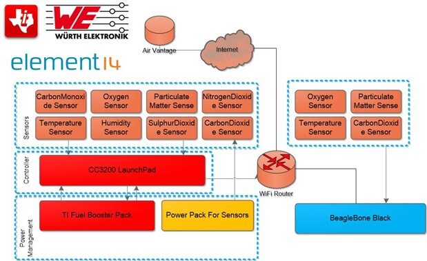

In order to measure the effect of Diwali firecrackers in India, a air pollution analyzer will be designed. It will have sensors for the following:
    1. Air Temperature
    2. NO2 Levels
    3. Single Sensor for carbon monixide, alcohol, acetone, thinner, formaldehyde
    4. particulate levels in the air
    5. Humidy
    6. Carbon Monoxide (CO)
    7.O2
    8. Sulphur based gases and
    9. Nitrus Gasous
The device will be based on the CC3200 which will be powered from the Fuel Booster Pack just like from my design in the Forget Me Not Challenge. It will charge using a solar panel and will also have a secondary battery pack which will be used only to power the sensors. The sensors can be selectively enabled or disabled remotely. It will connect to the Air Vantage Cloud for logging the data in real time. The system will demonstrate the pollution levels before Diwali and the days after. The data will also be collected by a in-building system made up of the BeagleBoneBlack which will also have similar sensors to the outside unit and will also talk to the Air Vantage Cloud.

Lastly I have a quadcopter which I will try and bring into play which will enable me to take air quality measurements at some low altitudes. This will be the more fun part image
