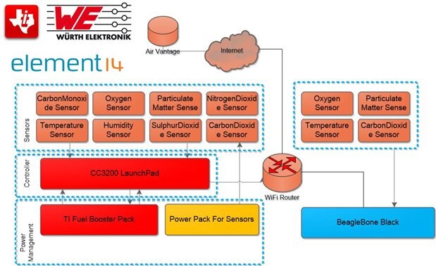

In order to measure the effect of Diwali firecrackers in India, a air pollution analyzer will be designed. It will have sensors for the following:
    1. Air Temperature
    2. NO2 Levels
    3. Single Sensor for carbon monixide, alcohol, acetone, thinner, formaldehyde
    4. particulate levels in the air
    5. Humidy
    6. Carbon Monoxide (CO)
    7.O2
    8. Sulphur based gases and
    9. Nitrus Gasous
The device will be based on the CC3200 which will be powered from the Fuel Booster Pack just like from my design in the Forget Me Not Challenge. It will charge using a solar panel and will also have a secondary battery pack which will be used only to power the sensors. The sensors can be selectively enabled or disabled remotely. It will connect to the Air Vantage Cloud for logging the data in real time. The system will demonstrate the pollution levels before Diwali and the days after. The data will also be collected by a in-building system made up of the BeagleBoneBlack which will also have similar sensors to the outside unit and will also talk to the Air Vantage Cloud.
Work Plan
As with most of my designs, I am working on the functionality documentation in detail and then will proceed with the architecture and implementation. In the allotted three months, I am planing to finish the design in the first two months and have trials in the last month. The last week will be tweaking and polishing the design into a usable product.
The above model will be modified a bit as I have started making changes already and the final system will not be an elaborate design as the one in the previous challenge. The focus is on monitoring air and creating better conditions for living. I am planing to add a particulate matter filter for a part of the house which will be controlled by this system. I will also be bringing to life an old project of mine which used solar panels to power a wireless phone booth. I will be taking the solar charging part from the design and incorporating it into the system.
In addition to the above, I have plans to integrate the system into the "Forget What?" project's OpenHAB for local control.
Lastly I have a quadcopter which I will try and bring into play which will enable me to take air quality measurements at some low altitudes. This will be the more fun part image

    I know the quad will be blowing a lot of air here and there but the smog here is terrible. Its as thick as a wall. I am also looking towards the option for a blimp! a small one with a cord and a motor…
    mcb1 over 12 years ago
    Nice project.
    I'm sure the results will be very informative.
    Whether you can stop the cause or change the chemistry is a different story.
    The comparisons before and after are a good way to show the effects, but something upwind at the time will eliminate any other variables.
    I'd be sticking to the fixed sensors, and leave the quad copter out of this one....image

    mcb1 over 12 years ago in reply to ipv1
    I think this would be much easier to incorporate.
    It also means you can deploy it for an extended period.
    I'd be using a double thether to ensure it stayed and look at using manual fishing reels with a super strong kite braid. (allow for the braid weight in the buoyancy)
    Keep it simple and inexpensive, so you can concentrate on the sensors ,,, we know how quick the end arrives.
