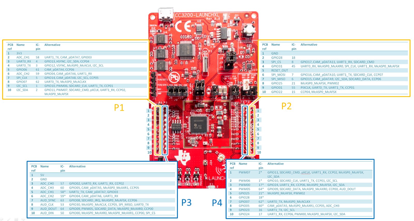

The first thing to do is to find out which pin I can use. The infographic by shabaz sir is very helpful.
A quick look at the datasheet and...
Its clear I can use TimerA0. Using the PinMux Utility, I can easily generate the desired code. Here is what I did...

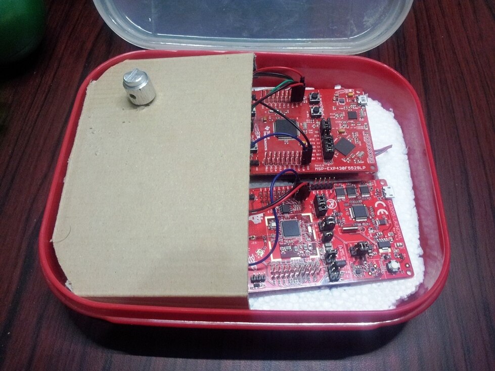

Done! Debug and let her rip! My box looked like this...
