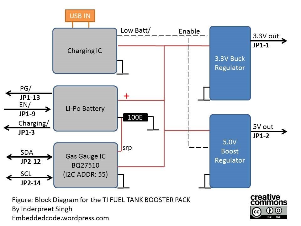

The TI Fuel booster pack can be used as a reference and the block diagram is given below.

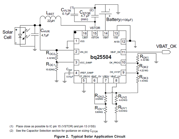

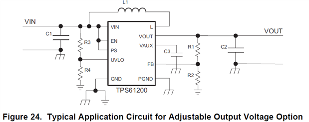

Now we do not want a USB in but a solar panel instead. Also I really have no need to gauge the battery either so thats out too. Instead I will use the BQ25504 to charge the Li-ion battery. In this case, we can also use a super cap like 1farad or so because the Wolverine LP really can work on that. Unfortunately, the sensors use up a lot more power so I left that part for an expansion for later. Next the buck and boost converter and for that we are using the TPS51200 and TPS62740. These generate the 5V and 3V for various parts. Each of these has an enable pin so I can shut them down too. This is our basic requirement and its quite simple. So lets start making the ckt. Eagle!!!!!
The Schematic
There are a couple of ways you can get a reference design but the application circuits in the datasheet are usually good enough. These are shown below.
Thats the BQ25504. Pretty simple...
and the TPS61200

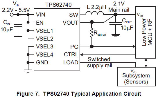

and the TPS62740
I can use these as is but I chose to dig a little deeper. I went on to find application notes for these and the circuits were more or less the same. So I can start making the circuit in eagle? Not so fast... Eagle has a lot of parts but you will need to make these yourself. I did and there are good tutorials on how to make parts in eagle from adafruit and sparkfun. The process is a little tedious but very satisfying.

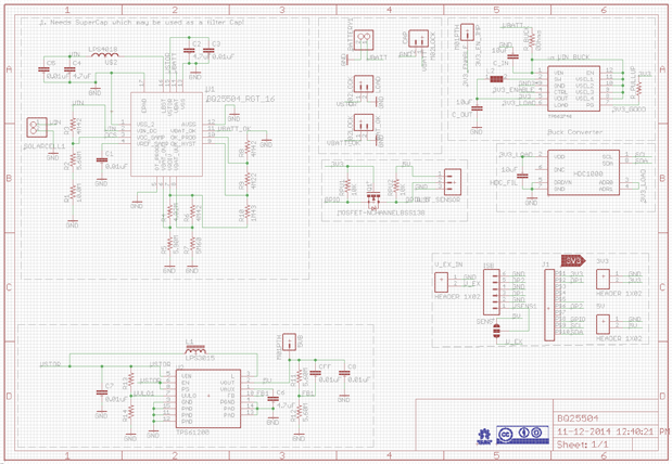

The schematic I made looks like this...
The schematic is self explanatory except for a few things. I added a connector for a sensor module which operates at 5V. Another module is used to interface a different sensor module. I probably should have added a voltage divider to the ADC but I simply missed that actually. That can be rectified but cutting the track and adding it between the connector. There is also a connector to connect it to the LaunchPad but its not a booster pack and I will explain why later.

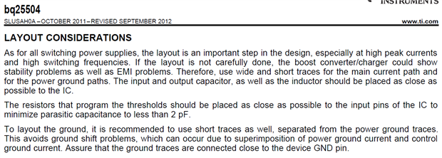

Before your start layout, see the datasheet for layout considerations like...

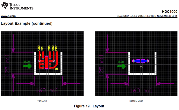

All said and done, you can even find sample layouts like the one for the HDC1000

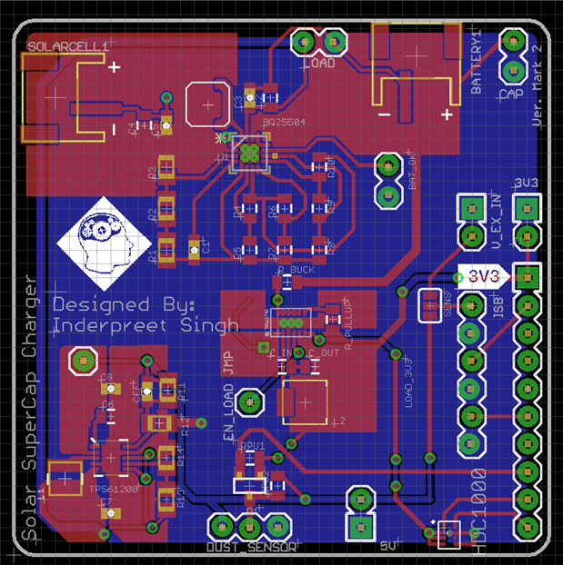

Neat! So my final layout looks like...
Each module was laid out separately and put into place. The thoughprocess is to use the least space but make the layout work. I used the seeed studios fabhouse so they ask for PCB sizes as a multiple of 5cm so I chose the least i.e. 5cm x 5cm. I make the outline 49mm x 49mm and then placed everything in it. The standard booster pack is much larger hence that was out of the question. Another aspect is that I know I will need to make changes later so I want to reduce the cost of prototype as much as possible. And lastly I want this thing to be reusable hence the enable pins, inputs and outputs all have a connector. So I can choose to use each part alone if I want. I ordered 10 of these so they should be useful for later projects as well.
I did NOT tent vias where vias are covered by the solder mask because I usually use these as test points to save unnecessary vias. The rev number is compulsory and I prefer rounded edges. Mounting holes I again avoid for small boards and instead I add single pin connectors(1 pin burg strips) at the corners or use a hot glue gun to make standoffs. image
One more trick is to upload these to OSHpark.com to see the result. I cannot use OSHPark because the shipping plus making is too much.

    I noticed a small difference between our designs so I was wondering am I missing something.
    You feed your buck converter directly from battery rail and your boost converter from VSTOR (Load). Can you please let me know if there is any particular reason for that?
    Shouldn't both of them be fed from VSTOR?
    Edit: Just to be clear, I'm talking about BQ25504's VSTOR.

    The batteries usually work at a voltage of 3.7volts and the buck should be able cut that down to 3.3v easily. I am not sure if applies for this case but the larger the voltage difference between the input and output at a given current draw, the larger would be the energy dissipated... This iabtrue for linear regulators but the similar theory should apply here.
    I did leave a jumper just in case but it should work.

  • tomaja
    tomaja over 11 years ago in reply to ipv1
    Well, I see one thing that might be a problem.
    If you connect buck converter like that, you battery is not protected from full discharge. For LiPo batteries, this means permanent damage.
    BQ25504 can protect your battery from under/over voltage.
    However, I'm not an expert image
  • ipv1
    ipv1 over 11 years ago in reply to tomaja
    There is an under voltage programmable via a voltage divider. Got it covered image
    (R13 and R14)
    Besides I am using a cellphone battery which has in built protection so should not be a problem.
  • ipv1
    On second thought you have a point. I forgot to add an additional resistor divider for the en pin for the buck converter. Anyways I used a zero ohm resistor for this kind of stuff and I will make the correction by hand.
    These are the kind of thing why I make prototypes in pieces with jumpers and small and modular.
    Thanks and nice catch.
