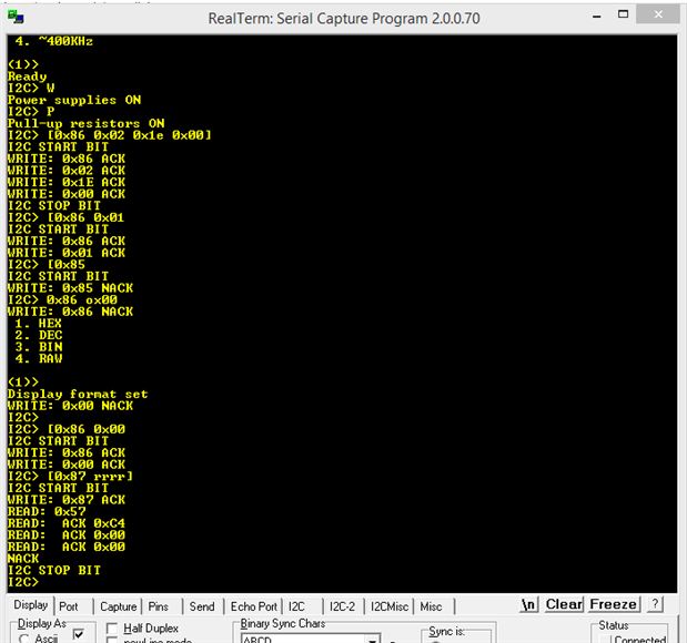

I have been busy with the IoT HOliday Lights project but after its completion, I have jumped right back here. I had the boards manufactured from Seeed and they look good. I will post a progress blog separately, but right now, I need to post about my experiments with the HDC I soldered.
I2C Testing with the Buspirate
This mini article is part of a larger project an I will link to it at the end. For this project, I was required to use the TI HDC1000 and instead of buying a module, I decided to get samples and a make a PCB of my own. This would be great except I had to create the footprints which are almost microscopic! Anyways I got it made from SeeedStudios and I bought one of those ultra cheap hot air stations with no indications about temperature or airflow and some paste and got started. The reflow happened painlessly and I was pretty happy with myself. Before I move on to mounting any other parts, I decided to see if the HDC1000 was alive or had kicked the bucked in my hotair experiment.
So I started with soldering the header as well as power test pins and I hooked up the BusPirate. Har har har! I think I can explain the rest via a video and so...
Reading the Temperature and Humidity
In order to read temperature and humidity, there is a set of commands you have fire at it. You should go through the datasheet but I am going to give you the quick and dirty on reading the temperature & RH. The first thing to do it configure the HDC1000 to take measurements. It is usually in deep-sleep so I need to wake it up and configure it. So I have to send...
[0x86 0x02 0x1e 0x00] Why I send that? Well the 0x86 is the address of the HDC1000 with write bit and 0x02 is the configuration register address. 0x1e & 0x00 is the configuration to write. Next we Trigger the reading by [0x96 0x00 Note that there is no ] at the end which means that I do not send a stop character. Next I send... [0x87 rrrr] Which sends another start of frame and the read address of the HDC1000. We read 4 bytes which are MSB then LSB for the Temperature and Humidity.
Using the BusPirate to get T & RH[/caption] I am getting the temperature but the humidity still boggles me and I think I may have burned it out. I will post more once I test another HDC1000 or someone helps me image Till then,

    Hey! Thanks for the link. I have tried all that and it does not work. I get all zeros prolly because I burned out the sensor for RH. Oops! but I had fun and I am gonna retry with a new sensor tomorrow…

    I'm using the same sensor and I also used Bus Pirate for a quick sensor test. You can read my post here: In the Air Design Challenge - Pollen & Allergen Sensing – Post 6 (HDC1000 Sensor)
    I'm using 0x1000 config value (only bit 12 is set - measure temperature and humidity at the same time with maximum precision). It works fine.

    Thanks for the link. I have tried all that and it does not work. I get all zeros prolly because I burned out the sensor for RH. Oops! image but I had fun and I am gonna retry with a new sensor tomorrow and see if I can make it work.
