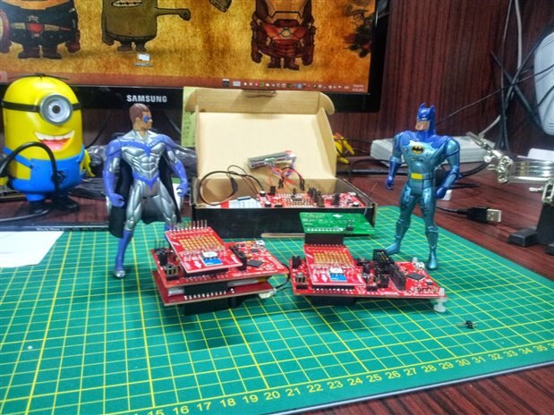

I have the two launchpads setup as follows:
1. Wireless Node with the FR5969 Launchpad and Fuel Booster Pack and the Air Booster Pack
2. Station Node with the F5529LP with the Air Booster Pack
Lets start with some code.

In the above code, instead of Serial, we will use Serial1 which will cause the data to be sent over USART1 which is the Pins on the LP. Thats it! The LED will blink every-time data is received allowing us to debug.
Wireless Node
The code for the wireless node is also very simple, but is a bit tricky since the FR5969 shares PINs when it comes to the I2C and SPI. My problem is that I have the sensors and Fuel Booster Pack talking over the I2C and the CC110L talking over the SPI bus which causes a conflict. The solution is to have a soft I2C which I can just bit bang. I got a library from the 430oh forums but faced some issues with it. The second problem is that the Fuel Booster Pack has the I2C pins on the wrong side hence I need to do a little modificaion as follows.
