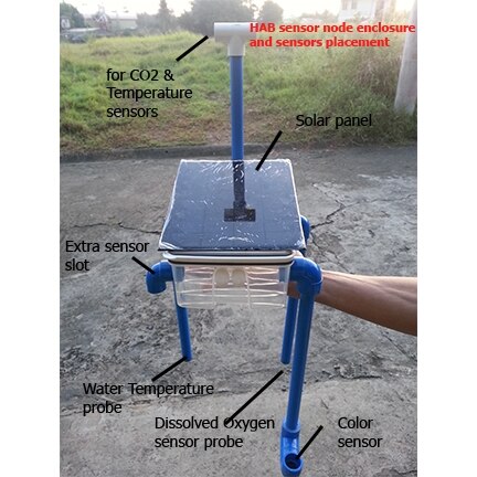

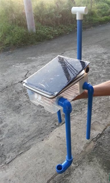

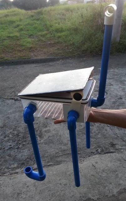

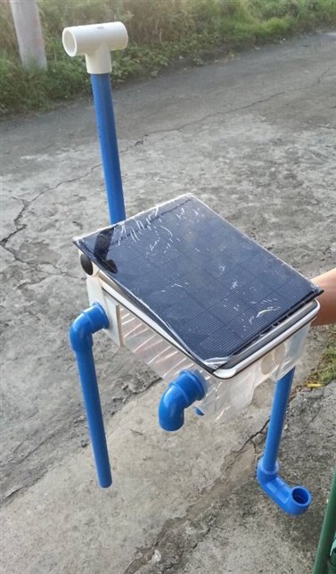

The image below shows my sensor node enclosure. The enclosure is an air-tight box where all electronics ( MSP430FR5969, batteries, C110L tranceiver) will be fixed inside. A total of four PVC elbows with 12 inches pipes are mounted on two longer sides of the air-tight box for sensor probes that will be submerged in the water. Additionally, upward pipe on one of the shorter side is also mounted for the Air temperature and Carbon dioxide sensors. A 5W soloar panel is placed in an inclined position on top of the box. I am still working on the removable holder for the solar panel that can adjusted 45 degrees on the pivot point. This enclosure will be embedded on a bamboo tray before deploying in sea water.
Additional photos of the sensor node enclosure.
image    imageimage
Click this link Ryan Labutap to view my previous post on this project.
    mcb1 over 11 years ago +2
    Ryan If you are having trouble with sealing the upper pipe, you could add a u section so that any water would have to travel upwards before entering. This would ensure that wind blown water is not resting…
    jw0752 over 11 years ago +2
    Hi Ryan, It looks like you are handling the water challenges of your project very well. Will your raft be tethered in position so that the solar panel remains tilted towards the sun? If so, how will your…
    mcb1 over 11 years ago in reply to rmlab +2
    Ryan Have a search for mooring hints/suggestions for yachts. They face similar issues where they are tied and subject to wind and current action as well as the tide. You may wish to know how much the tidal…

    I am currently in Samar mid-eastern part of Philippines where I will deploy the buoy. I'll post some photos of the location within this December.
    Thanks a lot for all your inputs, really appreciate it.
    Ryan
    Ryan
    You may wish to know how much the tidal change is (here it is 2.5-3m, but other places its higher)
    Many wear the mooring lines, and have oscillation issues with certain tide v wind.
    It may be that you moor a bouy, and fix your floating raft to this, so it doesn't tend to get dragged under.
