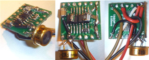

Home-built PHOTODETECTOR
Photodiode can be 1...2 mm active area size. I ordered from Farnell BPX65. I had in drawer older FND100 photodiode and it worked too.
First OP is a transimpedance amplifier. It keeps photodiode input at 0V using the 1M feedback resistor. The output voltage is very linearly proportional to the photocurrent. Photodiode generates negative current on OP inverting input that is compensated to 0V by feedback resistor. So OPamp output becomes positive.
I use Texas Instruments OPA350 that was recommended in the italian paper about dust detection. It is single-supply rail-to-rail OP. Dust produces weak scattered light, so amplifier has to be low noise.
Input noise of OPA350 is 5 nA. One of often used photodiode amplifiers in physics laboratories is OP27 that has twice smaller input noise but requires bipolar power supply.
Note that the OPA350 schematic in the original paper has some mistakes: OP legs are incorrectly numbered and photodiode leg connected to the + input is also grounded.
Circuit has to be fast because the light burst is short. I dimension circuit to some 50 kHz bandwidth that is suitable for taking several consecuitive samples with ADC. It is not practical to use larger feedback resistor than 1 Meg as circuit becomes slow. Better is to add one more OP stage. As a rule of thumb OP DC gain should be below 100 and resistors used below few hundred kOhm.
The circuit self oscilates without the capacitors across feedback resistors. So I added a 10 pF capacitor across 1 Meg and a 100pF capacitor across 100k. Low pass filter is dimentioned for 1M+10pF=100k+100pF=100kHz.
At output is a high-pass filter to eliminate continuously scattered light and 50 Hz. 10k+100nF=1ms=1kHz.
Circuit diagram is drawn using  Eagle. Both opamps are assembled on a small SSOP chip breakout board. See the photo. The amplifier board is covered with insulating tape and aluminum tape for electric pickup shielding. Photodiode is fixed 3...5 mm from the beam. Position is not very sensitive.
A thing to try: photodiode in a plastic chip with built-in preamplifierTexas Instruments OPT101P-J. But need to check noise specs first

    "It is not practical to use larger feedback resistor than 1 Meg as circuit becomes slow." Try using an attenuator in the feedback path rather than a single resistor.

    Thanks for a tip for integrated sensor TSL254R. I opened datasheet and saw that it  has a 1 Meg transimpedance resistor.
    My collegues use OPT101 chip for photoplethysmography (optical heartbeat detection\). It also has a 1 Meg transimpedance resistor.
    Texas Instruments OPT101P-J . MONOLITHIC PHOTODIODE AND SINGLE-SUPPLY TRANSIMPEDANCE AMPLIFIER.
