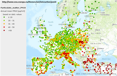

Fine dust regulations and situation in Europe
As a fine dust are called particles smaller than 10 microns in size PM10. Generally, the smaller are the particles, the deeper they can penetrate into lungs. WHO suggests limit of 20 ug/m3 averaged over year. EU limit is double as high 40 ug/m3 which many experts critisize already for longer time. Studies show that exposure to particulate matter  leads to increseased lung cancer risk rougly 1% for every 10 ug/m3: "Outdoor Particulate Matter Exposure and Lung Cancer: A Systematic Review and Meta-Analysis"
Particulate Matter (PM10): annual mean concentrations in Europe  —  European Environment Agency (EEA)
SPIEGEL article describes that values are above threshold, for example in German cities Berlin, Munich, Stutgart.
Feinstaub-Prognose: Die schmutzigsten Städte Europas - SPIEGEL ONLINE
