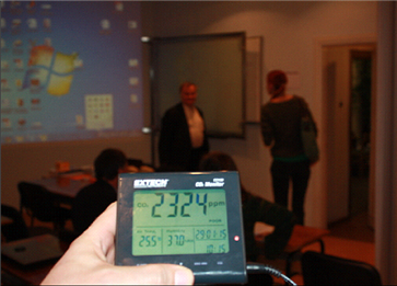

EXTECH indoor air quality monitor model CO100 from Farnell is a great thing to have!
I tested the device during a lecture with ca 20 people. CO2 concentration raised to 2200 ppm after 50 minutes. During the next lecture one window was open to have a ca 10 cm gap and the CO2 concentration stabilized at 1500 ppm. This shows the importance of reasonable ventilation. After the lecture there were questions from attendants who asked what the device is doing and what it costs.

By blowing into the Extech analyser I easily reached the maximum reading of 9999 ppm and the device became saturated.

    It's no wonder students are drowsy!

    I had not thought about CO2 causing problems in class rooms, but your readings clearly show a potential cause for ADD! image
