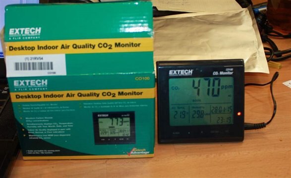

EXTECH INSTRUMENTS  CO100  METER, CO2, 9999PPM, 99.9%
197,71 €
http://de.farnell.com/extech-instruments/co100/meter-co2-9999ppm-99-9/dp/2081081?ost=co100&categoryId=700000005821
I will use this near-infrared non-dispersive type CO2 sensor to compare with electrochemical CO2 sensor module. NDIR sensor is callibrated against NIST traceable device, accuracy 75ppm or +-5%.
Good <800 ppm
Normal 800...1200 ppm
Bad >1200 ppm
First tests in the sleeping room at home showed that air was OK bad during the night 700...800ppm. In a confined space like a toilet CO2  content rised to 2000 ppm within 5 minutes. I will test the device during the lecture with ca 20 people this week.
This model has an empty battery compartment and USB hole is not populated. I will try to see if there is some place inside where analog voltage could be accessed with MSP430 or CC3200 and sent to IoT over Wi-Fi.

    I agree, but at 20 meters it will be insignificant. At about 1200 feet or so I think the error is about 5%, and of course it gets worse the higher up we go.
  • janisalnis
    janisalnis over 11 years ago in reply to michaelwylie
    Thanks for your question. My location is situated some 20 m above the see level.
    Your are right, air pressure is quite important. This can be demonstrated by the fact that  in conditions of low air pressure that happen during storms the see level can raise for almoust 1 meter above the normal level.
    NDIR optical CO2 meter measure light absorption from CO2 molecules in a given path length. So I think this meter needs to be corrected for atmospheric pressure. Do not know if it is done by some barometer internally.
    Pressure correction is probably why medical people (and car makers) like to characterise exhaled CO2 concentration in mg/m3 instead of ppm.  One can actually show that people loose weight by exhaling CO2 during physical exercises.
