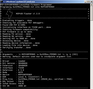

Programmed OutOfBox_FR5969.

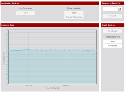

Run /GUI/OutOfBox_FR5969_GUI on Windows. Connected to COM5 and looked at the live temperature data.
Activated "FRAM log mode". Green LED flashes briefly every 5s.

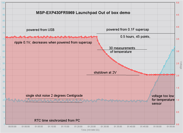

One could store in FRAM ca 8 hours of temperature and voltage as long as supercap lasts.
Set jumpers "use supercap" and "charge" the supercap. Should remove V+ jumper from J13.
Supplied from a from supercap LED stops blinking after a few minutes but the logging continues.
Exit from logger by pressing button 2 or reset button.

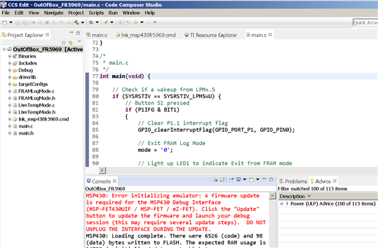

Downloaded Energia 13. Opened blink example. Tried to upload. Message came that need to run update /programmer
"A firmware update is required for the MSP430 Debug Interface (MSP-FET430UIF / MSP-FET / eZ-FET). "
"device inicialization failed"
It is a bug that several other roadtesters already encountered. Solution will be to wait until Energia 13+ appears.

Pressed New project/Energia .  A project template came up and it could be compiled and  debuged (press the green bug icon)
Needs to update driver too. Update successful.
"MSP430: Loading complete. There were 506 (code) and 0 (data) bytes written to FLASH. The expected RAM usage is 20 (uninitialized data + stack) bytes."
Pasted Blink example from Energia, pressed "Debug" and after compilation MSP430 launchpad LED started blinking. So far OK.

I opened and compiled OutOfBox example.
tools/import ccs projects/outOfBox_FR5969
It worked by blinking red/green LEDs and the green LED blinks shorty every 5s  when activated FRAM storage from GUI demo o a PC.

Left the board runing OOB demo overnight powered from the supercap to see how long time it lasts. In the morning saw that data saving continued for 1/2 hour.
Possible time extension would be by disabling thermometer and LED flashing.
