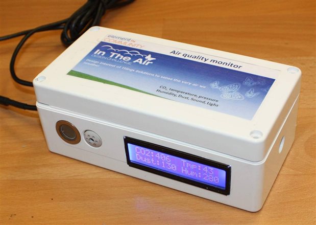

I bought three CO2 sensors and Arduino-nanos and gave one to high school students and one to  my collegue Ilja Feschenko who designed a great-looking electrochemical CO2 sensor box using SolidWorks and printed it on a 3D printer. There is USB output to a PC and a line with color LEDs. Simple LED indication is particulary suitable for checking air at home during nights. It is powered from external 9V supply and contains a miniature fan. After initial try Ilja saw that readings are temperatuire dependent and he actively stabilized the CO2 sensor temperature by an external heater transistor and a thermistor in Arduino PID loop. This decreased the temperature dependence, but there is still humidity dependence and warm-up time of hours. Ilja callibrated CO2 sensor against a commercial infrared photoaccoustic CO2 monitor.  High school students managed to make a setup on a breadboard, learned programming and averaging ADC reradings, but did not have time to make a box.
After digging into more scintific articles we understood that not only the air temperature but also air pressure has to be taken into account requirng to put more sensors into the box. And that is the story of the multi-sensor box described below that I built for In-the-Air-Challenge.
Here is a presentation of air quality sensor  to measure air quality in school classes. There are up to 30 students in a classroom. In winter windows are kept closed and air quickly deteriorates  without forced-air heat-recovery ventilation. Carbon dioxide (CO2) in air is responsible for tiredness. Dust and smog is a problem in large cities.  In winter might be too cold and in summer too hot and moist to feel comfortable. Knowing air quality might help teacher to optimize window opening.  Besides that it will play a large educational role teaching young people about sensors,  programming microcontrollers and Internet of Things.
Idea was inspired by a sensor cube: http://habrahabr.ru/post/243669/ where all possible sensors were mounted in a plastic cube.  Probably  not all the existing sensors are needed at the same time. Commercial sensors exist: https://www.netatmo.com/. Here are the sensors that I decided to use:

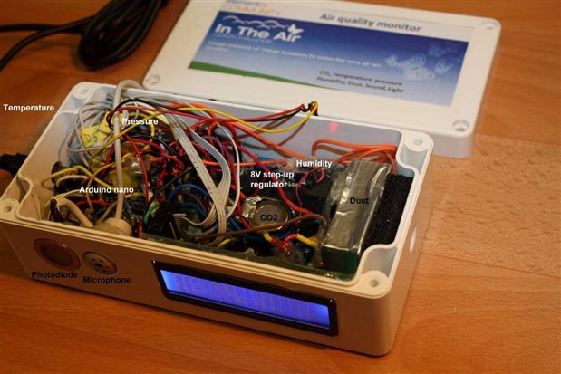

Arduino micro pro is used because of small occupied space and availability of libraries for sensors and LCD.  Arduino is the microcontroller that school students who attend robotics club are familiar with. So they can modify the program.  Two-line LCD display displays sequentially 8 values from sensors. Values  from Arduino serial port are read on a PC by Processing 2.2.1 that is plotting data saving to disk and and uploading to the Internet of Things. Code is attached. I used a ready made library for IoT server Xively. Feed will not be available all the time: https://xively.com/feeds/1192364524
I tried bluetooth connection to a PC but it was unreliable and lost connection after several days. Idea was to run Processing scetch on an Android phone or tablet, but the sketch that run OK on a PC did not run on Android as Bluetooth serial port was named differently.

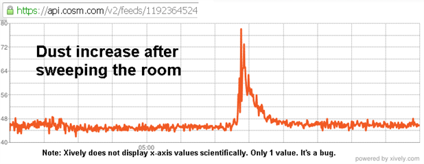

Dust  sensor
Dust sensor GP2Y1010AU0F made by Sharp is sensitive to average dust level not for counting individual particles. There is a significant output offset from photodiode amplifier noise and from light scattered from the black sidewalls. This background has to be subtracted. Dust sensor feels when the room is swept  and the broom brings dust to air. It is very sensitive to (cigarette) smoke.
Sensor output voltage depends on supply voltage. In the datasheet calibration curve was showed for 5V sensor supply. When supplied from 3.3V the output signal is smaller. Internal IR LED is driven in pulsed mode 100 short pulses per second. This allows to have more light in IR LED emission peak as scattering effect is relatively weak.

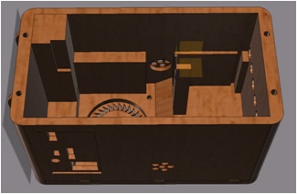

Fan glued behind the sensor box is sucking air through the sensor. It is a 25x25 mm low noise (18 dB) fan operated from 5V with 100 Ohm resistor in series to reduce speed.  Visible dust layer accumulated on the propeller blades in a week.

I have placed CO2 sensor board inside the air quality box after the dust sensor fan.
CO2 sensor needs 6V for the internal heater. It is more practical to to use a  step-up regulator to raise USB voltage than an external power supply. I wanted to  use some of the multitude of inductor coils donated by Wurth Elektronik for the Air Challenge, but found on Ebay cheap step-up modules. So I step up the USB voltage to 8V that is sent to CO2 sensor board. 8V is supplied also to the 3.3V LDO. CO2 sensor draws relatively much current and USB voltage drops to 4.2V not enough for 3.3V LDO.

Complications
Tight packaging of many sensors in one box caused some contradictions.
  • It gets warm inside because CO2 sensor heats up to +40…+50C. So the room temperature sensor is placed outside the box at the end of 10 cm cable.
  • Humidity value is influenced by elevated temperature inside the  box.  So the humidity sensor is placed directly after the fan where air has not heated up yet.
  • Pressure sensor BMP180 might feel increased pressure inside the box by the fan. To cope with that the fan rotates at slow speed.
  • Fan produces some noise that is felt by the microphone that measures sound level. Fan is mounted on the dust sensor and that is glued not directly to the wall but via a rubber pad to reduce vibration transfer.

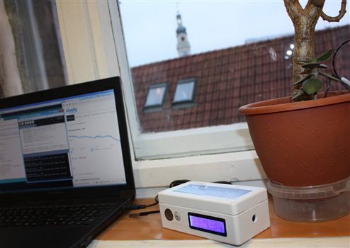

Tests at school class

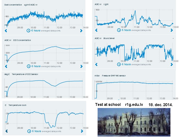

I gave the sensor box to a student who took it to Riga 1st Gimnasium  to measure air quality in the class. Test at school was tried for 3 days and only the last day was successfull. First day there was no Wi-Fi connectivity. Second day GSM-USB Internet adapter was used to bring notebook to the Internet, but Processing script stopped working as there COM port settings had changed. Below is the picture of the sensor readings at school. Live: https://xively.com/feeds/1192364524
Measurement was started on Dec. 18 at 8 am. CO2 sensor needed 1-hour warm up.
CO2 levels changed dramatically during the middle of the day when window was open. But this change was mainly due to decreased temperature.
Note that plotted is not the CO2 concentration, but voltage in ADC units. This voltage decreases with increasing CO2.
One could see slightly elevated dust level, but not too much.
Box was placed on the window aisle near heaters and room temperature reading was elevated.
After the school day around 2:30 pm the student took the sensor and notebook home. So there are no values for the time when noone was in the class.

RESULTS:
1) There were some interesting results analysing the sensor data, for example CO2 increase during every lesson and dust from floor sweeping after the classes.
2) A webcam would greatly simplify the analysis showing the number of people in the class and state of the windows,  but webcam is not legal to use without permission from authorities.
3) Wi-Fi at school was problematic to arrange as one needed to register MAC address by the webadmin. GSM module would be best to use.
4) At school students were not allowed to leave electronics running during the night. So background data could not be collected.
5) Electrochemical CO2 module needs too much warm-up time. NDIR CO2 sensor described in the following blogposts is more accurate and has only few minutes of warm up time.
