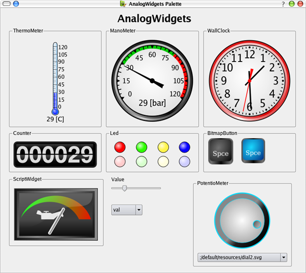

Additionally, I chose to use the AnalogWidgets library for Qt (nice gauges design in my opinion).
This library provides some nice gauges that can easily be customized for my project. I will use it for both apps (clients and BBB dashboard).
