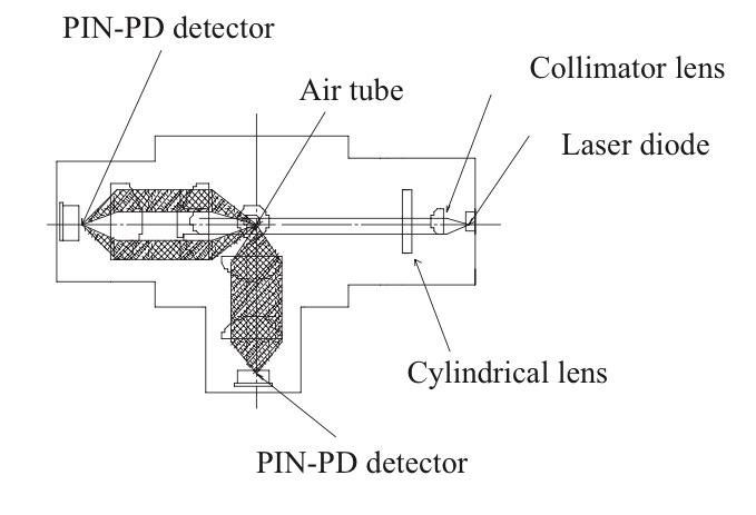

1) Homemade pollen sensor
As my plan is to detect pollen, I did some research and discovered a paper on pollen sensing that proposes an idea which seems feasible (Shigeto Kawashima et al. - An algorithm and a device for counting airborne pollen automatically using laser optics).
This task would require very much hard work and could easily turn out to be a failure but I can still try. Some optics would be required - hopefully I will be able to obtain all the necessary parts to build the prototype.
Figure 2. Pollen sensor
Authors propose that red laser should be used but I think that maybe green or yellow laser would be more appropriate because pollen colour is usually the same (i.e. it reflects green or yellow). I bought the green (532nm) one locally to be used for this purpose.
In order to observe the photodiode sensor signals an oscilloscope is required so I decided to order one that fits in the budget (PicoScope 2204A). It arrived in just two days(!) and as I last used the oscilloscope ~15 years ago (at university) I spend some time testing it – It turned out it’s like riding a bike image

  • michaelwylie
    michaelwylie over 12 years ago in reply to tomaja
    You are correct. You could use them for the luminescence part though.
  • tomaja
    tomaja over 12 years ago
    Well I already ordered a pair of these glasses, so I will give it a shot image
  • tomaja
    tomaja over 12 years ago in reply to michaelwylie
    Yes, I already did that and edited my previous comment.
    They don't provide the curve but give the frequency range from 190nm to 540nm. Unfortunately, these would filter out the green colour too, not just the blue image
  • michaelwylie
    You'd need to know what the filter curve for the glasses look like, but it's a really good/inexpensive idea.
  • tomaja
    tomaja over 12 years ago in reply to DAB
    Thanks, DAB!
    I will try the simpler PD way for this. (I never used an imaging sensor, I'm not sure how easy is that for me - I'm not a pro)
    Dragan
