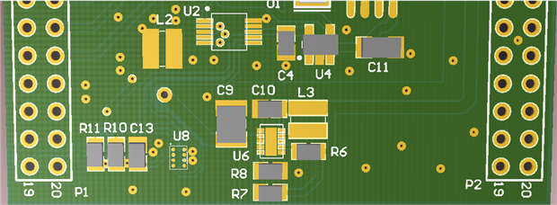

This leaves me with not much to talk about for this week's blog post. How about some more about PCB design, and then a little about reading? Figure 1 shows a zoomed portion of my Booster Pack design. U8, down at the bottom left, is a TINY humidity and temperature sensor. I was surprised that no one who read my last post challenged me on the layout decision for that chip.

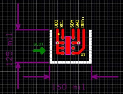

When placing the sensor directly on my main PCB like this, it should be thermally isolated from the rest of the board. Figure 2 shows how TI suggests doing this in the HDC1000 datasheet. The white portions are slots drilled in the PCB, and this reduces the thermal mass. What's that all about? Well, for our purposes, a low thermal mass allows the sensor to respond quickly to temperature fluctuations. What I'm really getting at here, is that I didn't include any slots in my PCB design.
Figure 2: Isolating the HDC1000 and reducing its thermal mass.
Why, oh why would I have done this? I've got three reasons:
  1. I don't want to measure the ambient air temperature. I want to know the board temperature. The microcontroller might have a temperature sensor built-in, but that's on the launchpad not the Booster Pack.
  2. Slotted holes are always a pain when getting your PCB fabricated. I'm not sure why this is an issue, but every time I've gotten quotes for PCBs the manufacturers were more concerned with how many slotted holes the board contained and not the overall hole count.
  3. I don't even have a good reason to have this chip included, I just thought it would be fun to put it on the board.

    I've wondered if reading comprehension is something that is slowly learned, or if it's one of those "Aha" moments. Maybe it's a combination of both. Do you know why the manufacturers seem more concerned with slotted holes than anything else?

  • ipv1
    ipv1 over 11 years ago
    Well I didn't cut the slots either and again for the basic reason that I shoved it so far away that nothing with interfere. No copper pours except for the ground one and the sensor is on the edge so it does its job right.
    image Hope it works.
    shabaz over 11 years ago
    Hi Michael,
    Looking forward to seeing the board in action : ) I imagine you can't wait either.
    Also, excellent points!! Most of the time the first read of the datasheet doesn't get absorbed. I always have to go back and re-read at least once more.
    Also, often component manufacturers are nice and happy to review designs, so this helps too.
