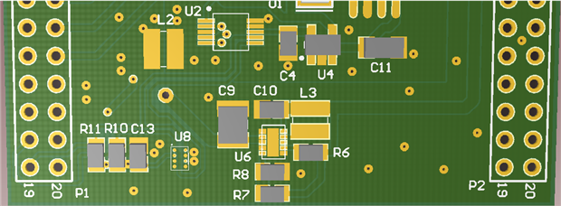

This leaves me with not much to talk about for this week's blog post. How about some more about PCB design, and then a little about reading? Figure 1 shows a zoomed portion of my Booster Pack design. U8, down at the bottom left, is a TINY humidity and temperature sensor. I was surprised that no one who read my last post challenged me on the layout decision for that chip.
Figure 1: Zoomed picture of my Booster Pack design.
When placing the sensor directly on my main PCB like this, it should be thermally isolated from the rest of the board. Figure 2 shows how TI suggests doing this in the HDC1000 datasheet. The white portions are slots drilled in the PCB, and this reduces the thermal mass. What's that all about? Well, for our purposes, a low thermal mass allows the sensor to respond quickly to temperature fluctuations. What I'm really getting at here, is that I didn't include any slots in my PCB design.
Figure 2: Isolating the HDC1000 and reducing its thermal mass.
Why, oh why would I have done this? I've got three reasons:
  1. I don't want to measure the ambient air temperature. I want to know the board temperature. The microcontroller might have a temperature sensor built-in, but that's on the launchpad not the Booster Pack.
  2. Slotted holes are always a pain when getting your PCB fabricated. I'm not sure why this is an issue, but every time I've gotten quotes for PCBs the manufacturers were more concerned with how many slotted holes the board contained and not the overall hole count.
  3. I don't even have a good reason to have this chip included, I just thought it would be fun to put it on the board.
