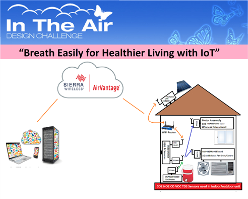

“Breath Easily for Healthier Living with IoT”
Introduction:
My application for “In The Air Design Challenge” include designing of  IoT based system using Beaglebone Black and CC3200 Launchpad as main processing part for sensing and controlling Air quality and water quality for Breath Easily and Healthier Living by means of controlling Air-condition, Ventilators and Exhaust Fan using real time Air Quality data of indoor and outdoor environment. The system also monitors TDS level of drinking water in home.
All the real time data will be available online from Airvantage M2M cloud by mihini running on Beaglebone black.
The entire control part is integrated with OpenHAB framework running on Beaglebone black, so automatic as well as manual control of Air-condition, Exhaust Fan and Ventilators can be done easily from openHAB application or Airvantage application running on SmartPhone/PC hence only one android application is capable to handle all home automation need.

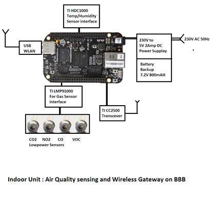

Indoor unit:
Indoor unit mainly consist of Beaglebone Black with Air and Water quality sensors. It also control Ventilators and Air-condition automatically. Important features of indoor unit are,

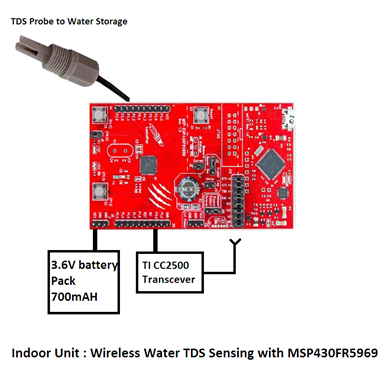

     1. It Senses indoor Air Quality using CO, CO2, NO2, VOC (Volatile Organic Compounds), temperature and Humidity Sensor and water Quality using TDS sensor. Sensors are selected by considering low power requirement and accuracy of measurement, so system works with accurate quantitative data rather than just qualitative data and it will be low power too.
     2. Work as Gateway for Airvantage M2M cloud and OpenHAB for access real time data and control the entire system online.
     3. Control of Ventilators, Exhaust fan and Air-condition (Cooler/Heater/Dryer) to control Humidity and Air Quality inside home. Also give audio visual alarm when Air Quality can’t be improved after all necessary controls at their extreme position.
     4. Indoor unit is powered from utility with backup battery.

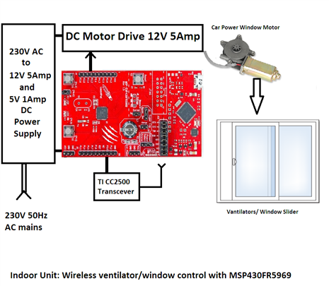

     5. MSP430FR5969 will be used with CC2500 transceiver for control purpose at Ventilators, Exhaust fan and Air-condition.
     6. To control Aircondition I will need reverse engineering of my Airconditions remote interface to make it work with MSP430FR5969.
Blockdiagram of indoor unit modules as follows,

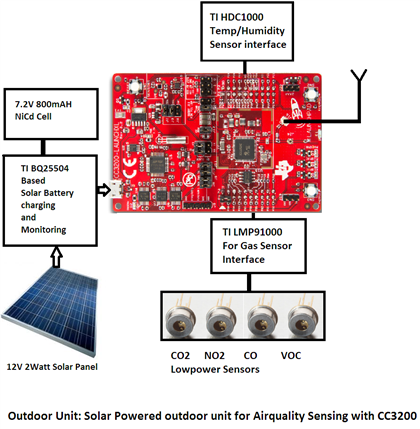

Outdoor unit will be designed around CC3200 Launchpad with Air Quality Sensors. Main features of outdoor unit are,
     1. It Senses outdoor Air Quality using CO, CO2, NO2, VOC, temperature and Humidity and Sensors.
     2. Here also Sensors are selected by considering low power requirement and accuracy of measurement, so system works with accurate quantitative data rather than just qualitative data and it will be low power too.
     3. Outdoor unit will be powered by solar panel of 12V/2W.
     4. 6 cells (7.2V/800mAH) NiCd battery used for backup power.
     5. Solar battery charger is designed around TI Solar charger portfolio and Wurth Electronik’s Low profile high current SMD inductors.
     6. It is connected to indoor unit with Wi-Fi for sensor data transfer.
     7. Because this unit works on battery/solar panel, CC3200 programming is done with efficient use of Low power modes.
Detail blockdiagram of outdoor unit is as follows...
Working of Entire System:
Beaglebone black and CC3200 in connected wireless to WLAN router.
WLAN router provides interface to the AirVantage M2M cloud via internet and also provide control facility via smartphone application.
Indoor Sensors and outdoor sensors data collected at Beaglebone. The difference in data is used to control window slider and/or AC or exchaust fan to maintain air quality inside home.
By all the controlling means if system is not able to maintain airquality inside home under threshold condition, then alarm triggers automatically and it will also shown via twitter on smartphone.
All the sensor data are available on AirVantage M2M cloud to easily access via smartphone or PC application.

     3. TDS Probe : for measuring TDS level in drinking water. (1Pcs. Approx-$25)

     5. Car power window motor: for linear control of ventilators/window. I will get these motors easily from car scraps vendor in local market. (3Pcs. Approx 60$)

    mcb1 over 12 years ago +2
    Ravi It's a well thought out process and detailed plan on how you intend to achieve it, but unless I'm missing something in your introduction you haven't said WHAT it is your system will be aiming to do…
    jw0752 over 12 years ago +1
    Hi Ravi, I enjoyed your presentation and I like your idea to measure indoor and outdoor conditions. I will look forward to seeing your interface between the car window motors and the windows and ventilators…
